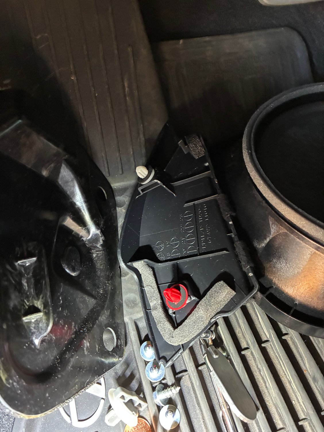

I just got done replacing my outside door handle. You really need 2 people to do this job. I only had me doing the job. I asked my wife to help but she kept messing around so I had to find a way to do it myself. I had the usually failure where it will not retract. I ordered it from Yoshiparts in Japan. It took about 7 days. I paid less than $470.75 for everything including shipping.

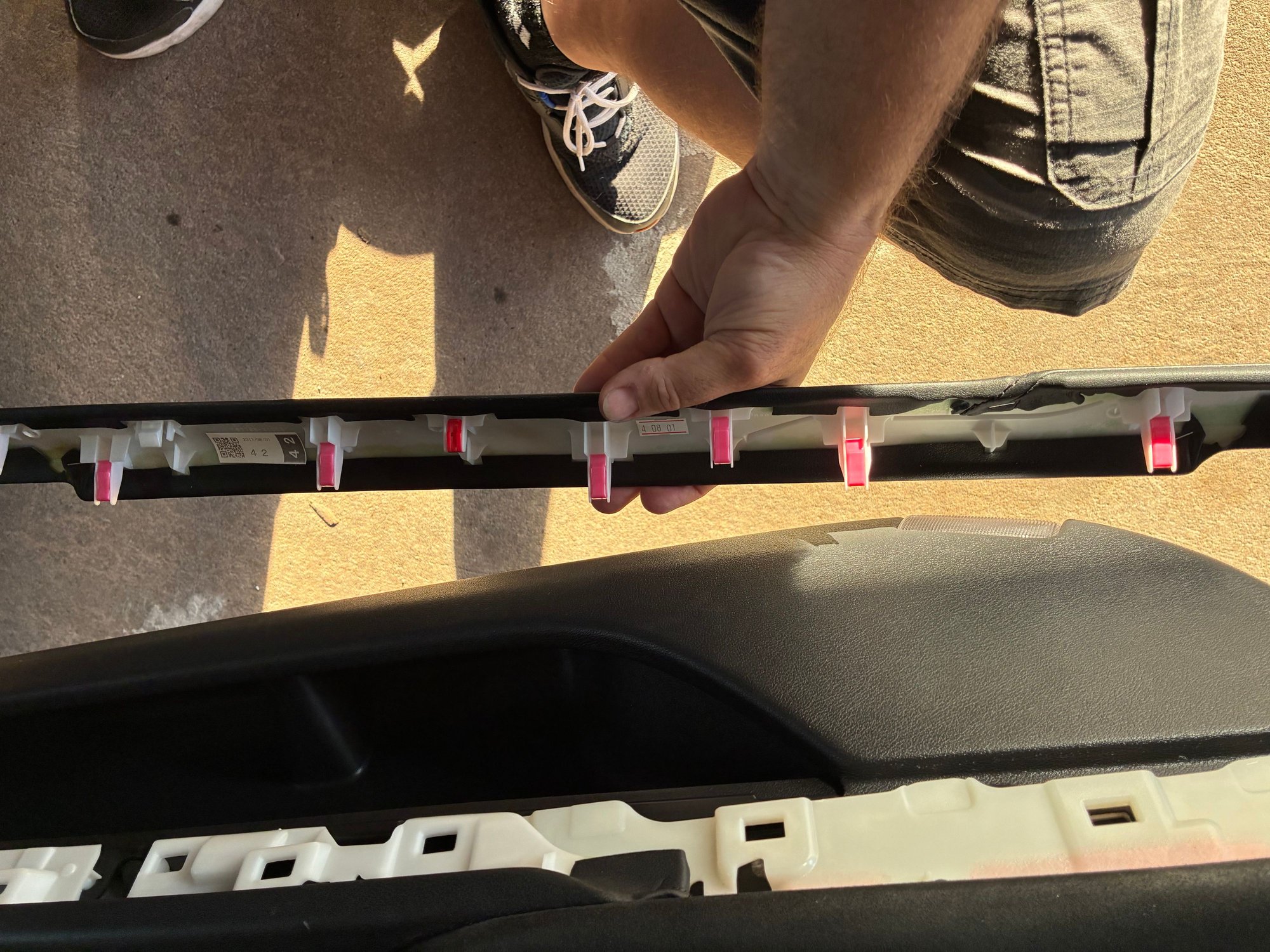

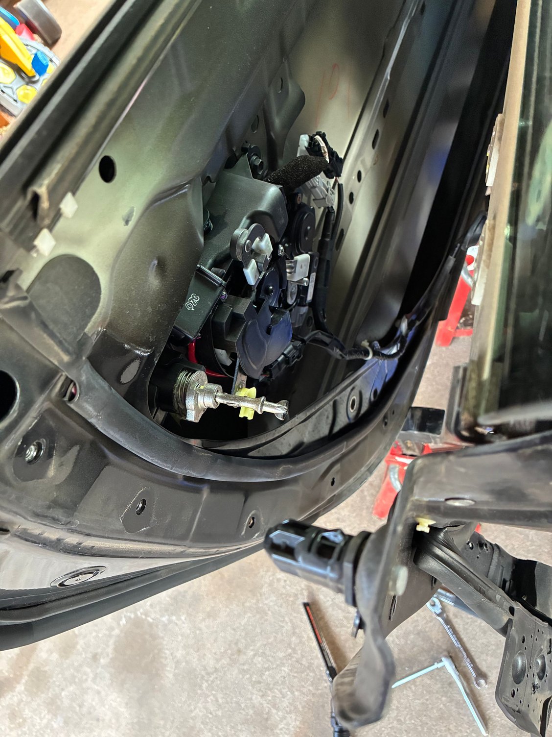

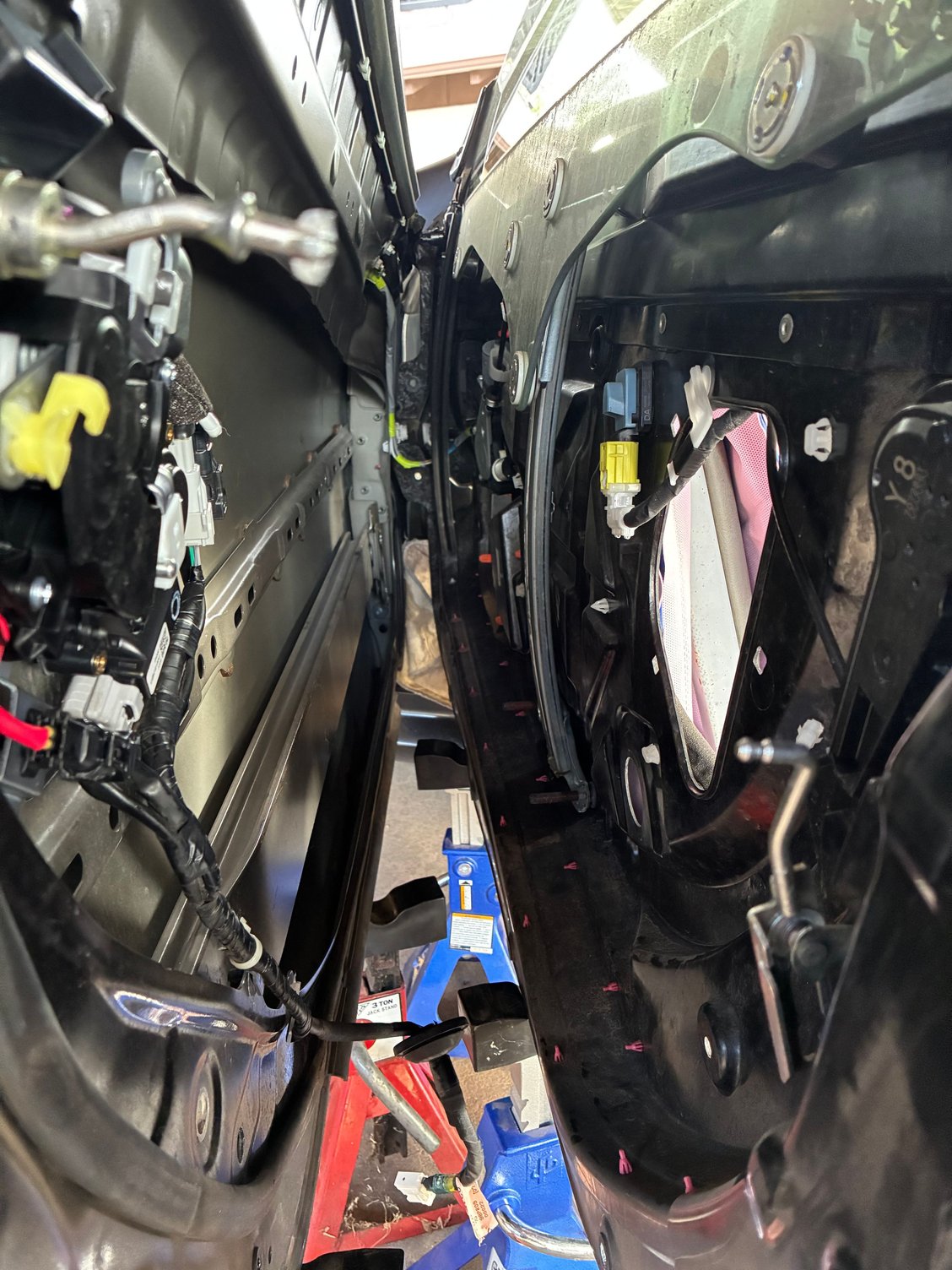

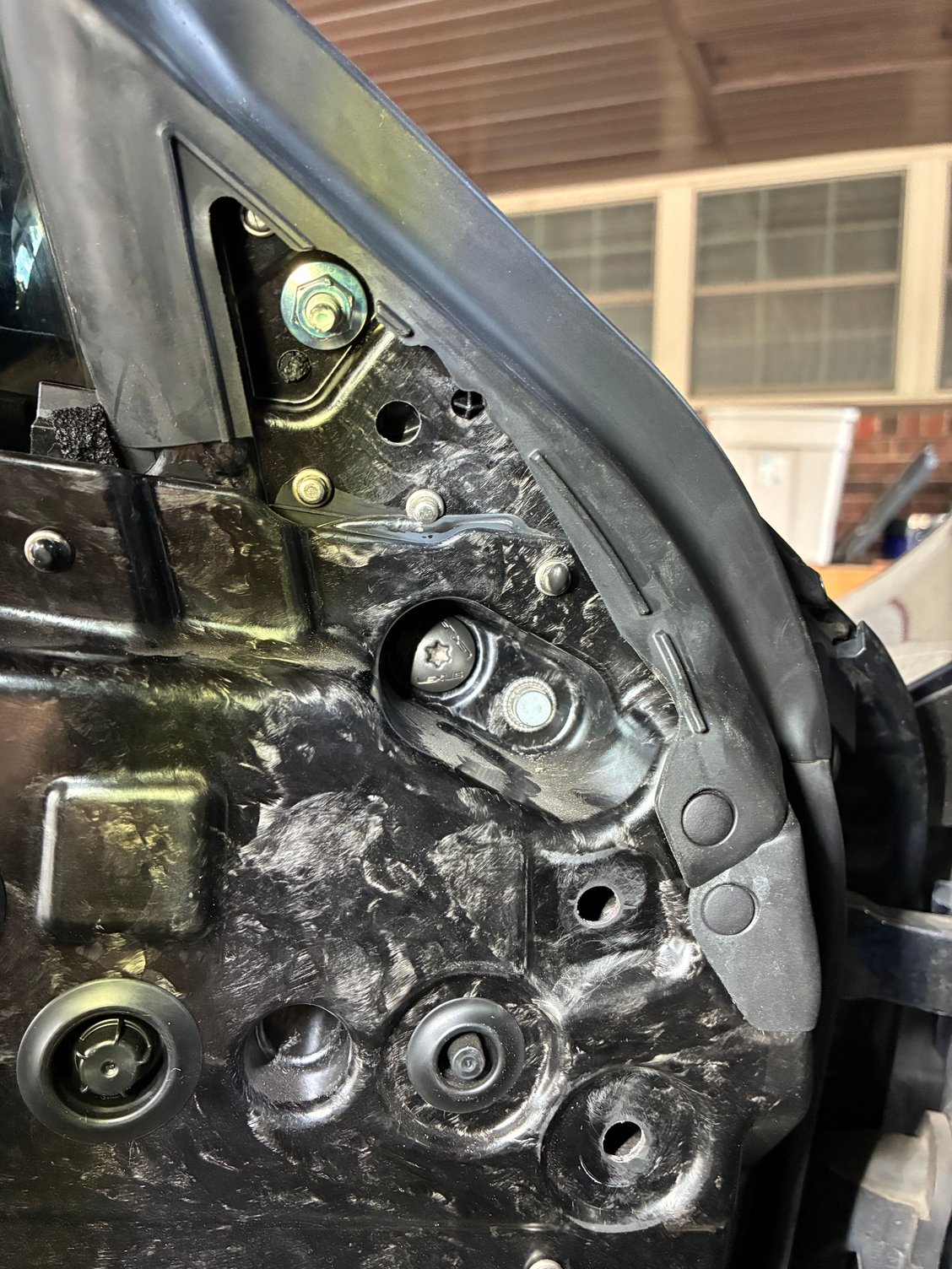

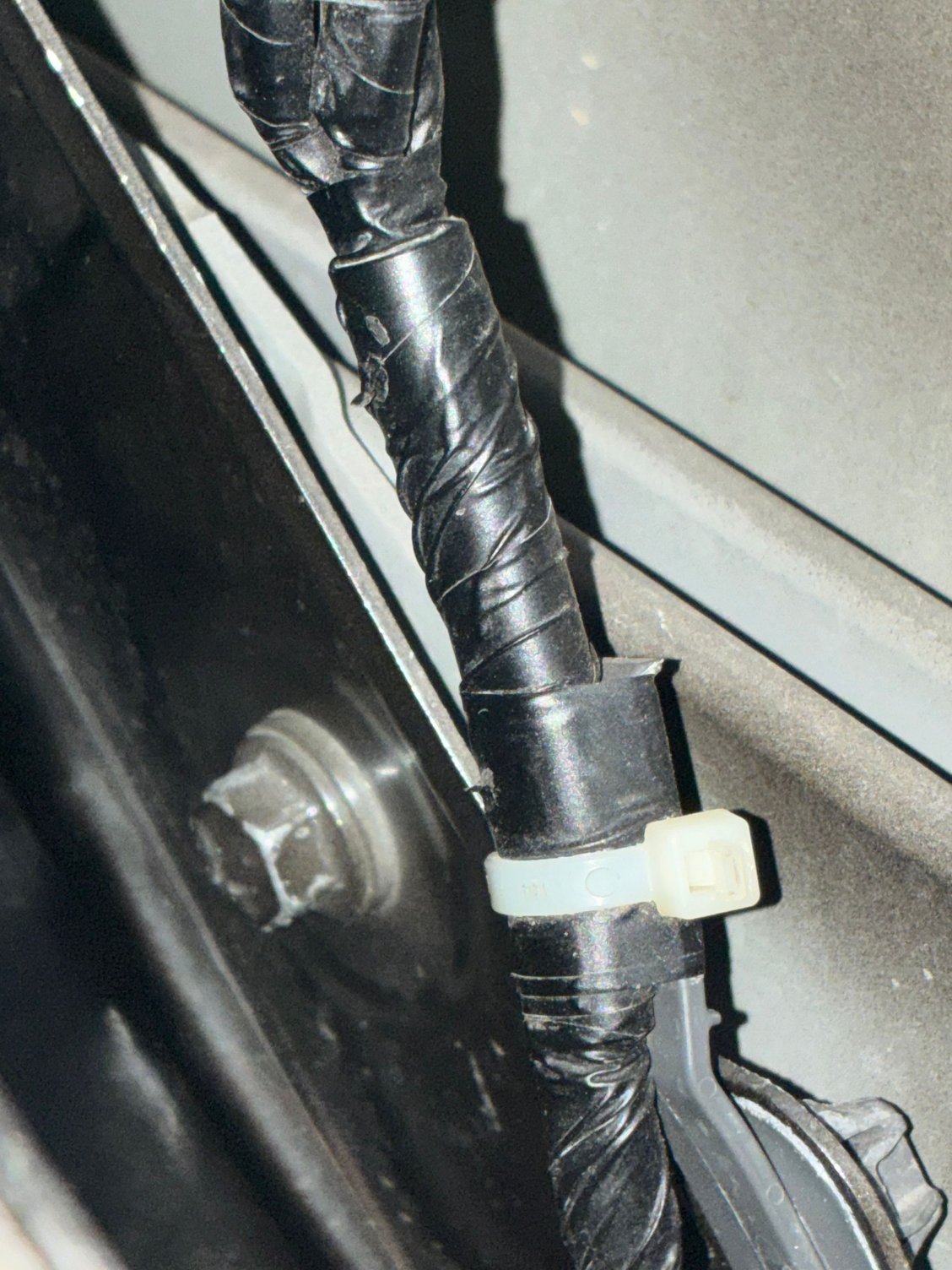

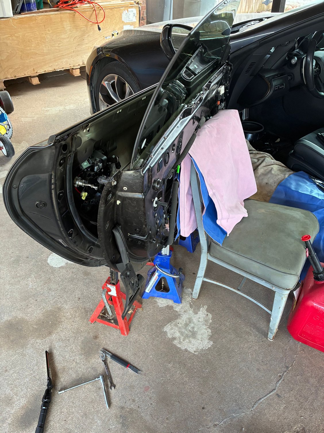

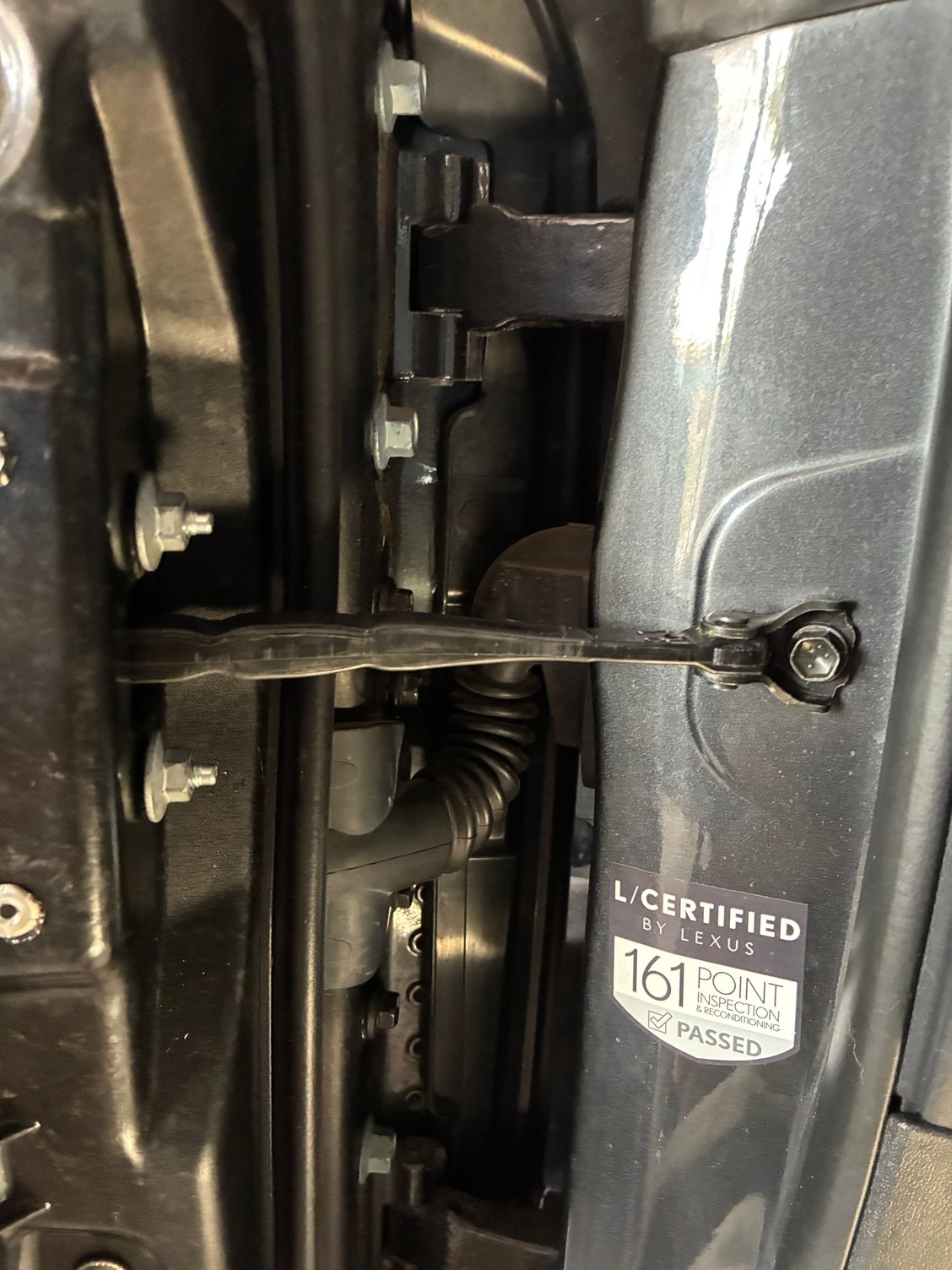

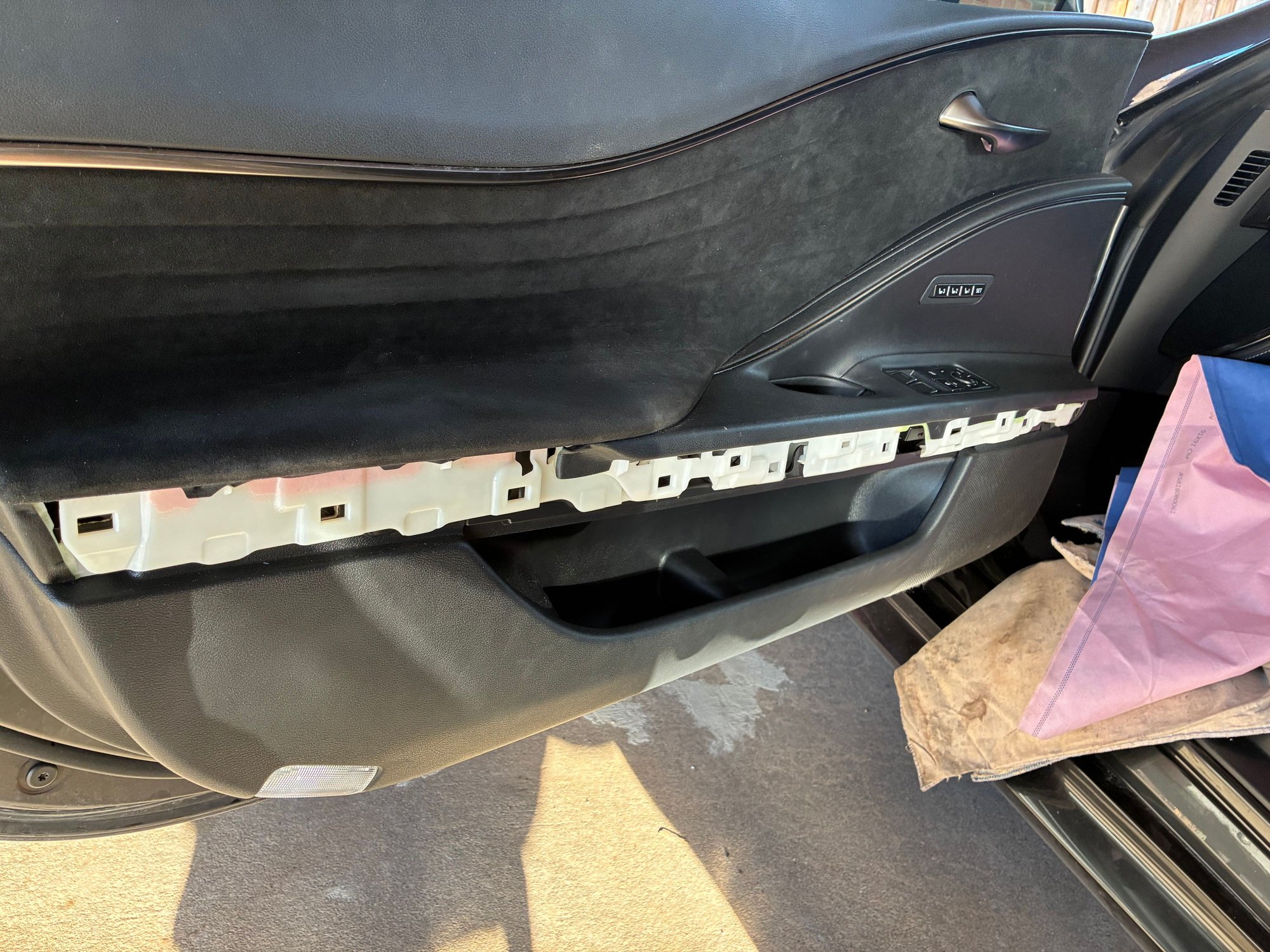

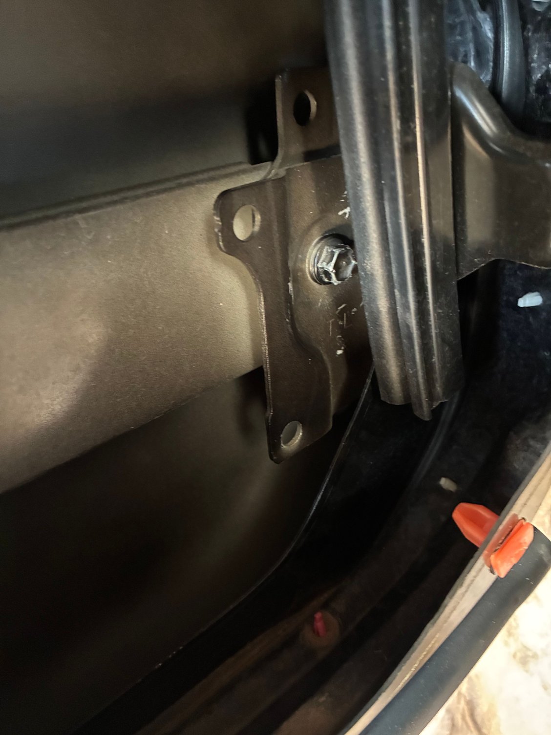

start by removing trim cover on door panel by just starting at outside edge with plastic trim tool popping clips. 2 Phillips screws under that then pull from bottom to pop out all clips and lift up. Pull it up and out and disconnect cable for inside door handle and 1 electrical plug. Remove speaker and the cover with 3 clips. That gives you access to 2 12mm nuts down low. Remove at least 11 or 12 T 30 torx screws. 2 are hidden at top behind rubber top left and right. Remove rubber door seal at top left and inside mirror cover by removing 2 clips on plastic cover then remove rubber seal covering torx screw. Front edge of door has 4 10 mm screws. Need to remove door stop by removing 2 10 mm nuts and 1 10 mm bolt. You really have to pay attention since now door will open all the way and will damage paint if opened too far. I have jack stands with rubber covers on them that worked perfectly for supporting door from moving and a second pair to support carbon panel with window. There are 2 big black clips at the top edge of panel that supports panel after removing all screws and bolts. Just grab top edge and pull out. There is a wire harness with a rubber grommet that needs to be disconnected. I supported panel with 2 more jack stands with plastic covers on bottom and a heavy metal chair with padding to keep it supported so I could remove door handle. 4 10mm screws removed handle. There are 4 wire harnesses connected to door handle. Remember to swap out the lock cylinder by removing 1 T30 torx screws. Pull handle out and it comes out there. One last thing is when carbon cover comes loose there is a short linkage that has to be disconnected by rotating plastic lock and pulling linkage loose.
