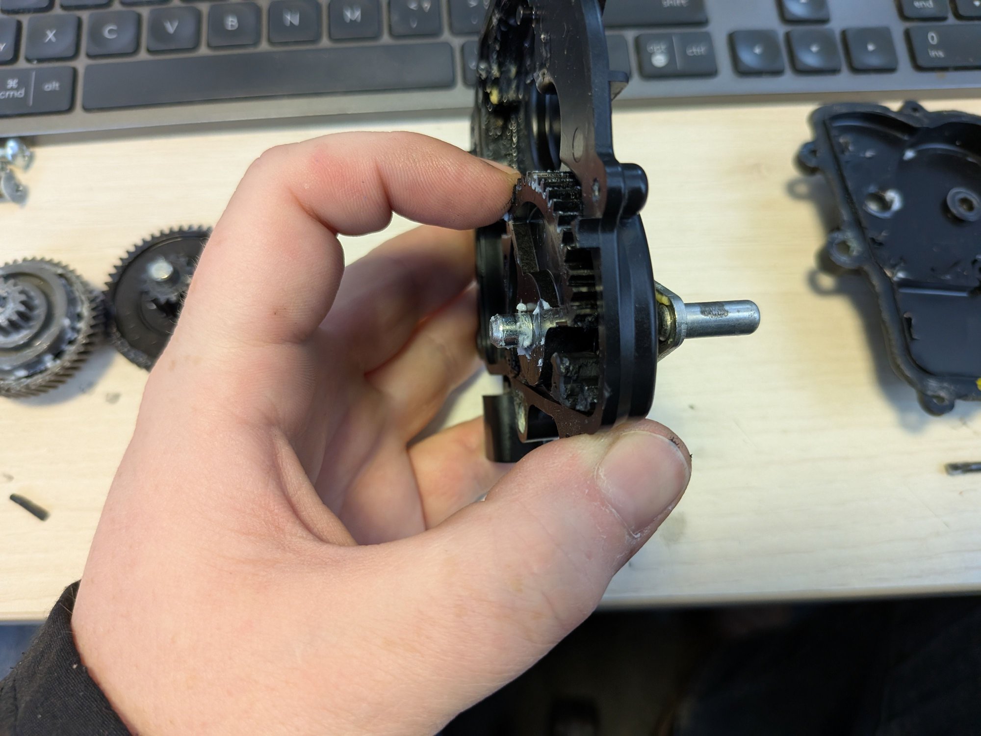

After replacing my own handle yesterday, I can assure that this recess is only for manufacturing purpose (injection molding - there are some restrictions on thickness for certain plastics to work well).
The main issue here is that only this gear cannot be easily removed as it has the lever on the opposite side (the one that moves the handle). Tried pliers to push the rod out, pushing, shouting, negotiating and even small hammer... nope, it does no go anywhere.. other 2 wheel could be re-made, the middle cog is easy, the first gray one that links to motor is a two (and a half) piece, but still reproducible.
This quarter wheel is the main problem - if hardly removable, how would we replace it
And for the door disassembly - two man job for sure. No need to balance the inner carbon core on a chair - in front there is a white clip on the outer side that when undone enables the whole harness to be pushed through some holes and out so you can move the carbon core with window out and lay flat somewhere. I'll try to "annotate" some of my pictures and post it here later

Are all years door handle units the same? I have a 2020 and the passenger, right is starting to make an aaaa sound at the end of recessing in, not when it actually locks? It sounds fine going in but just at the end when it stops do I hear the noise. I assume it’s going bad. No noise going out or unlocking thu? As I have read through this thread I’m hoping I can buy any year and swap out my current color handle to new part?
1. are all handle mechanism the same?
2 if so are all able to swap out the handle color?
Thank you for any information.

Technically there are two product numbers (if you strip the color code), I currently have newer code handle instead of older in my car. So handles should be the same through years.
And yes, you can swap the colored handle by unclipping rubber gasket around the handle, removing the hinge pin and unscrewing the weight with inner light (because rerouting it's cable takes more effort). Then in reverse with original colored handle. 😉

One possibility (not having the gear in front of me) would be to heat that metal pin and push it out. When the new 3D part is designed you design it small enough to heat press into the new part. I've done this on pump motor impellas and it works flawlessly. Can't say for sure without seeing it.
Not sure if it will work after that... there is a significant force applied through the shaft.
you can see the whole mechanism on following pictures, tried to describe what is involved... and the main thing will be spring loaded metal "thing" that connects this shaft via off-center pin, a hook for the interior handle and at the bottom a hole for the exterior lever "pin". Overall the pin to cog wheel "connection" has to be really strong (hoped for some worm screw or something there but no luck this time)
in RED - a lever that is spring loaded and moves the handle in and out (via the cutout at the bottom of image)
in GREEN - a lever rotated by the shaft
shaft going through the quarter wheel moving the handle in/out
