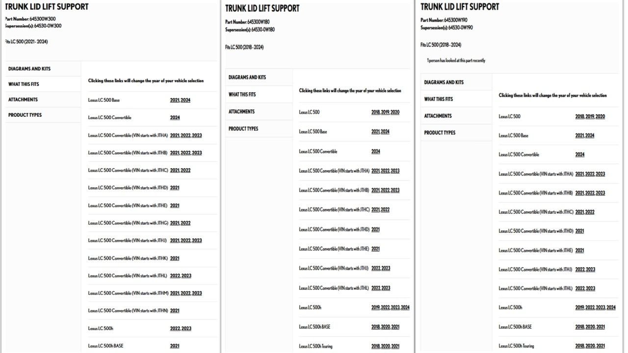

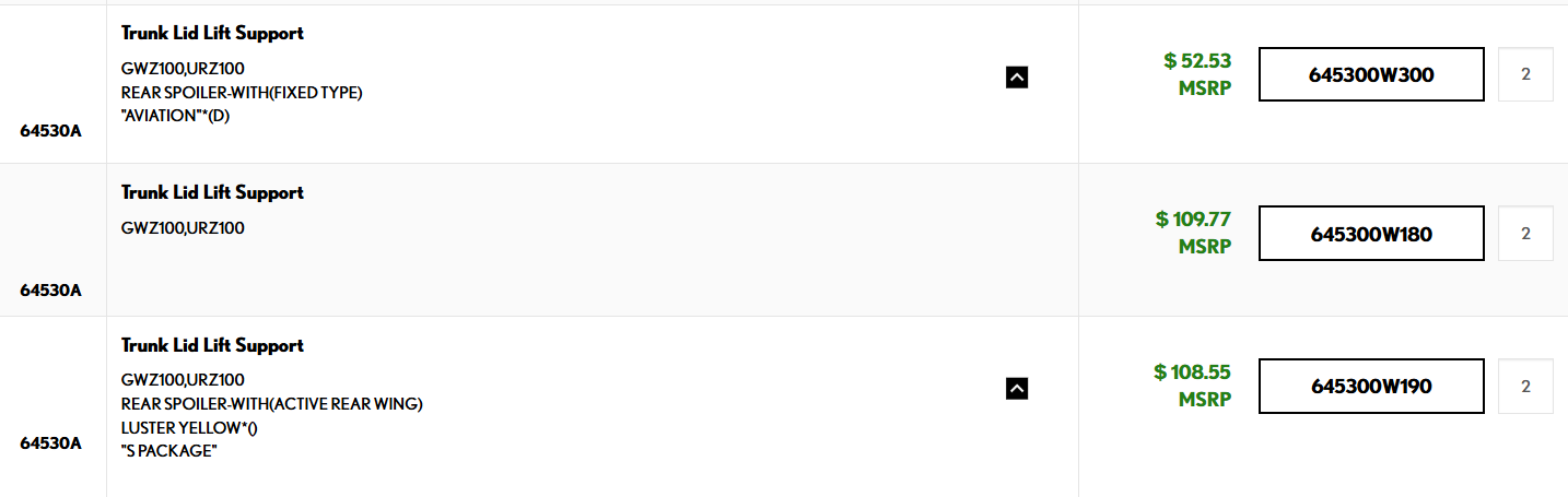

Looks like there are three different OEM parts for the LC trunk struts.
https://parts.lexus.com/a/Lexus__LC-...4-7C98A49A13D2

Just spitballing here, but the three choices appear to compensate for the different trunk weights due to different equipment. Fixed spoiler vs active spoiler vs no wing. So, the length is probably the same, but the resistance is different.
Lou

Was my guess too. The optional Active Rear Wing adds quite a bit of weight to the trunk. My vehicle does not have that option. But still, Stabilus who is the OEM for Lexus indicates on its packaging that they can not be compressed by hand. I can compress them by hand on my wood topped workbench; however, maintaining the compression and installing them over the studs is a no go.
