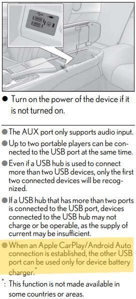

I can only get the bottom USB port to work for my wireless carplay adapter.

Originally Posted by tecman
Well there's my answer. Extremely annoying that I have to turn off Bluetooth to get the USB drive to play my music.

To get wireless Android Auto I use an adapter that plugs into the USB port in the center console. My phone connects to that adapter via Bluetooth. While my phone is connected to that adapter, the Lexus head unit doesn't allow me to play music from a USB Drive that I have loaded with music that is connected to the secondary USB port in the center console. The only way I can get the USB Drive to show up on the Lexus screen is by disconnecting from Android Auto.

Yep, only one of the two ports can be used for data transfer at a time. If one is used, the other one only delivers power out, no data transfer.

@Enzo954 not that it matters as far as the maps issue or playing a usb stick while AA is connected but it is my understanding the android auto only uses bluetooth initially and briefly, to connect to the adapter. from there it establishes a WIFI connection which is much faster. bluetooth is inadequate (too slow) to communicate the screen updates. you can see the adapter's wifi network name on your phone.
as someone mentioned, the car can only handle one usb data stream at a time, so with the adapter connected and active (which means data is pouring in for the screen updates even if you're not playing music), the car can't stream music off a usb stick as well. this isn't that surprising, and not saying there's anything wrong with doing it but i bet the percentage of owners who play music off a usb stick is close to zero.
so if you want to play music off the usb stick you'll have to disengage wireless android auto entirely (not just music). one way to do that without constantly plugging and unplugging would be a usb 'switch' cable like this: Cable Matters USB 3.0 Extension...
