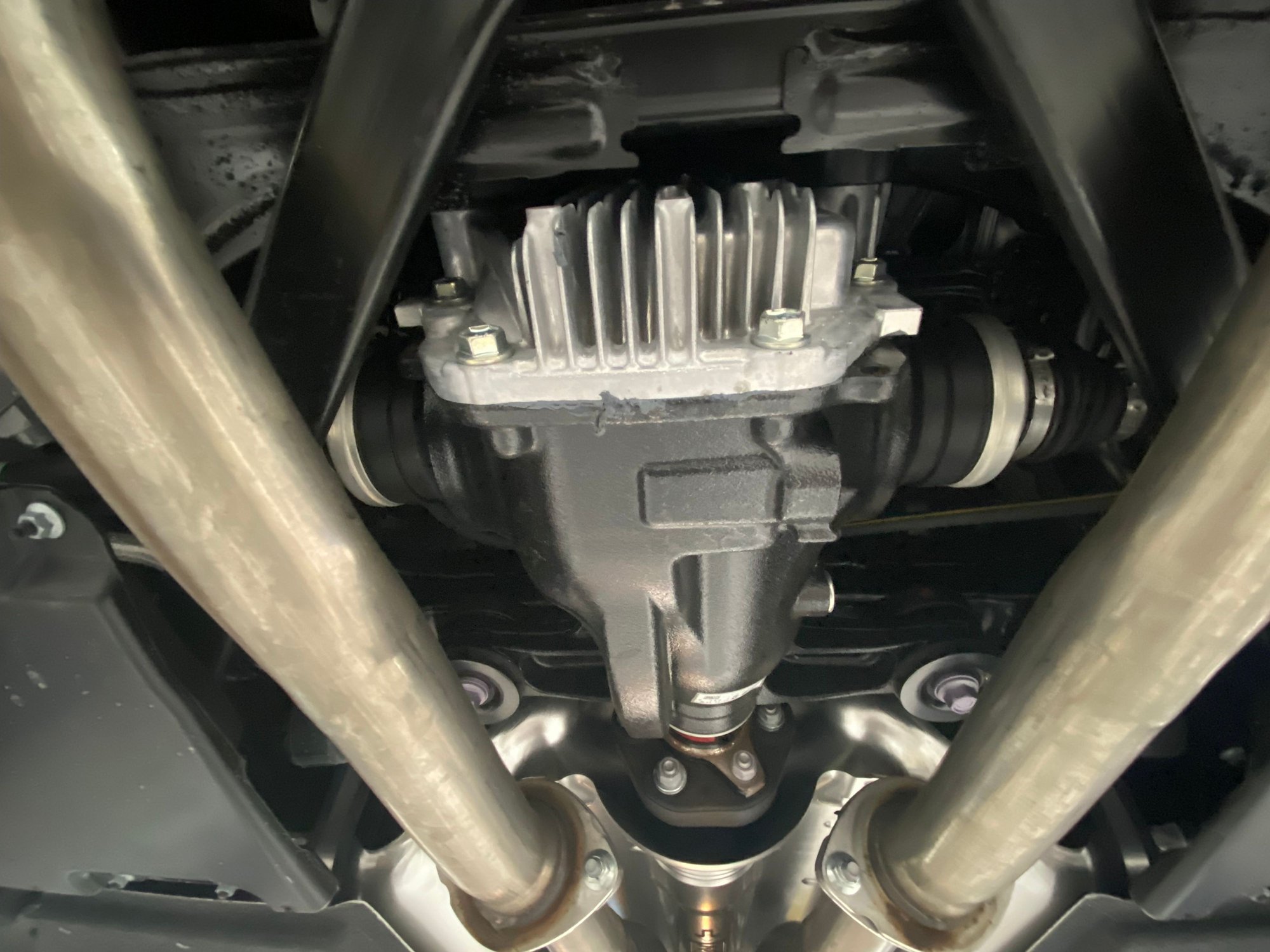

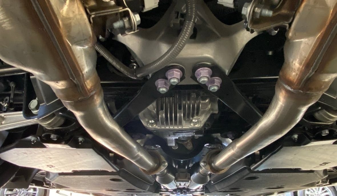

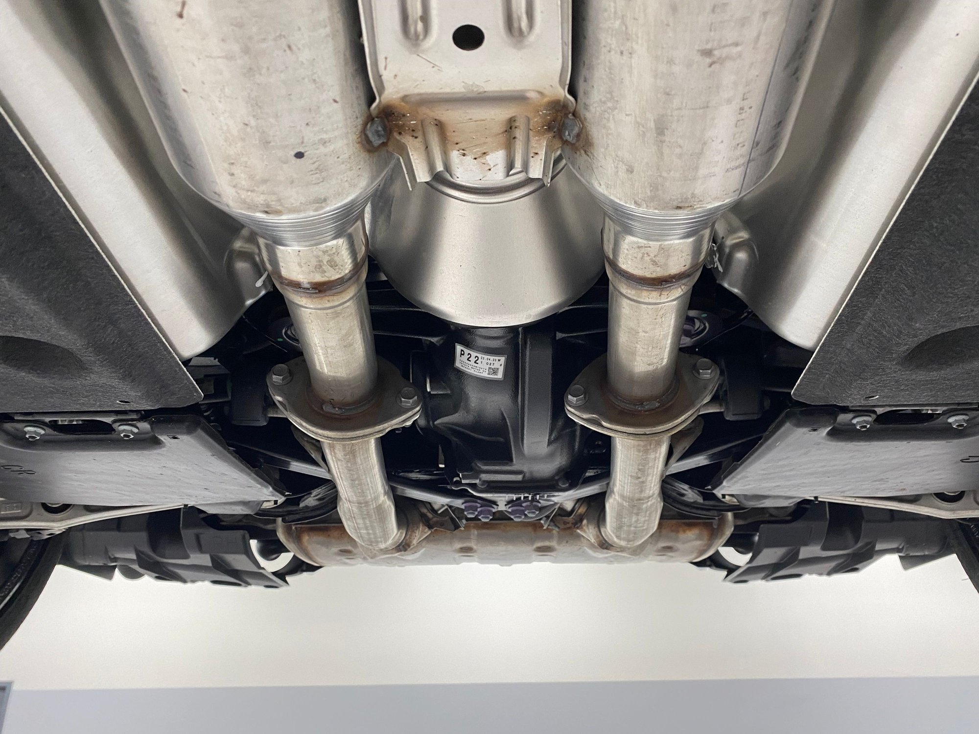

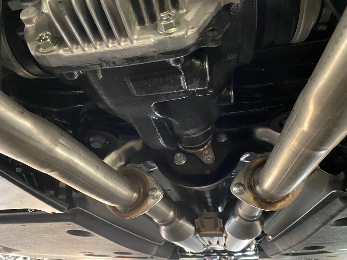

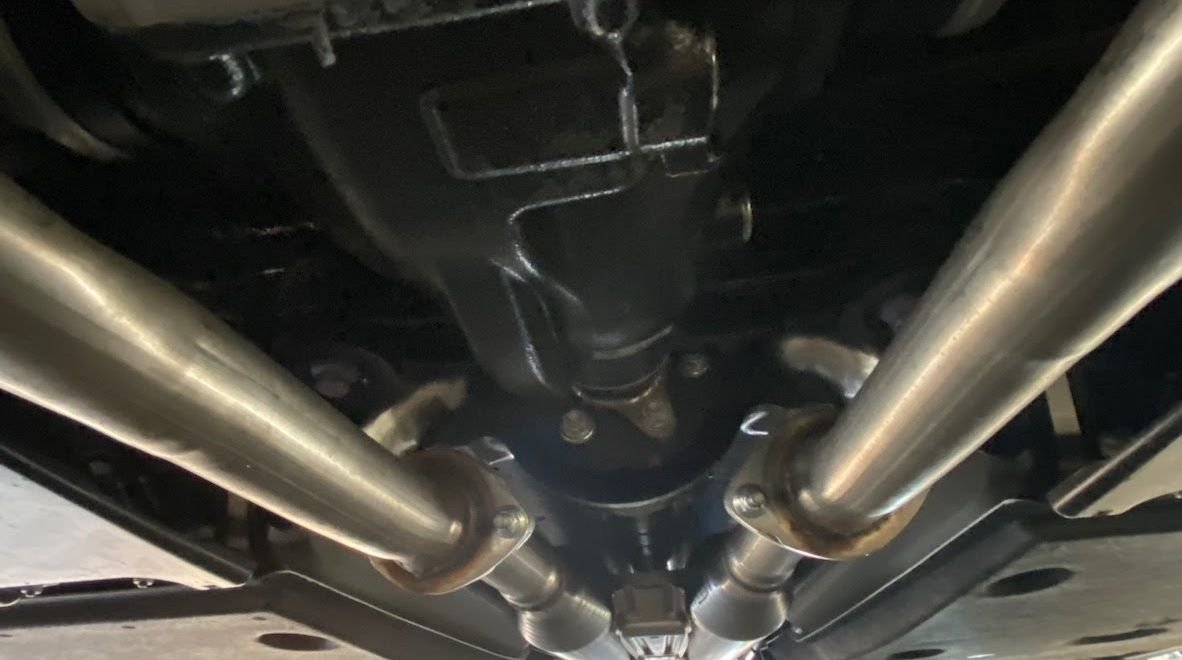

I am trying to determine what Differential comes in a 2022 Inspiration Series Convertible.
I have tried calling and emailing Lexus, no response.
I called a dealer, they said they would check and get back to me.. nothing!
Can anyone smarter than me determine if this Differential has the LSD option or not by looking at these photos?
Thanks!
See below:

You'll want to find part numbers that look like these:
Originally Posted by QwkSC
Do you have the torsen diff currently?
There seems to be two part numbers for the LC500h diff assembly
  • 41110-11030: 3.357 ratio - $2600
  • 41110-11050: 3.357 ratio - $4000
And there's two part numbers for the LC500
  • 41110-11020: 2.937 ratio - $2600
  • 41110-11040: 2.937 ratio with LSD - $4000
I can't find any info indicating if 41110-11050 has an LSD or not. But, based on the price I would assume the one you ordered has an LSD.

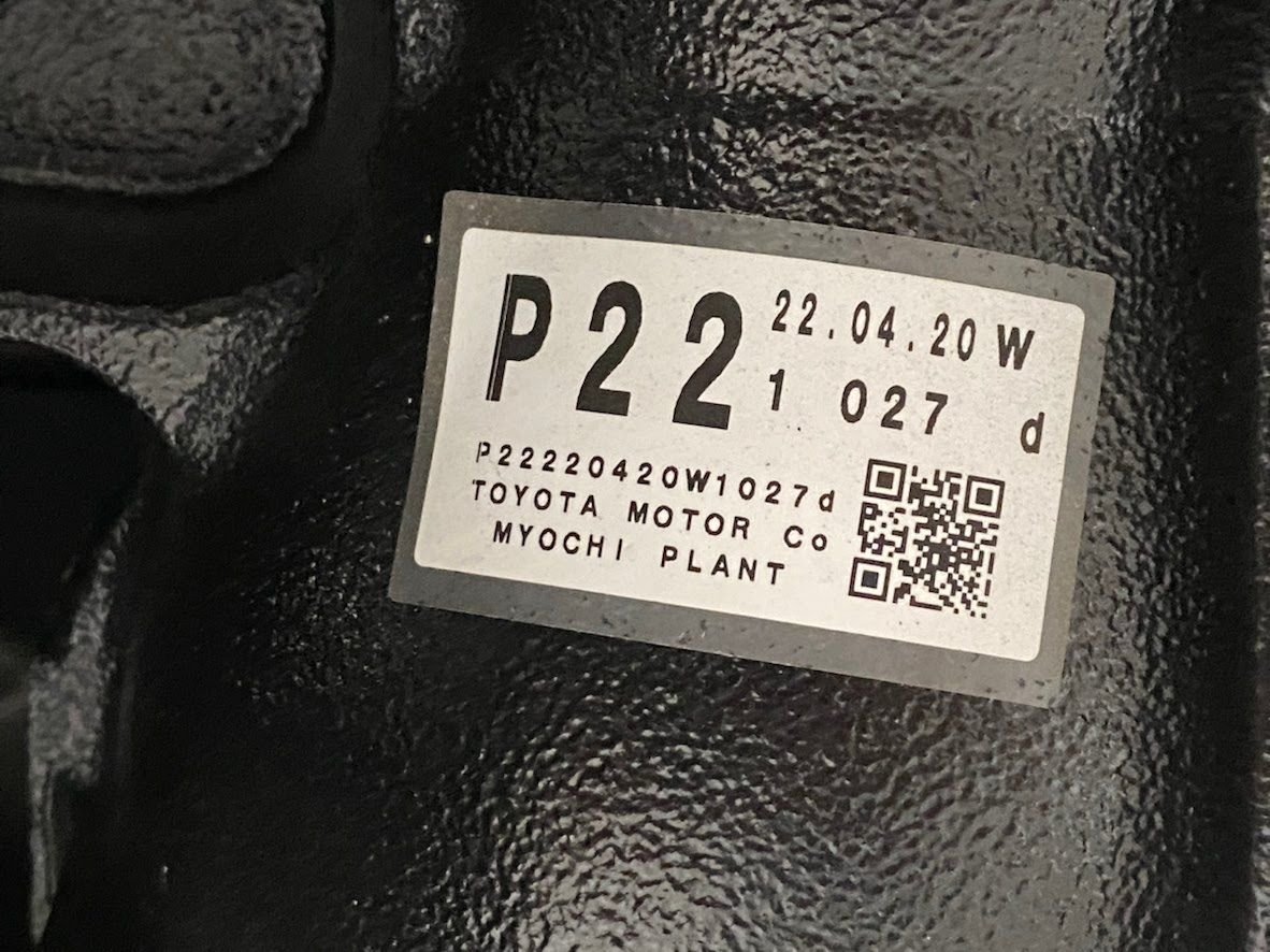

Thanks Lou, I can't see any other number unfortunately.
