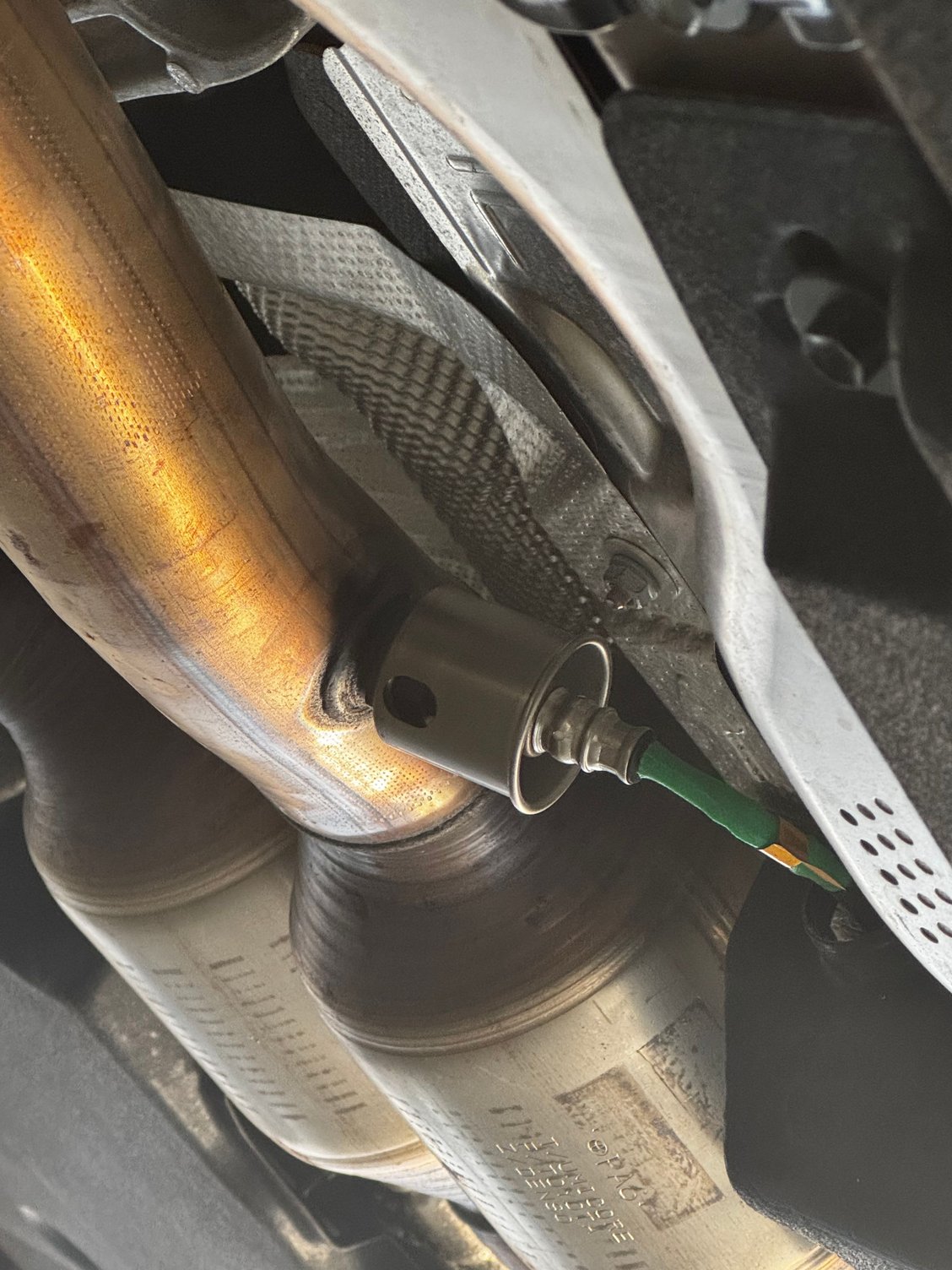

Hoping someone can chime in. I am trying to remove the shielded 02 sensor to put on my Armytrix Exhaust.
One sensor came off easy with wrench. The 2nd one has this shield around it.
The short socket does not work well with it. I found this loaner set with a deeper groove and wanted to confirm that was the correct set to get it off. I know it’s 22mm.

It looks there is 3 different size sockets, so I would assume you’ll be able to get one of them in there,

Unplug the O2 harness and use a deep O2 socket. I'm not sure if the one in the pictures will work that great, but Autozone sells one that I use that is fine.

Expensive (but all Snap-On tools are); https://shop.snapon.com/product/Sens...r-Socket/S6176

Oreillys and others have "loaner" tools for NC.
