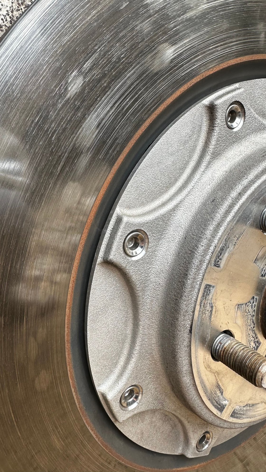

Here's a photo of the hotspotting on the rotors. My tire guy confirmed, that turning or resurfacing the rotors wouldn't solve that he and said I'll probably have to replace rotors each time if I stay with steel rotors :/

What exactly causes hot spotting? My former Lexus service manager said it was caused by moisture trapped between rotor and brake pad, and allowed to stay there for a period of time. This thread suggests it’s caused by aggressive, spirited driving, leading to rotor overheating. Can anyone help? I have an LS460 and a new-to-me LC500. The LS has gone through any number of rotors — and it is never driven hard.

My last 3 cars — Audi A8, Audi A6 4.2, and LS460 — all suffered from front rotor deterioration in the form of hot-spotting. None of these was driven hard. Anyway, thanks for the link; very informative.

Those rotors look turn-able to me. Really all you need to do is turn them down to remove those pad deposits.
I own a 2022 Kia Stinger 3.3L GT2, a very good car, and some on the forums are complaining about identical front brake problems.
Long story short, replacing the front pads with aftermarket pads such as EBC Yellow, completely cures the problem. Best-case scenario is to turn the rotors before installing the new pads, and, always burnish the pads to the rotors.
The root of the problem is the USA pad compound, and are virtually dustless. Replacing the USA pads with OEM Euro-spec ones, and no more problems, but more dust.
I've never had a problem, but I burnished mine immediately after buying the car brand new.
Agree on the EBC yellows. Dust - yes. Performance - yes. Amazing bite and almost no fade.

I would really turn those rotors. doesn't even have a lip at the edge. also it probably didn't even hit the miniman thickness.
