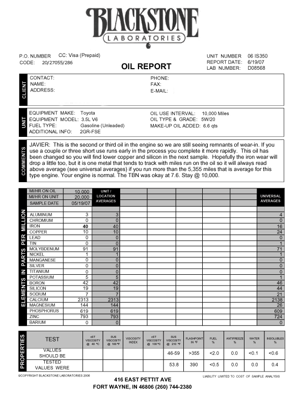

Post your UOA here!!! This way we can compare analyses and determine the optimum OCI. For the benefit of all, please post the following:
  • Your full UOA... DUH.
  • Your oil change interval (OCI)
  • Your oil used (brand & weight)
Of course, please post any relevant notes and/or detail. I'll lead off:
OCI: 10,000 miles oil, 5,000 filter change & top off
Oil used: Mobil1 5W-20
I decided a while back that I would use an oil change interval of 10,000 miles, only changing the filter and topping off the oil every 5,000. I changed my oil last month at 20,000 miles, and sent a sample to Blackstone Labs for analysis. Bottom line: my oil was in fantastic shape and I am definitely staying at a 10,000 mile OCI...

Wow! Anyone else doing this??? Sure would be nice to not give Lexus 50 bucks every 5k!

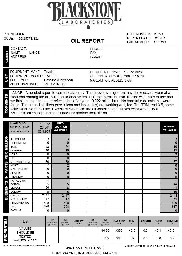

OCI: 10,022 miles oil, 5,000 filter change & top off
(identical to yours Javy!)
Interesting. Your iron at 40 seems very high. Mine was 24 on a 10k mile change, and 16 at my 5k filter change. I'm hoping to see a trend with the next few oil changes. I just (literally) changed my oil tonight at 30,641 miles (I was on a road trip from Atlanta to NYC last weekend, and I had no plan to change my oil midway through the trip.) I took another sample this time, it will be my third for analysis, and I expect to have numbers similar (but hopefully better) to yours.
We really should start a dedicated thread to oil analysis results and OCI based on testing. FWIW, I've been running 10k miles oil changes for a very long time in just about everything I own based on mass spectrometry results I got from my Supra running Red Line oil.

OCI: 10,000 miles
Oil Used: Mobil 1 5w-20
Second results from the filter change at 25,022 miles:
More to come, sample going to Blackstone tomorrow with 10,641 miles on it since last full change. It should help me develop a trend line for iron wear.

So Lance, this last UOA that you posted - did you change your oil at 5,000 or 10,000 miles? I noticed the Blackstone report read 5,030, but you posted 10,000.
Javier
Old Jun 19, 2007 | 10:31 PM
lobuxracer's Avatar
lobuxracer
Tech Resource
Joined: Jul 2006
Posts: 23,083
Likes: 4,752
From: Georgia
I changed the filter only and sampled the oil from the filter change.
