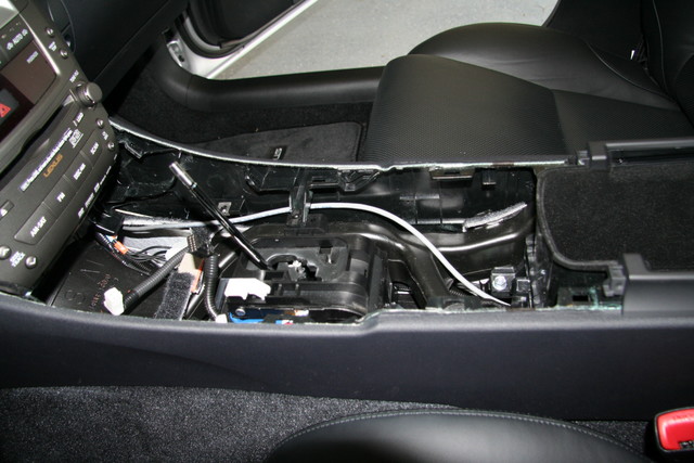

I ran the iPod wire under the center console. I found an openning cover inside the center console. You need to pry the cover up and trim a small 1/4 inch hole so the iPod wire can come through.
iPod wire under the shifter cover.
This is how it looks when it's done.
