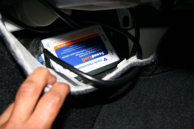

I just installed the VAISTECH SLI iPOD intergration on my IS350 with NAV/ML this afternoon.
WOW, it took me 15 minutes to get it running and may be another 45 minutes to make everything looks good and put it back together.
Sound quality is a top notch with CD sound.
Control of the iPOD from the steering wheel, touch screen, file name, file detail, and folder list. You name it this unit can easily do it..
I used to hooked up my iPOD to AUX input from Lexus and alway find myself fighting with the unit while I'm driving( dangerous of course). But with Vaistech SLI, I can easily control the iPod with my eyes still on the road.
Oh, the Vaistech will eliminated the famous " I AGREE" buttom from the Nav screen if you wait about 5 seconds... .That's a cool feature for them to throw in with the package.
The package came in with very nice and professional. I'm impress about the quality of the wireharness( not one of those mom & pop company at all)
You still need to remove the nav/head unit to get to the wire harness of the car. This the link of how to remove the head unit in courtersy of Tim817

I found a small openning hole on the right hand side of the dash and be able to feed the wire through it. That's where I mounted the SLI( under the left side of the glove box).
Attached Thumbnails Vaistech SLI iPOD intergration installed(pics)-vais-2.jpg
