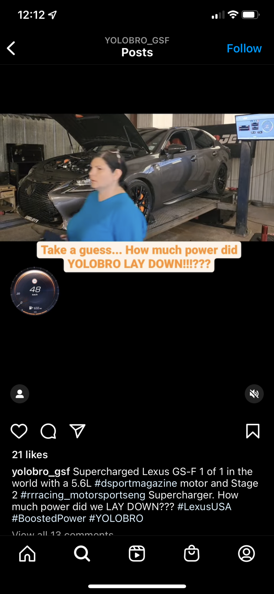

Oh I think that’s the engine I mentioned above. I thought Novel had built it. Someone on Instagram bought that engine and it’s in a GSF now.
It is the same. He is now stage 2 RR supercharger and didn’t state numbers other than less than 700 whp. I never saw NA HP numbers.

I believe you're correct! I saw this on ebay while I was cruising options for my F - it wasn't a plug and play for my application and it was very $$$$.
In anycase, I think they floated around 525HP for the publication, but I too never saw WHP numbers or N/A Dyno numbers.
