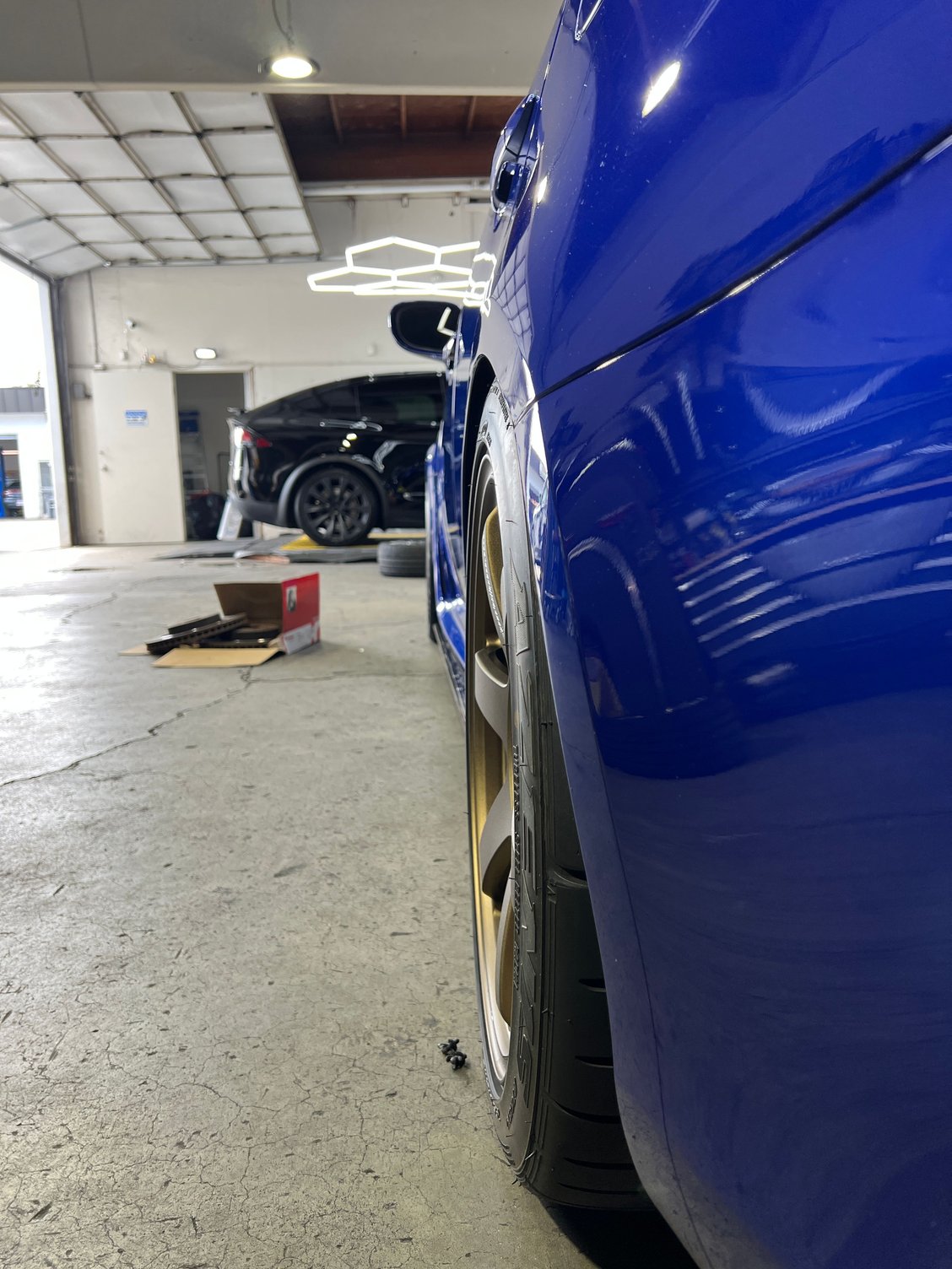

here is a quick pic. Not in my possession yet. It’s a friend car and he’s ready in week or so. Gives me time to sell the Subaru WRX STi. Just took off the volk wheels and have it stored and will be looking for new tires soon. Super excited to drive Lexus soon
