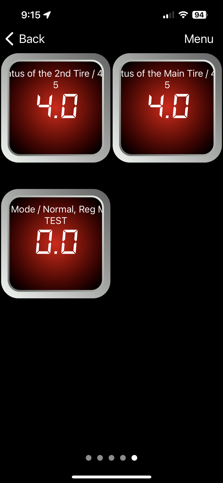

I have OBDLink MX+ with OBDLink app monitoring a 2011 Lexus IS350C. It doesn’t show 4 separate tire pressures. It shows 2 gauges I don’t know how to read:
- Status of the 2nd tire / 4 or 5 = 4.0
- Status of the Main tire / 4 or 5 = 4.0
- Status of the Mode / Normal, Reg M, Reg 2nd or TEST = 0.0

Correct. OBD Fusion doesn't give you tire pressures. I assume status is something like ON, OFF, ERROR for those codes.
That's why I went with the aftermarket gauge.

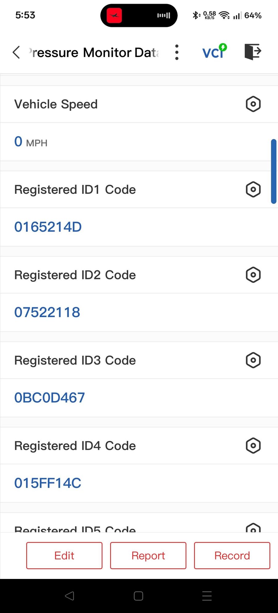

Here you can see an example of my 2nd set IDs
Using aftermarket sensors & my cheap TopDon Bluetooth scan tool. (Does not write/program sensor IDs)
Reply 1
