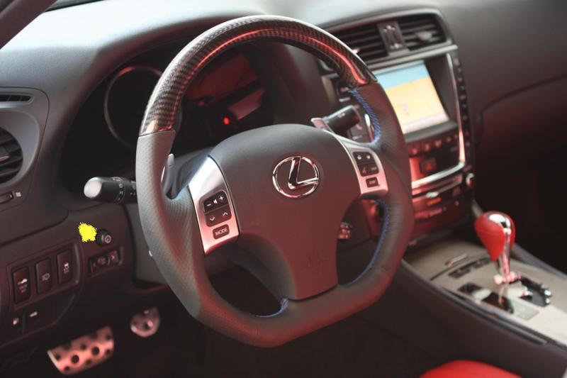

So my car failed MOT last time I was in the UK due to not having the rear fog light indicator working.
So long story short I have to retrofit a small bulb that will switch on whenever the rear fog lights are switched on.
The wiring is already done but I just need to find the right bulb so I can solder them onto the existing wires.
I plan to put it somewhere on the dash (highlighted below in Yellow).
Does anyone know what type of bulb I can get that'll work for this purpose or more importantly where I can buy it

no I want to retrofit a single bulb into the dash console (yellow smudge in the first pic).
My cluster does not have a bulb for the rear fog light to come on, and I'd rather just retrofit a small bulb outside instead of opening up the cluster.
