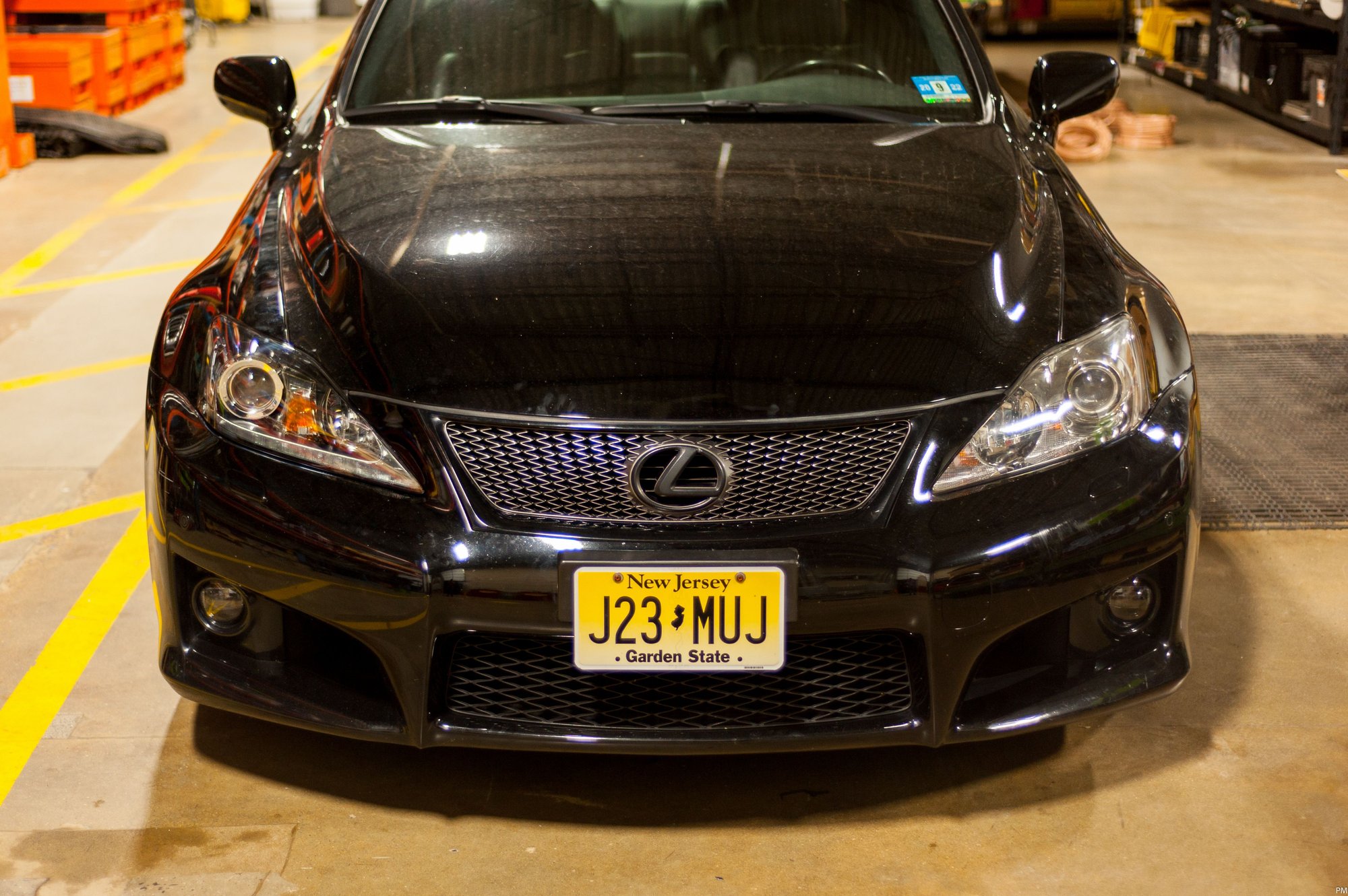

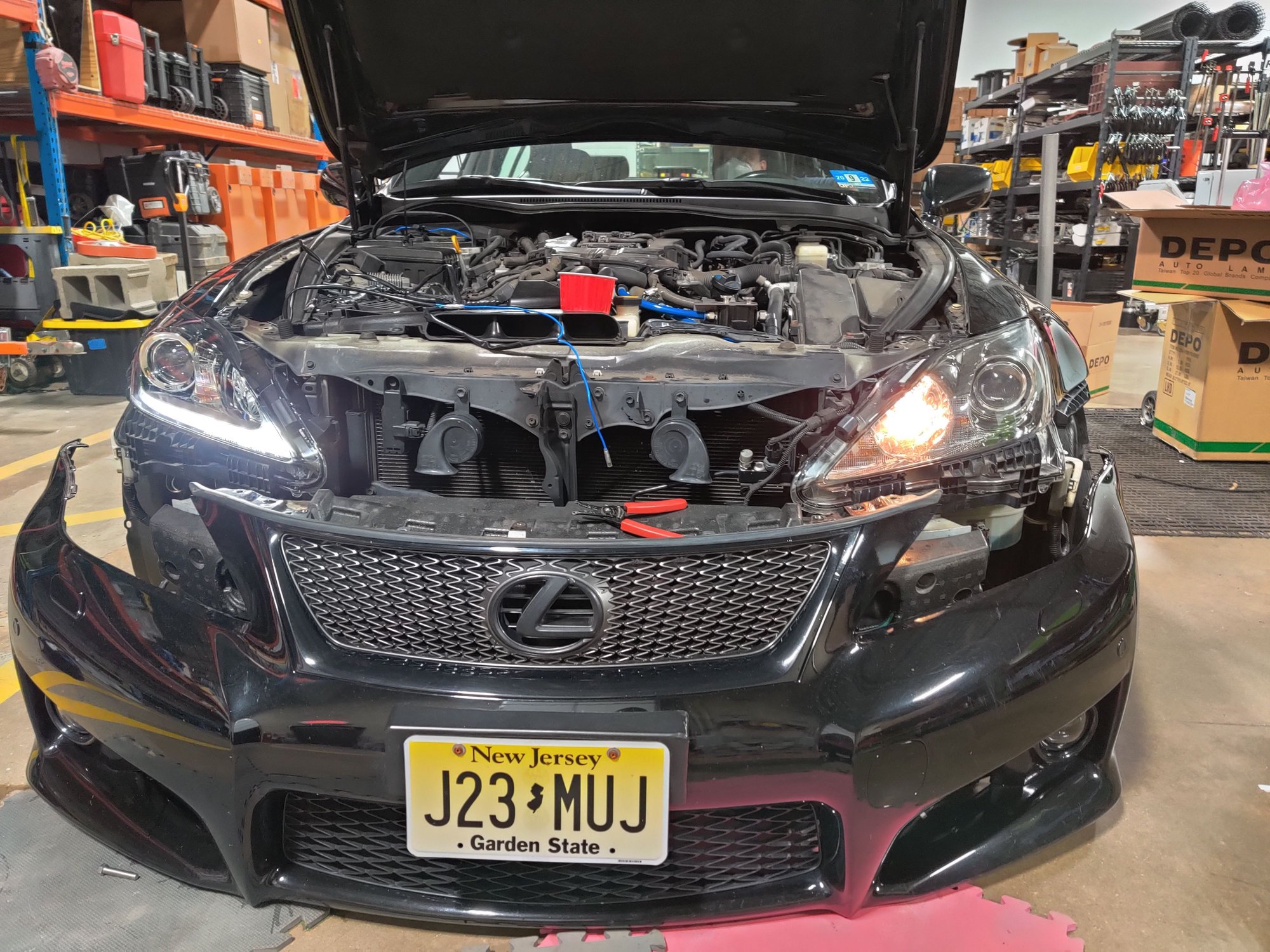

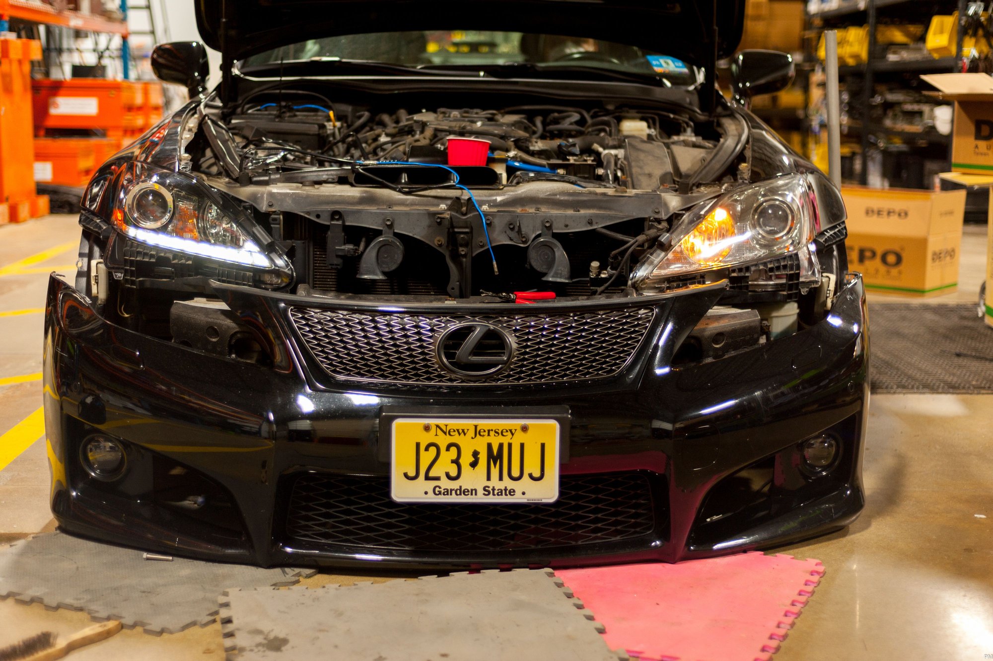

Due to a loose connector inside the drivers side housing, I am now running the new DEPO USR edition on one side and OEM on the other.

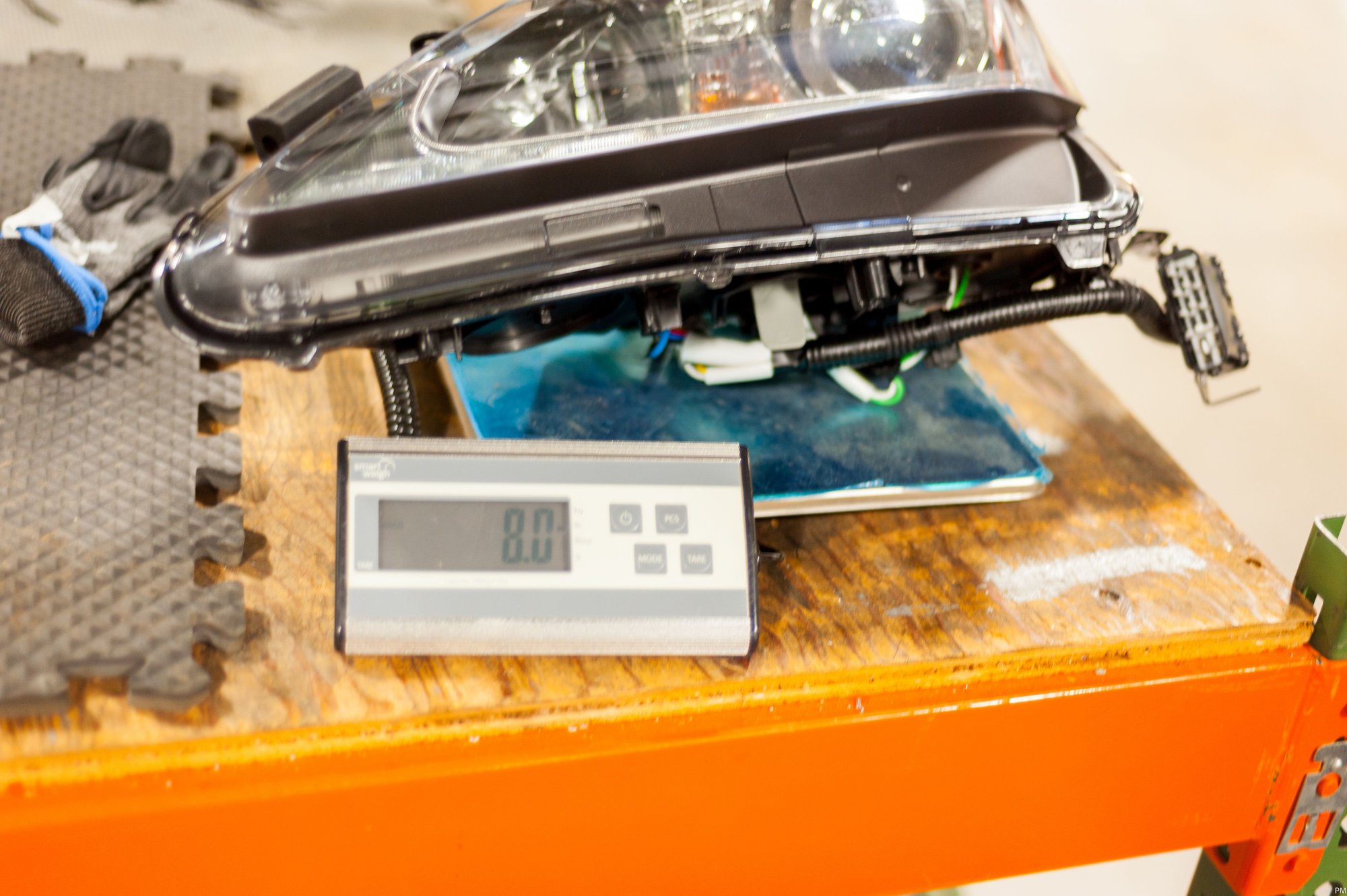

DEPOS ship with H11 & 9005 Halogen bulbs, anti-flicker resistors and Incandescent 7440s. LED strip is bright on parking and the housing looks smart when its off. DEPOs are ~4 lbs lighter vs OEM Xenon HID w AFS.
What do you guys think - DEPO USR Edition Halogen w/LED check and 4 lbs lighter or OEM Xenon HIDs?
DEPO USR 8 lbs
OEM HID w AFS - 9.9 lbs
DEPO USR (L) & OEM (R) - DRL
DEPO USR (L) & OEM (R) - Parking
DEPO USR (L) & OEM (R) - Driving
DEPO USR (L) & OEM (R)-Highbeam
H11 and Antiflicker for leds
9005

^I like the Depo look wise more then the oem. Since the Depo was made for halogen bulbs even with HID inside it won't match the light output of the oem headlights.
