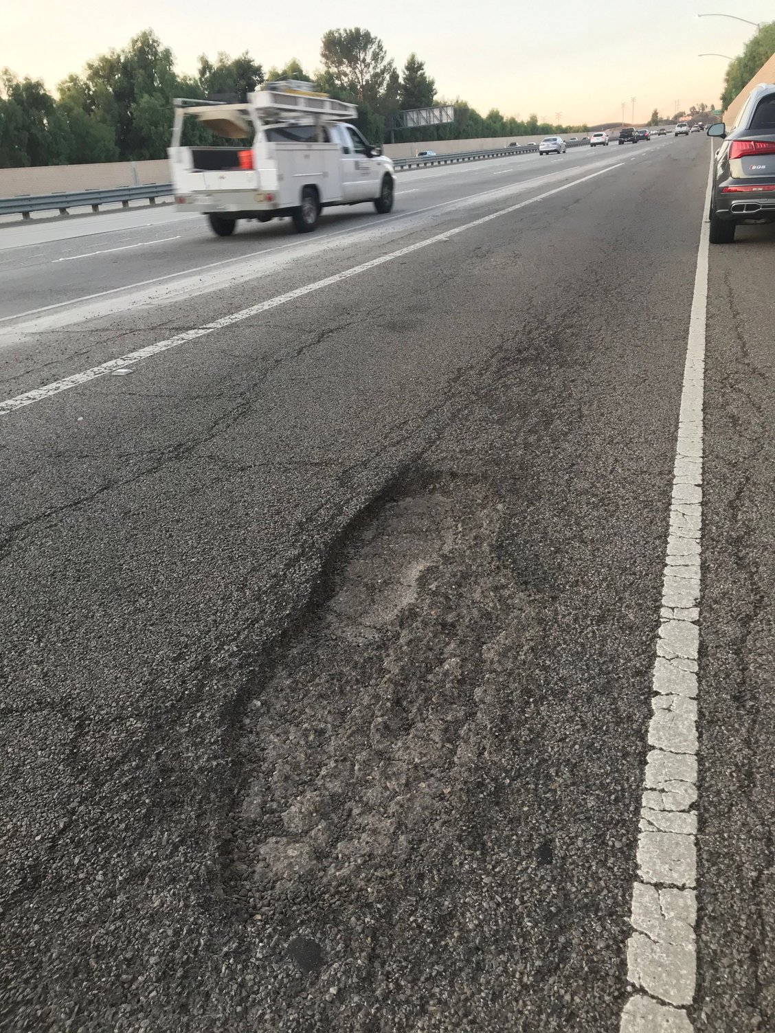

Do I have any recourse for an absurdly-large pothole that significantly damaged a wheel? Onramp, behind another car going 40-50, just before merging into the slow lane....pretty sure I need to get this fixed somehow or replace the rim altogether. Should I bother with Caltrans or CHP or the city or something or will they tell me tough s*(t? Insurance? Or do I have to just wear the cost?

There is a process for filing a claim with Caltrans:
https://dot.ca.gov/online-services/submit-damage-claim
Photos can be attached.
I have never filed against Caltrans but have filed a claim with my insurance company for a pothole-damaged wheel, it is a simple process.

Fixable they’ll heat it up bang it back but the whole wheel gonna need to be refinished or painted

Anybody know of a good place in SoCal that can repair/refinish/etc this thing?
Also wondering how likely it is that something with the suspension was damaged, even though there were no steering/braking/vibration issues. I guess I should bring it to the stealership Monday morning and have them check it out.

Unlikely the suspension is damaged even with a blow like that, but more than likely the corners of the sunroof are now bent. AMHIK. I got this repaired but it wasn't inexpensive at all. Too much chassis flex in this car when you hit something hard like that.
