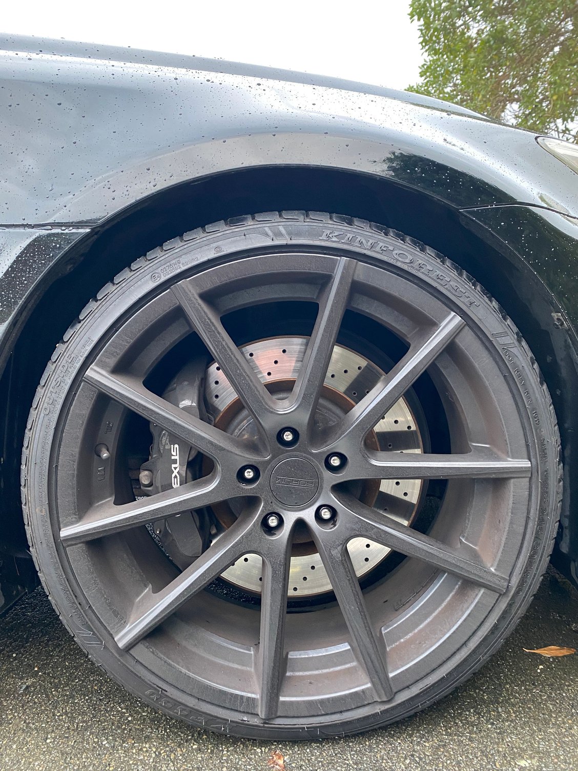

it’s a DD so willing to sacrifice some handling to get rid of the gap between the tyre and fender.

You'd be way better off starting with a 255/30/20. It's very close to the OEM diameter. The 245/30/20 you have is enough smaller to make the gap look pretty large. It would also put the OEM suspension geometry a lot closer to design spec. Then lowering maybe 10-15mm would be sufficient and would have a small impact on roll center, roll couple, and instant center. I run 255/35/19 on the front. It works well and makes the wheel gap look at lot less even at stock ride height.

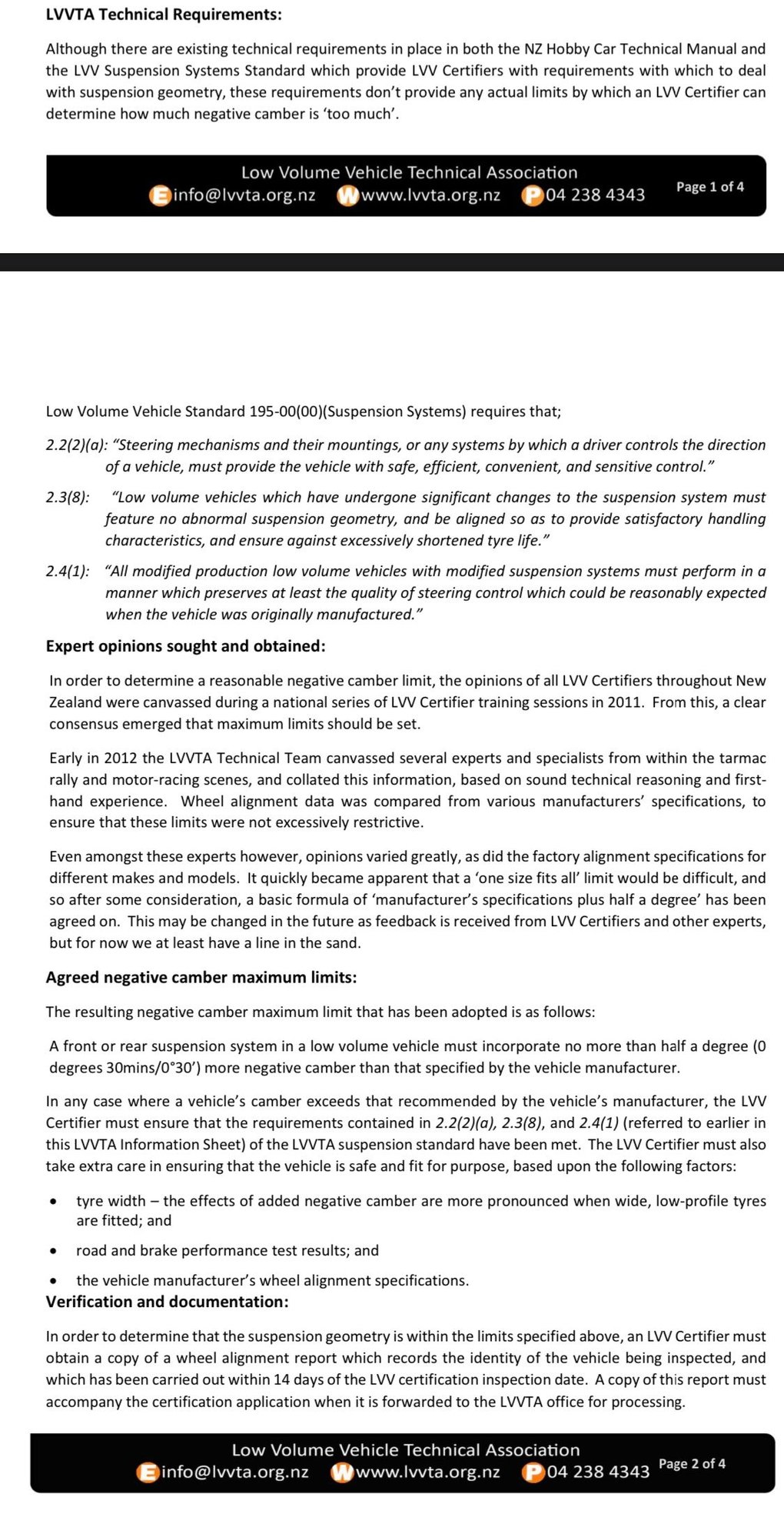

I found this camber guideline for certification in NZ. To me it reads, if the camber is beyond .5 degree that they can still allow a cert given the vehicle is safe. The cert guy I chatted to seemed pretty firm on the .5
