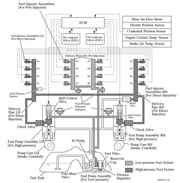

There isn't one regulator. Each of the HPFPs has a check valve to set the pressure. There's a real chicken and egg here - if one of the check valves in one of the HPFPs is bad or leaky, it could cause the whole thing - assuming fuel pressure is the issue. It should be easy enough to datalog with Techstream and see what the fuel pressure sensor is sending to the ECM. If there is a problem with a spill valve, you could also have the same issue, and the spill valves are both controlled by the ECM.
