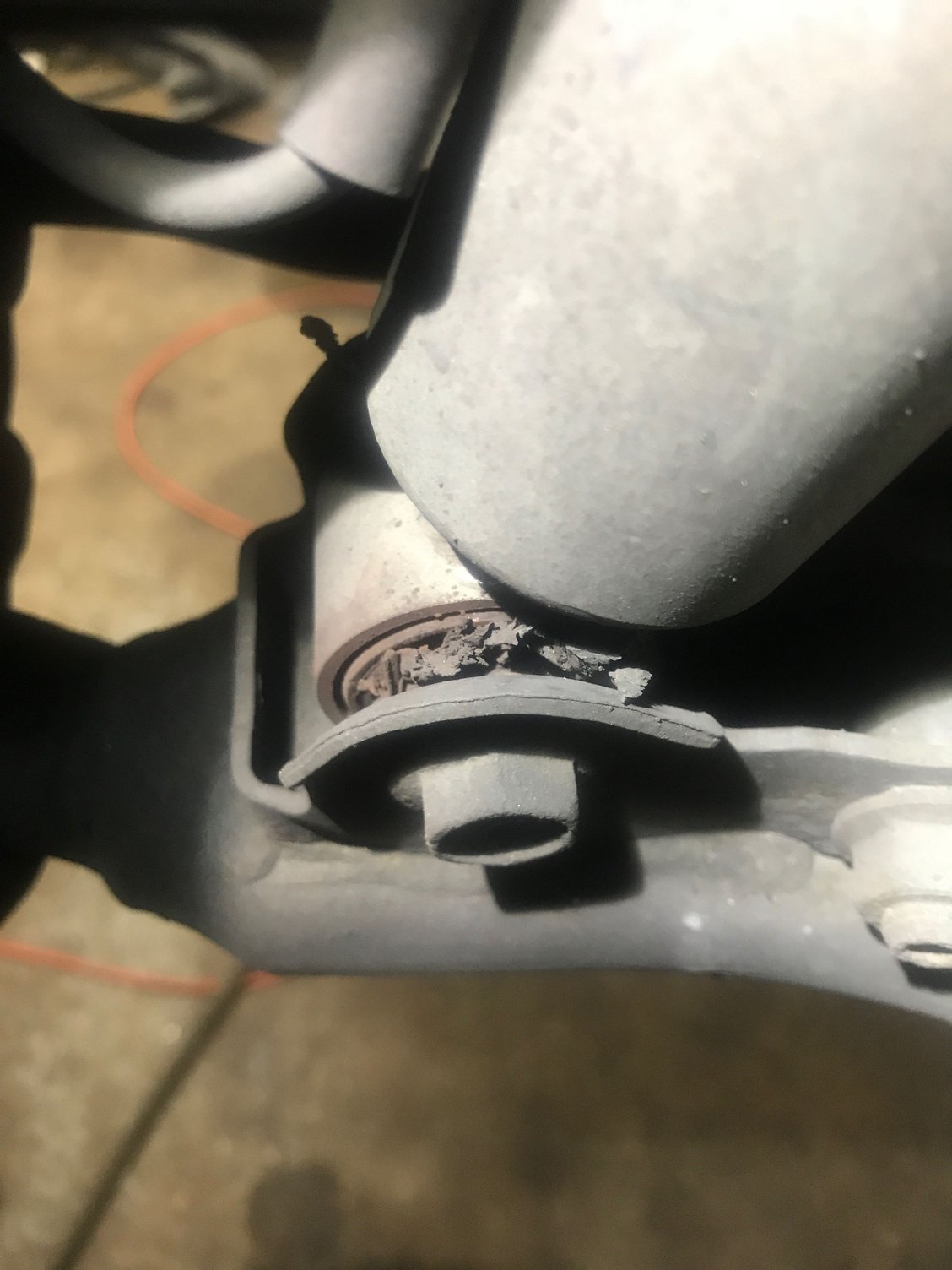

Hey guys I have the kw v3 Coilovers on my Isf and finally found out why it was squeaking take look at the pic
need to know if there’s a replacement for it other then that the Coilovers are still good like the day I got them meaning ride quality .

You can contact KW, that’s what I did when I needed the adapters for mine. If that doesn’t work, PM me and I can give you a contact that helped me.

Reason why I’m glad I went with Penske coilovers. I rather have spherical bearings then rubber bushings.

Somebody didn't set the suspension at normal ride height before tightening the bolts.

Everything cost me less then a 100 dollars shipped from kw think it was just wear and tear from putting miles on it . If I could I would daily my isf everyday and it’s supercharge too but with the winter weather it’s sitting for now . I notice it after hearing it squeaking and replacing my rotors brakes and tires . Crazy thing is I bought figs bushing kit to fix squeaking and all this time it was that . Easy fix for me . Penske good Coilovers but to me kw good enough cheaper but good enough especially when I don’t track my car so I don’t really need that much spent on Coilovers as long as its a comfortable ride for me. After stock goes ima planning on doing the motor too

I have come across this forum for a solution since my suspension busing was also torn, and I was wondering if you could get that squeaky noises done or if if it is the figs bushing kit (LCA?).

Depends on which bushing is torn.

It is on the front left driver-side suspension, I contacted the K&W company and they give me the part number for it which is 65210546.

@9hantom is this the part number for the KW lower eye bushing Scott610 needed?
@Scott610 Is that the part number I am looking for?

Tell them to send you a diagram and it should be on there website as well so you know what your looking at they are rebuildable
