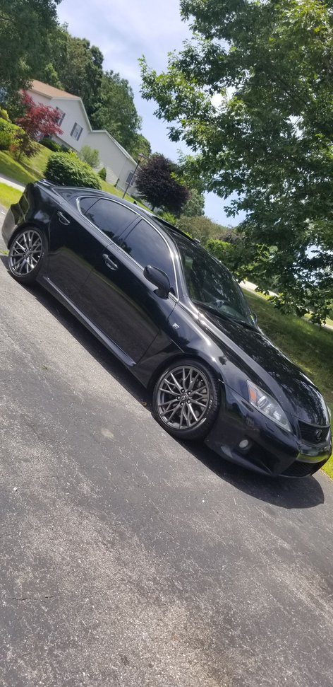

So i been posting about ebay coils sparkplugs and random misfires...well i put all original coils back on and swapped out the bad coil for the oem denso swapped out the new oem denso plugs with the ngks cleaned maf sensor and intake. Well FML im still getting random misfires at full throttle. When i pulled the denso plug pass side near firewall it was black all others kinda white these new plugs had less than 50 miles on them...whats going on with this car please help..i sold my 08 m3 cuz it had 115k miles and was getting nervous about things starting to fail so i bought a 2011 is f with 120k on it cuz figured screw it this car will last longer. Only a couple grand outta pocket to buy car 3 years newer with pretty much same miles...now im literally gonna trade it in take a lil hit and just go back to m3, if i cant figure this out soon...figure whatever dealer i bring it to wont beat the crap outta it if they even test drive it so if anyone buys 2011 black is f on east coast, make sire u fully test drive it...please help or tell me where to take it..sorry didnt proofread nobody get on me about my grammatical errors please
