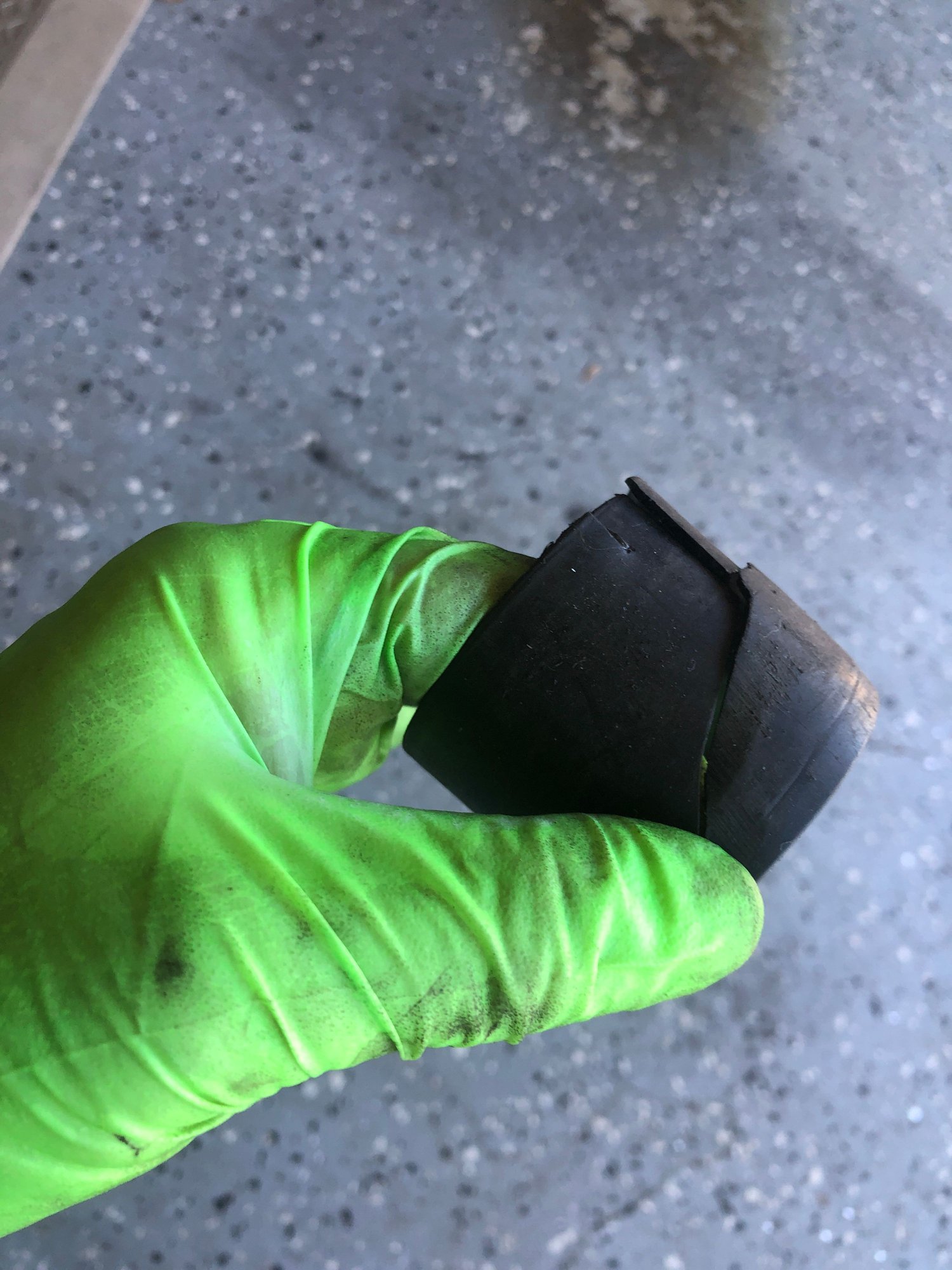

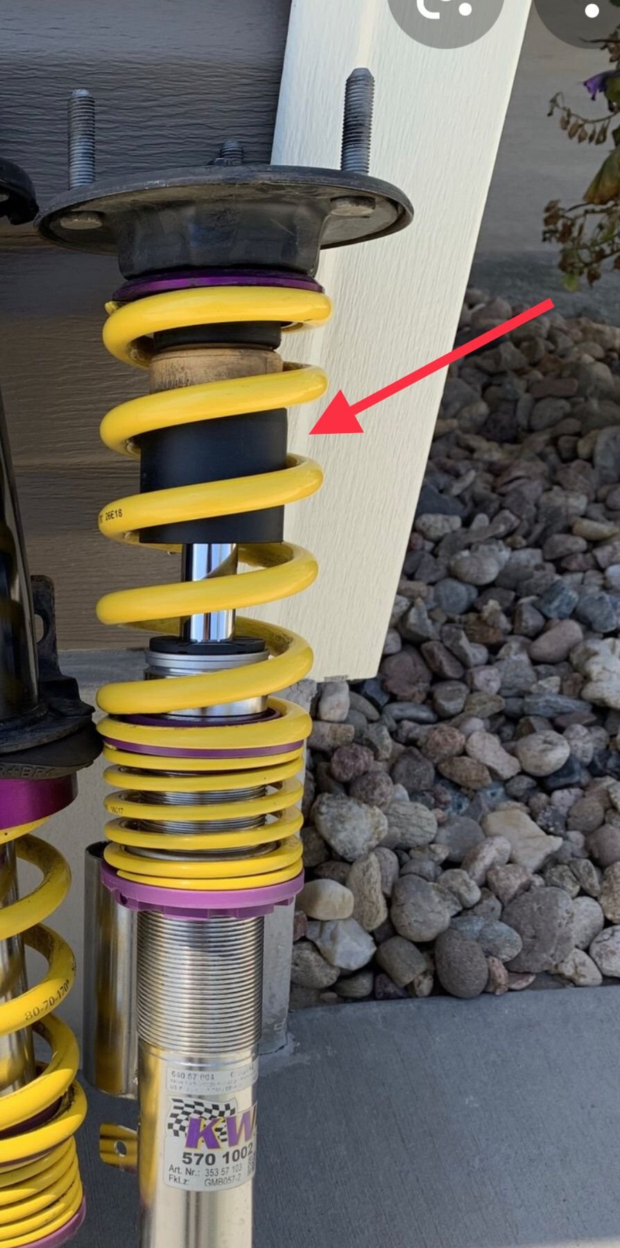

I discovered my front passenger side unit had one the black dust cover separated and cracked. I had to take it off. Question is, how important is this and what should I do? Can I go just without?
This is the black sleeve I am taking about.
It was cracked, I had to remove it.

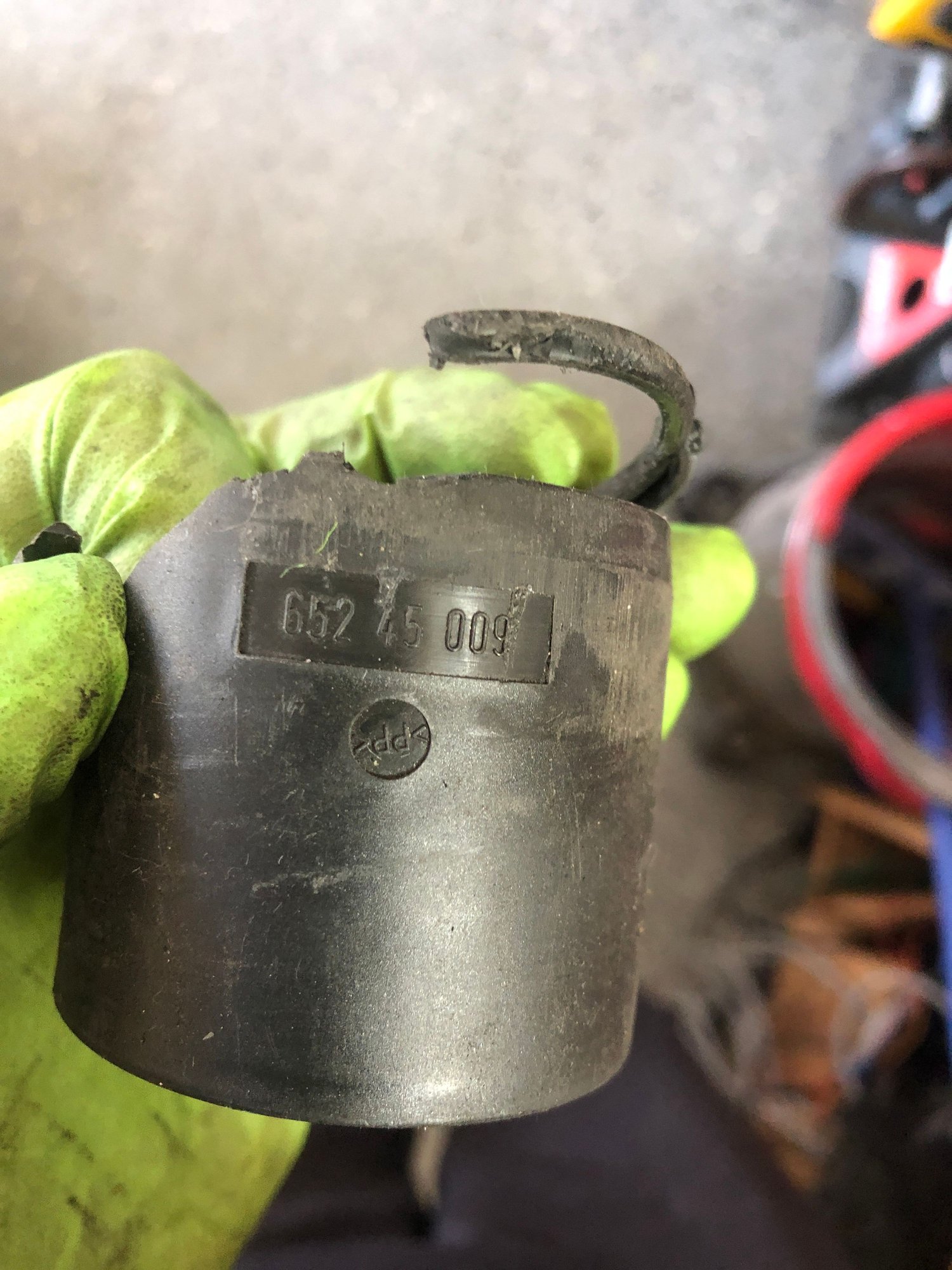

It has this part number

https://www.kwsuspensions.com/kw-sus...-65245009.html
