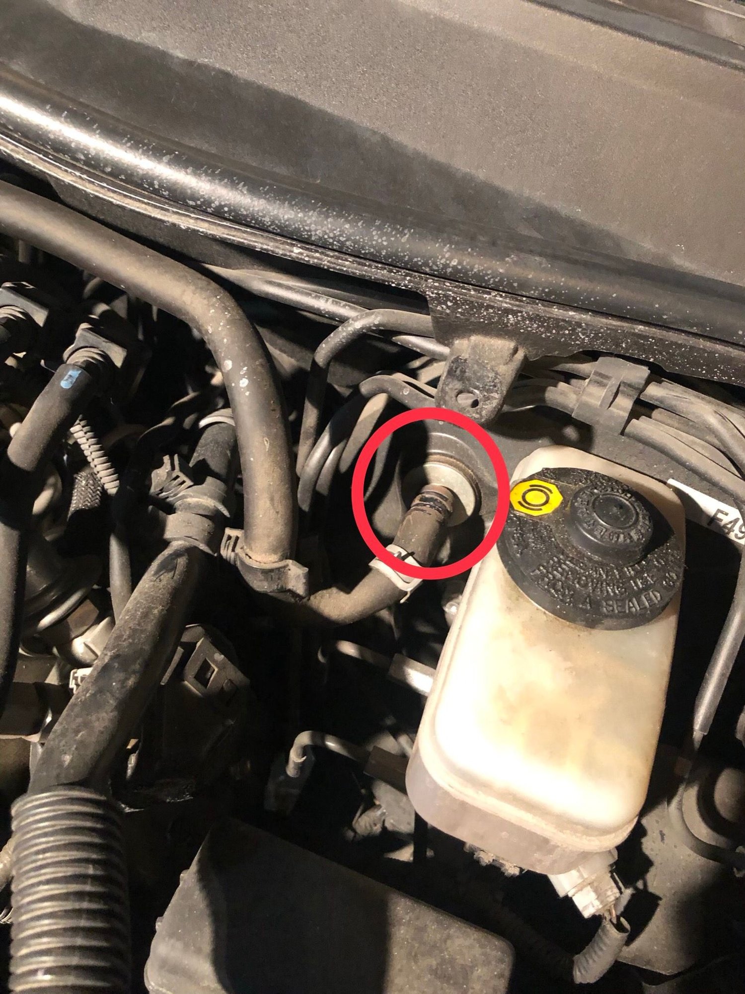

It's dead easy to get to. You just have to remove the plastic engine cover up top on the driver's side and you can see the valve in the brake booster with a big fat hose on it. Pull the valve out after pumping the brakes to be sure there is no residual vacuum, pull the valve off the hose, stick the new valve on the hose then into the booster. Might take 10 minutes if you work slow.

Thanks for the confidence inspiring post. It really is that easy.

Although the explanation in the previous post was easy to understand. Picture worth a thousand words.
