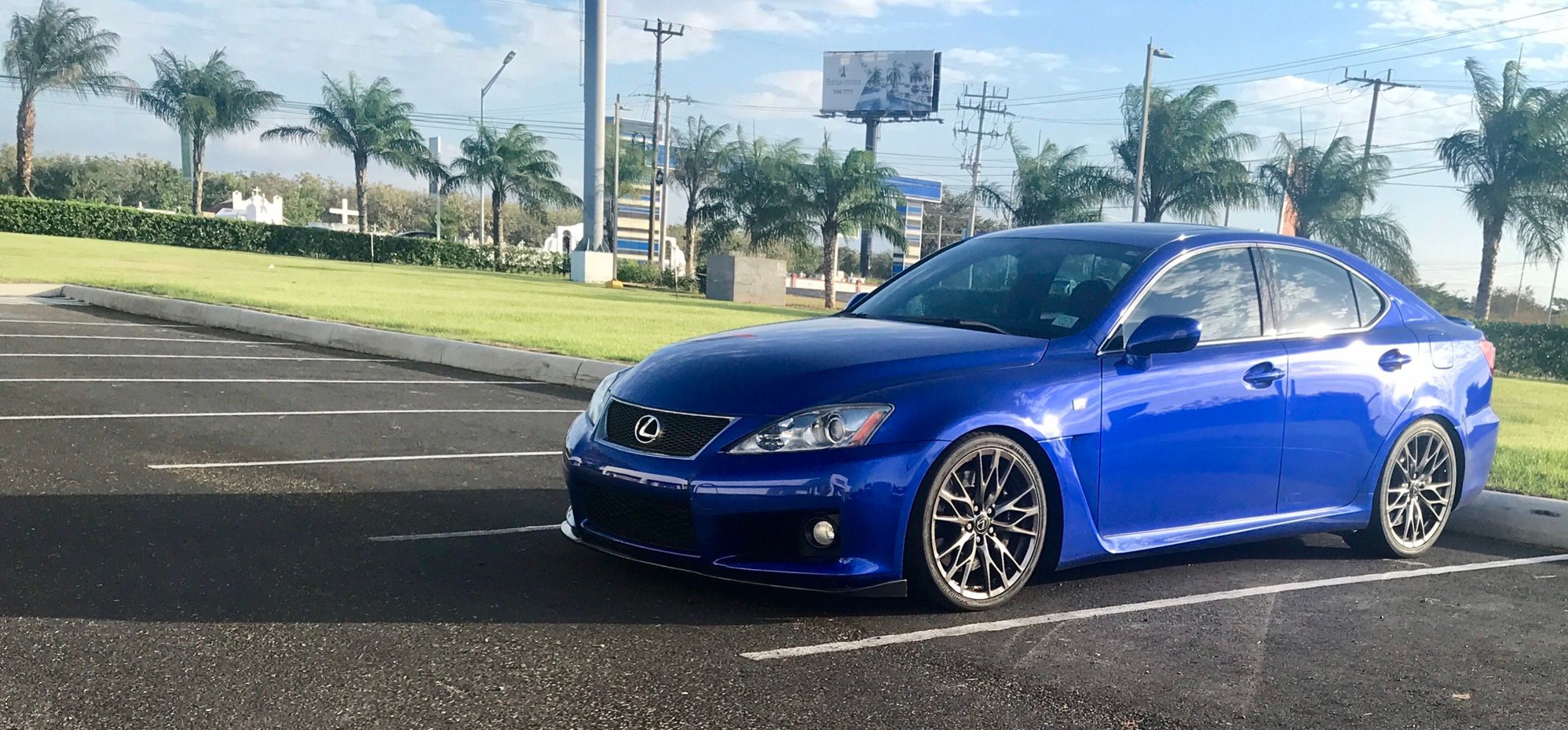

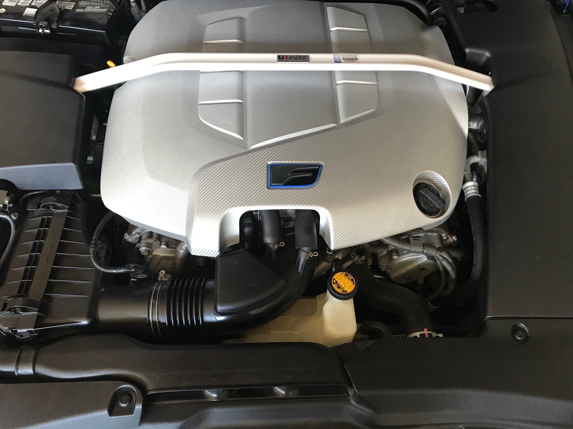

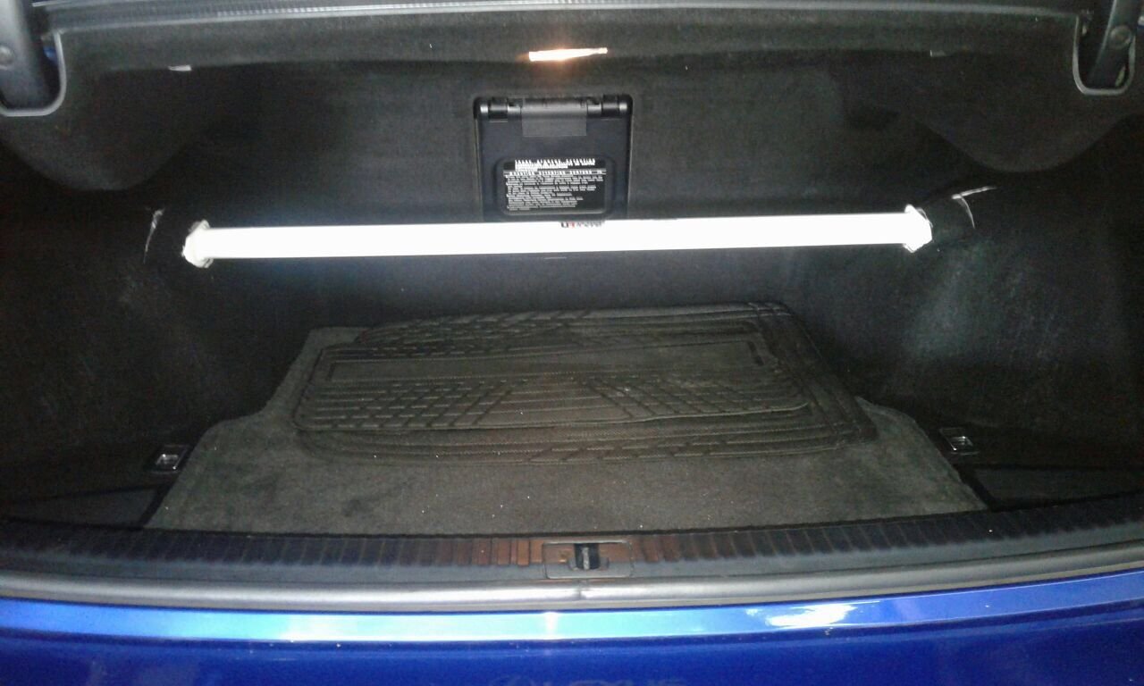

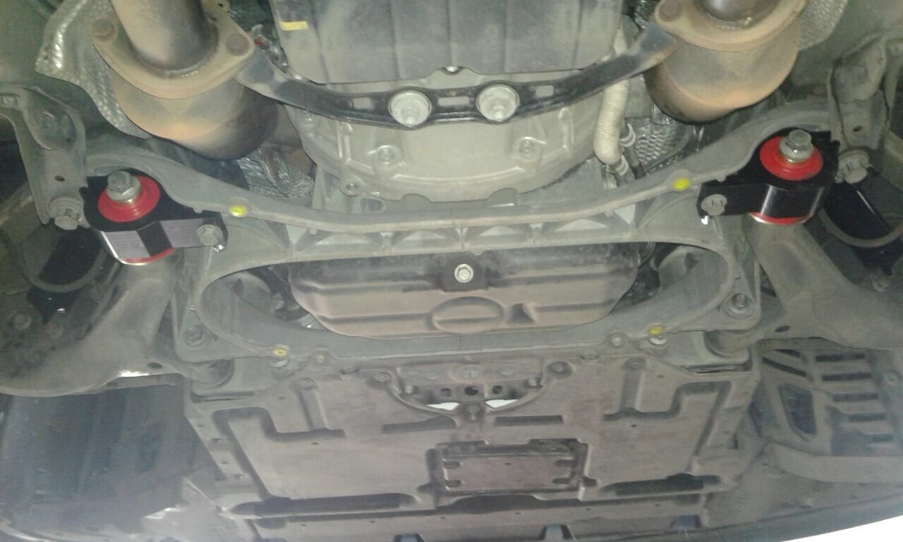

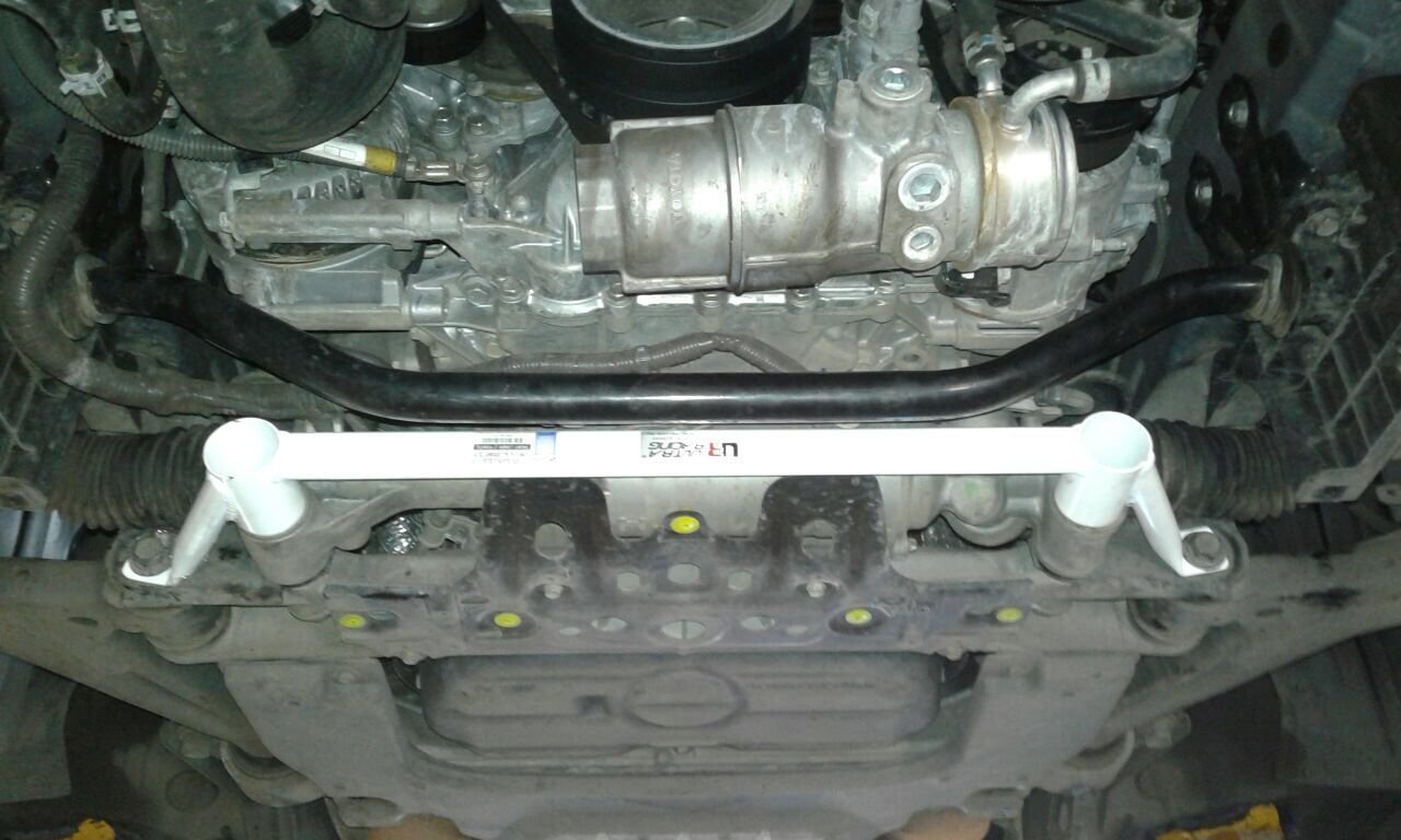

Just installed a set of BC Racing Coilovers, rr racing LCA USRS and Ultra Racing struts bars / lower front stress bar. Ah and I did front sway bar repositioning of the connecting hole 1" inside on each side. I went with 16/12 spring rates and now I'm dampening at 20/25 for the street, but feels a little bouncy. For the track I'll try 15/20.
The car is another car. Planted, agjle. Im not fighting with it in the corners. There is feedback now from the steering. Just waiting on the new tyres R888r 235 in the front and 275 rear and ready for the next track day on March 11th.
Almost forgot u lowered the car 1" front and .6 rear although a few days after, it seems to be more.
Some pictures
