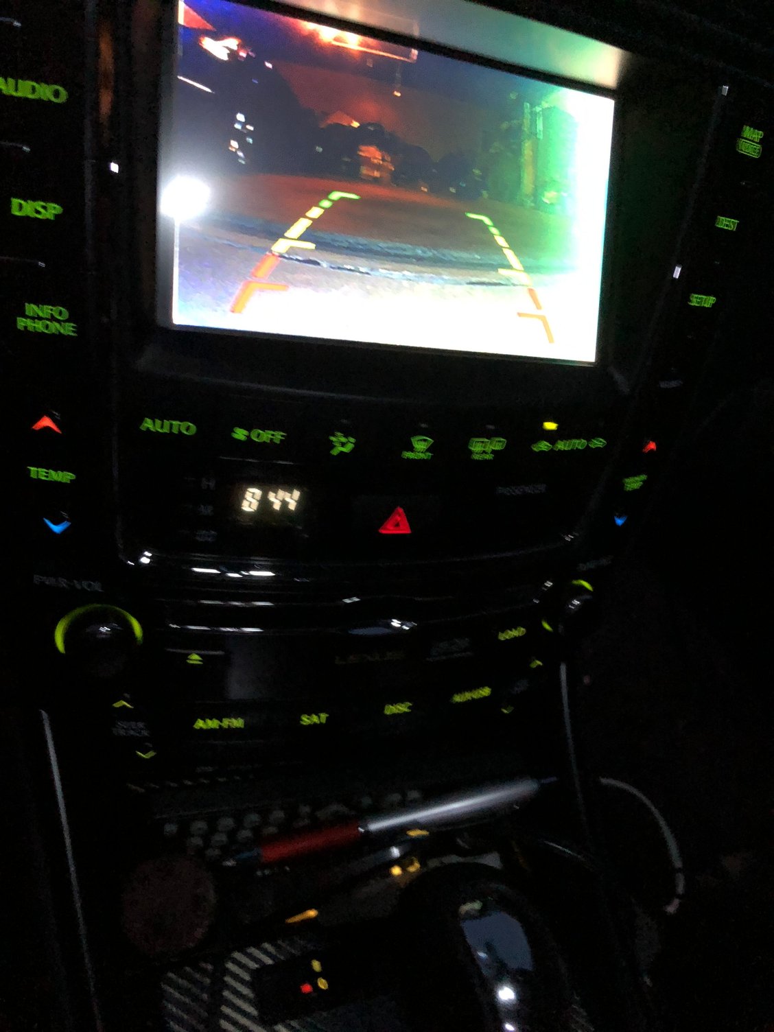

I got this same cam (sv-7620t) back in May and just installed it last night using a different method, I don’t like cutting into the factory harnesses. I have a Vaistech unit installed so I’m able to use my HDMI input connection with a converter. Anyhow, the svtcam reversed the image, the jumper only removed the guidelines. Is it even possible to reverse the image in this particular cam?

I've been away from CL for awhile so I just saw this. It's awesome to see someone else complete this mod! If you got the same camera as I did, I think it should have a second jumper to reverse the image, maybe they sent you the wrong camera? Anyways, after a year and tons of money spent on car mods, I would say this is my favorite mod I've done so far.

How did you get guide lines on your image?
I believe it's built into the camera.
