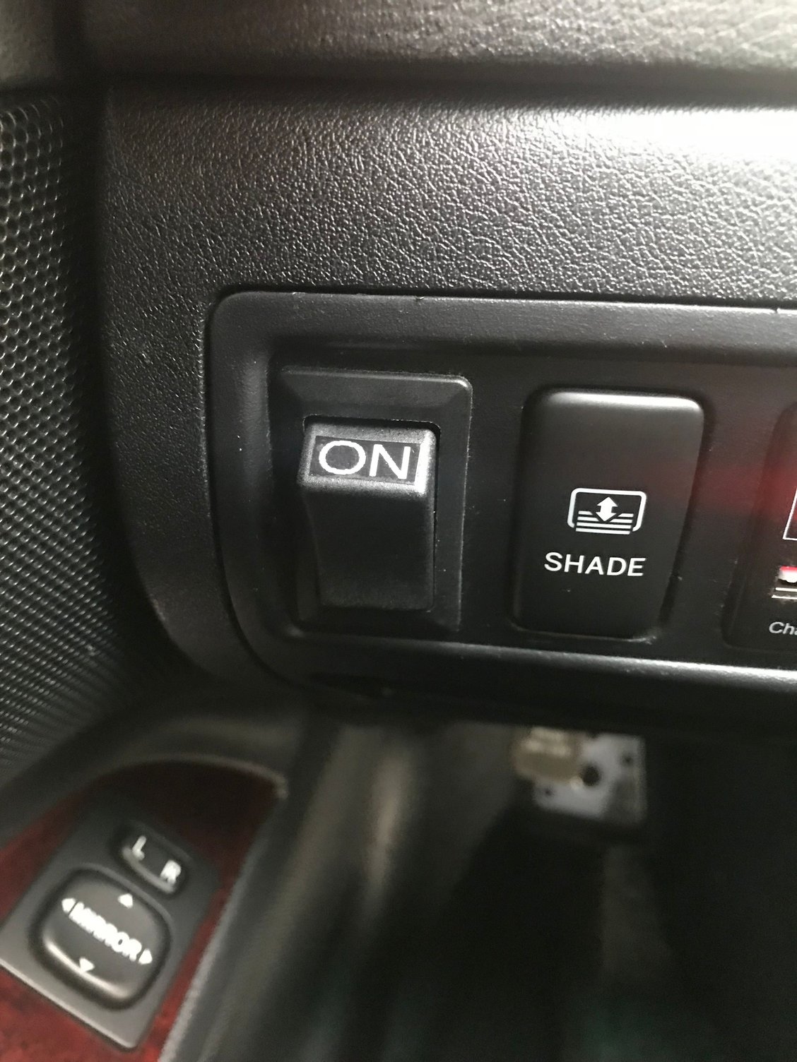

Picture below is from my IS250
Personally I love the way the switch used in the Nav hack looks. I put a label on it with white letters and looks OEM and doesn’t need power.
Gardner Bender GSW-45 Heavy-Duty Rocker Switch, SPST, ON-OFF https://www.amazon.com/dp/B00004WLKJ/ref=cm_sw_r_cp_apip_CdEjflV2cMo25
