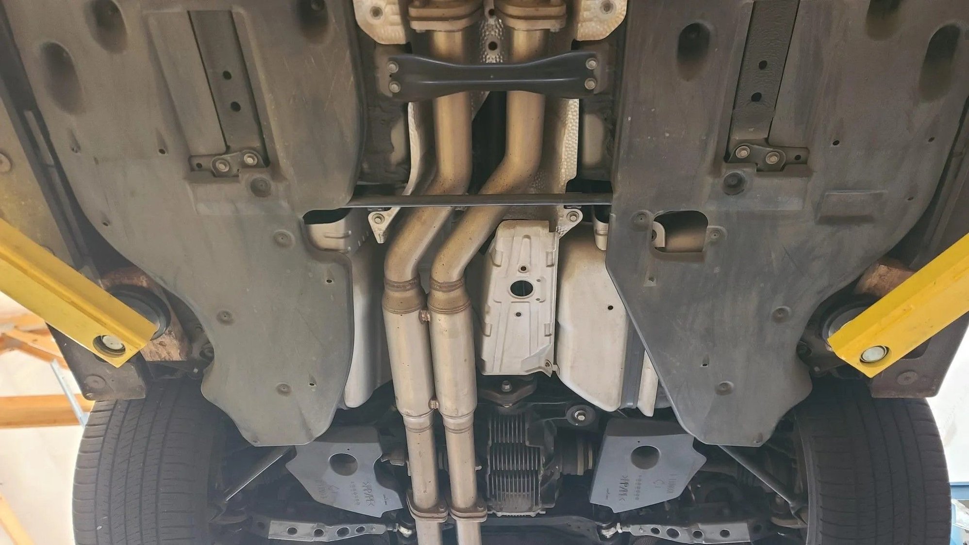

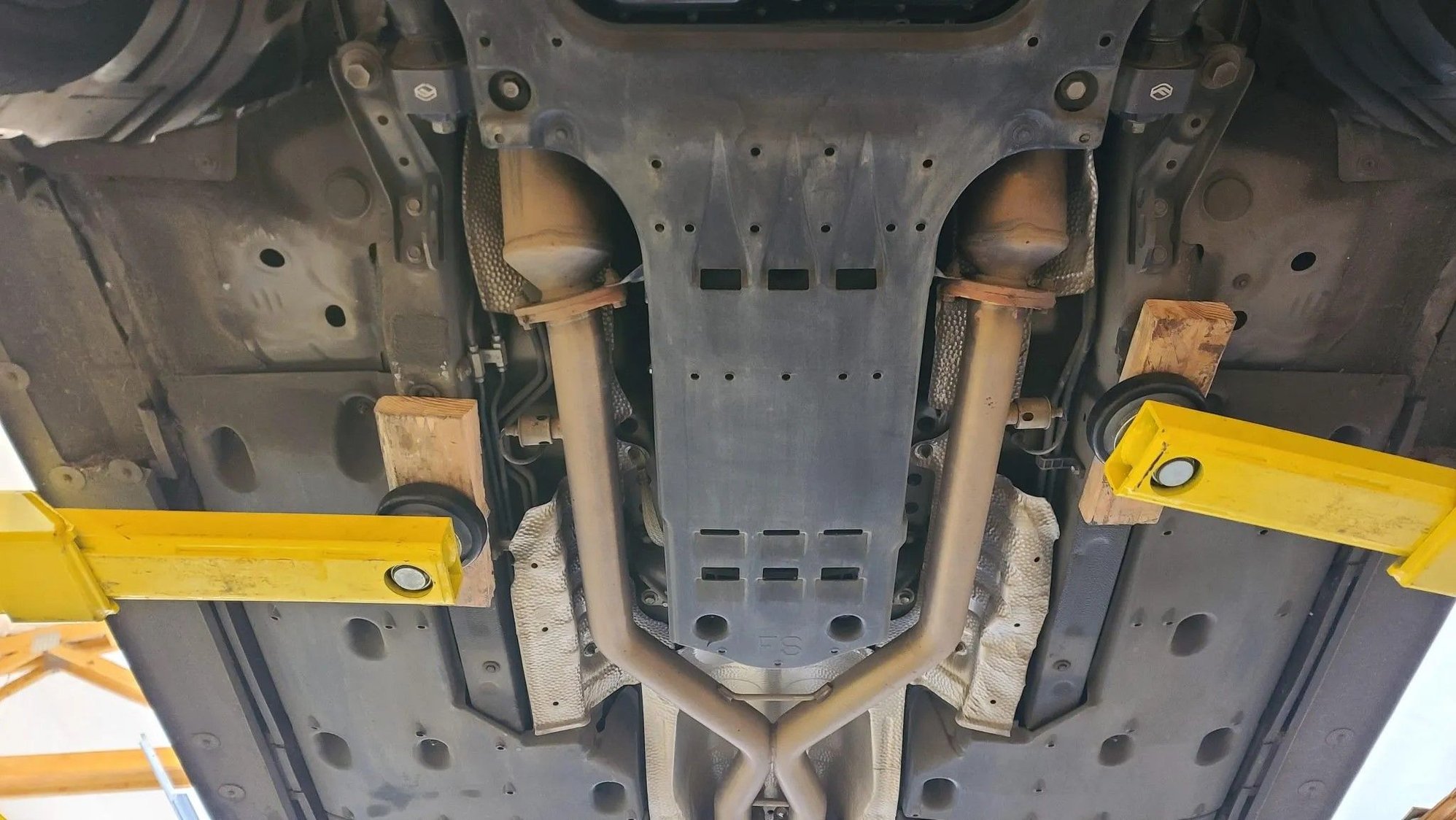

Reviving this thread. Came across these photos of an ISF on a lift and they were not using the pinch welds. Seems to be holding just fine and it would make jacking in a driveway easier if these points can be used for jack stands.

that’s where I put mines
