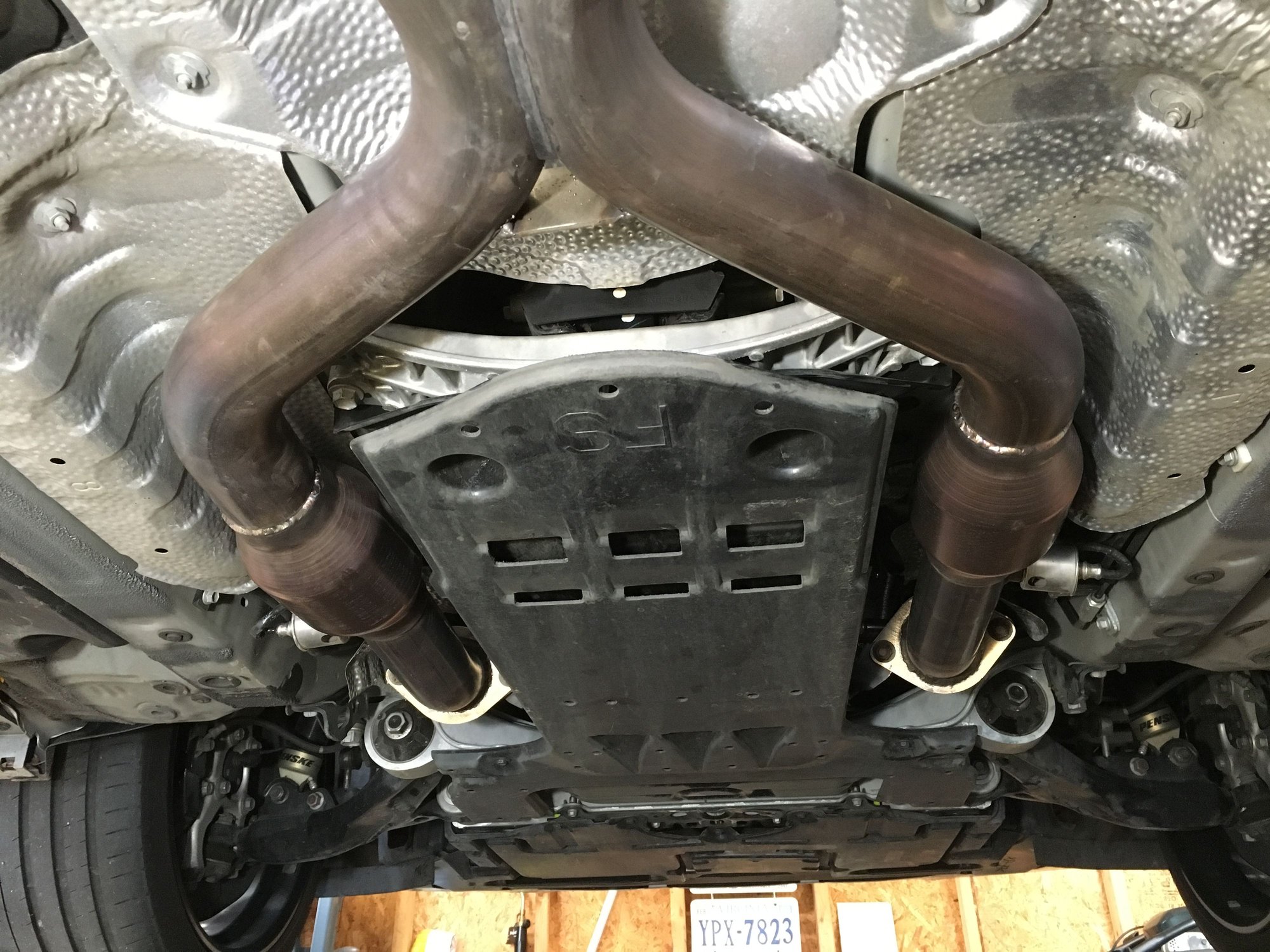

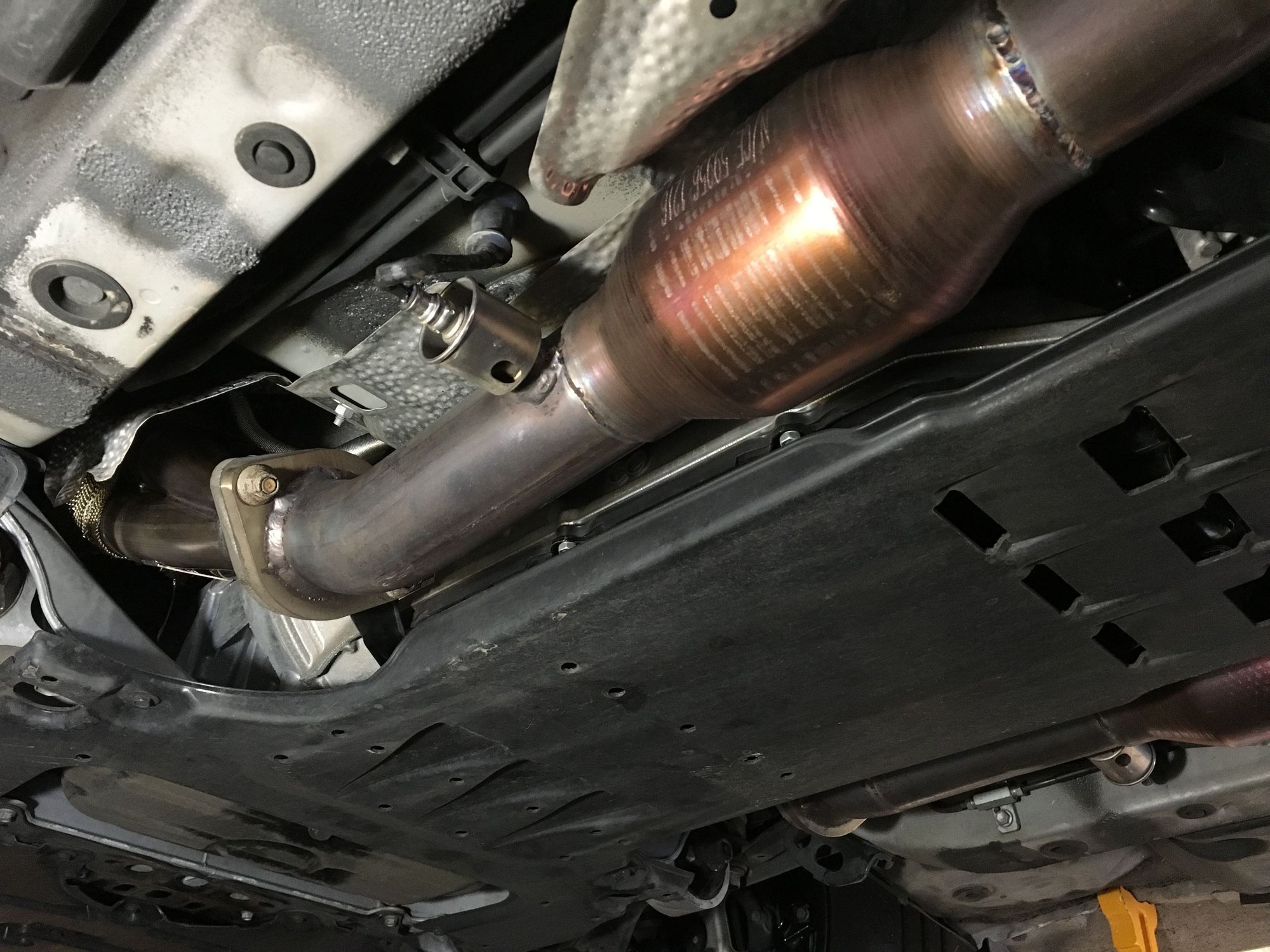

Here are some pics of my cats welded in after the secondary 02 sensors. It's pretty tight in that area. In fact, Jason (RR Racing's fabricator) altered the bend slightly near the flange on my passenger side mid-pipe to gain some clearance on top of the cat. Also, I'm pretty sure that same cat has been occasionally hitting the bracket that secures the transmission skid plate (4th pic). I sometimes heard a vibration/rubbing noise when turning right while accelerating. Yesterday, I removed the bracket & ground away the corner a bit. I haven't been able to reproduce the noise since.
-Mike
Old May 14, 2017 | 01:39 PM
  #35
Vervish's Avatar
Vervish
Joined: Apr 2012
Posts: 1,305
Likes: 134
Thanks for the photos - very helpful.
-Mike
Hi Mike,
What exhaust system do you have and how long did it take for RR's fabricator to install the cats (i'm assuming you had the exhaust on the cat already). Thanks!
I have the Borla exhaust.. Adding the cats to the exhaust took maybe 2-3hrs.. Though, it was his first time doing that, so he was figuring it out as he went. I originally wanted them before the sensors, but it would have required more custom fabrication to make it fit.. In hindsight, I was too focused on having them as close the headers as possible when I settled for the position they're in now.. If I had to do it all over, I'd probably opt for the location that you used. There's much more space in that area.
-Mike
