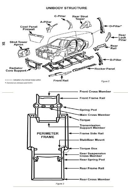

Someone is lying to you. All I do all day, for the past 9 years, is inspect vehicles for prior repairs. This often includes frame repair. The frame and the structure are different words for the same thing.
Here is the NAAA structural damage policy for unibody vehicles:
In the rear, the quarter panels are technically the only structural piece. The "rear body panel" (where the spare tire sits) ties both quarters together, but is not considered part of the structure per NAAA. For Carfax\Autocheck to show structural damage, one of the quarter panels has been completely replaced...as in cut out, and welded back in.
Personally, I wouldn't drive anything that even had a previously damaged rear body panel. Even if you don't care about the extensive repairs, the next potential buyer will, and it'll make selling that IS-F very, very difficult.
TL;DR : That car got rearended, HARD. You're an idiot if you pay $35,000 for it.

Car Fax often has unreliable information. My IS350 showed "moderate damage" from a rear end collision that did nothing more than scratch the bumper cover. The cover wasn't even replaced, but I lost $3k in trade value when I bought my F simply because Car Fax said "moderate damage" in their report.
My F had the right rear panel replaced from it's last incident. It was not rear ended at all, and certainly was not "structural damage" because there was no twist to anything sufficient to cause wheel misalignment - that was all from a bent tie rod. The car aligned perfectly and drives perfectly. But by the description above, my car would show up on Car Fax with structural damage. Absolutely silly.
If I could see the R.O. and see exactly what was done, then I could make a solid decision about it for my own use, but as is clear to anyone buying a car, if Car Fax has bad information, you will be taking a much lower offer for resale.
