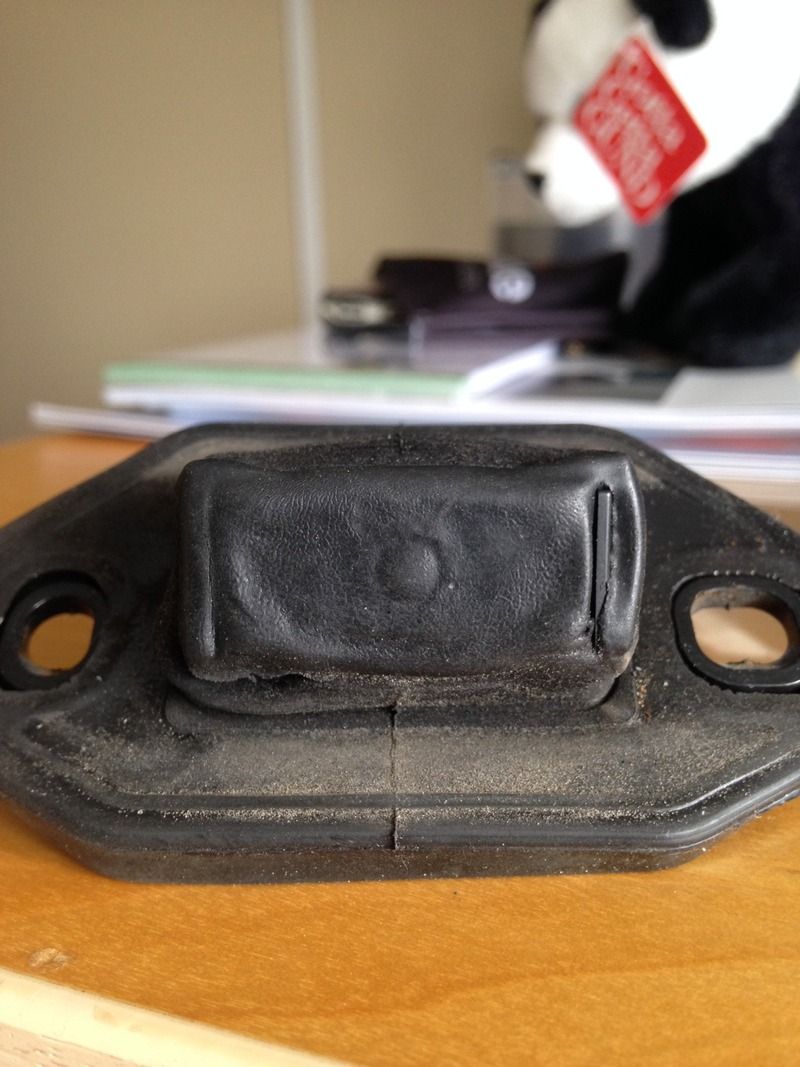

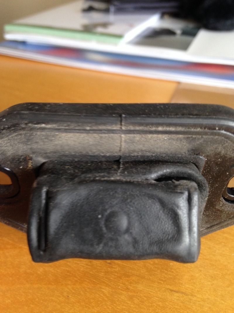

I pulled my button finally and ordered a new one.
Took about one minute to remove it.
Water has been getting through the holes in the rubber and actually started to rust one of the bolts on the inside.
Digger08

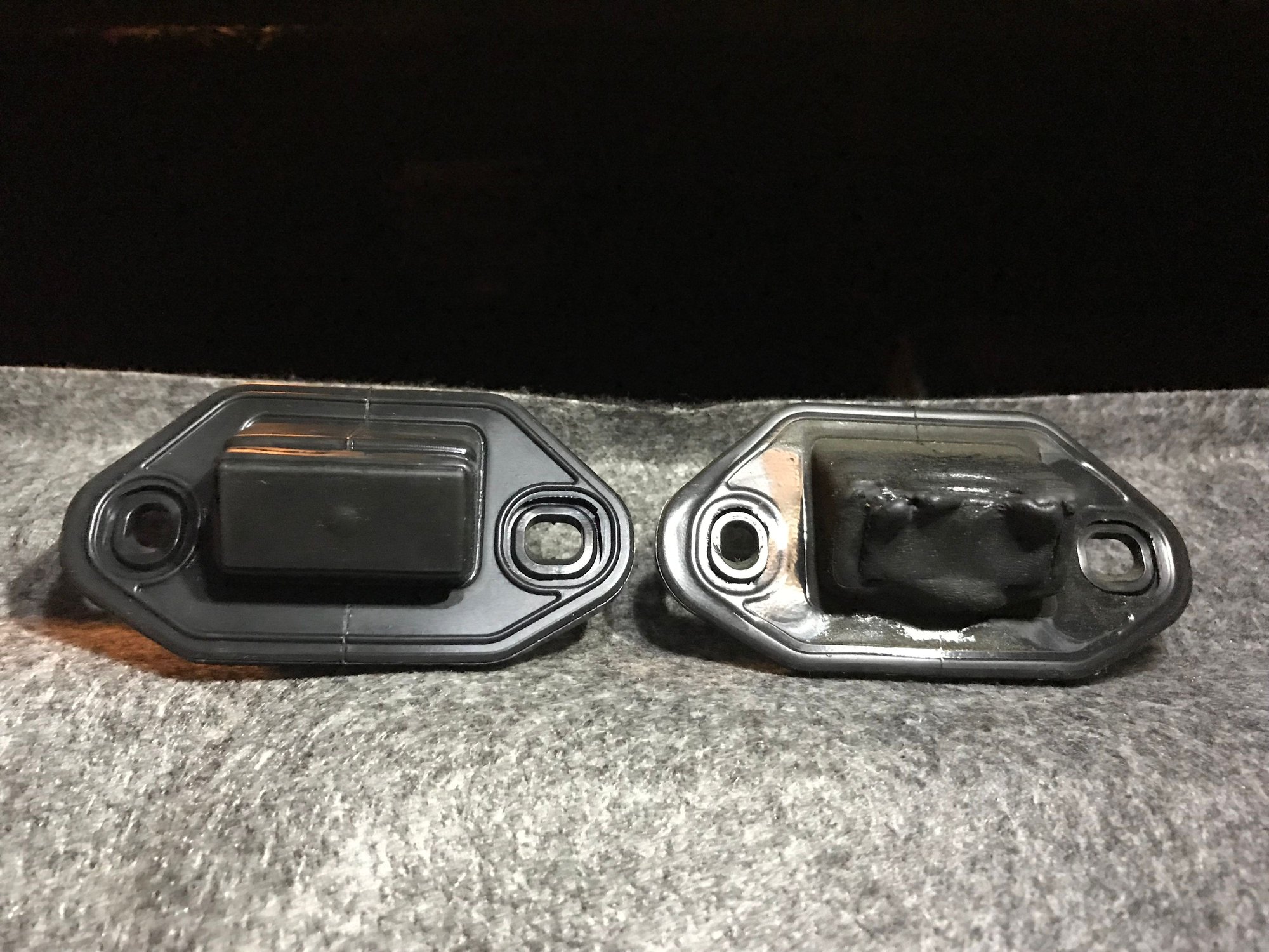

Just did mine tonight. Got the trunk button on eBay for $43 shipped! It’s been bugging me for a while but suddenly got myself to do it. I’m not taking her out when it’s 100+ degrees anymore
got the install instructions from YouTube:

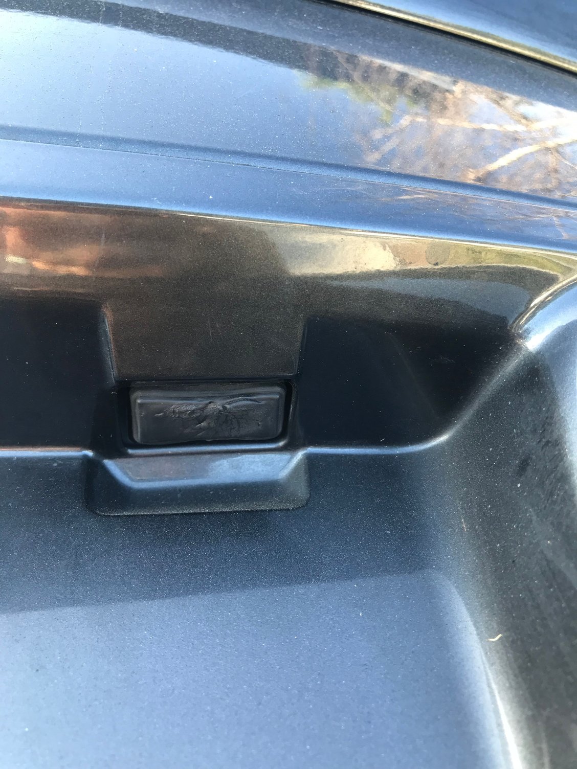

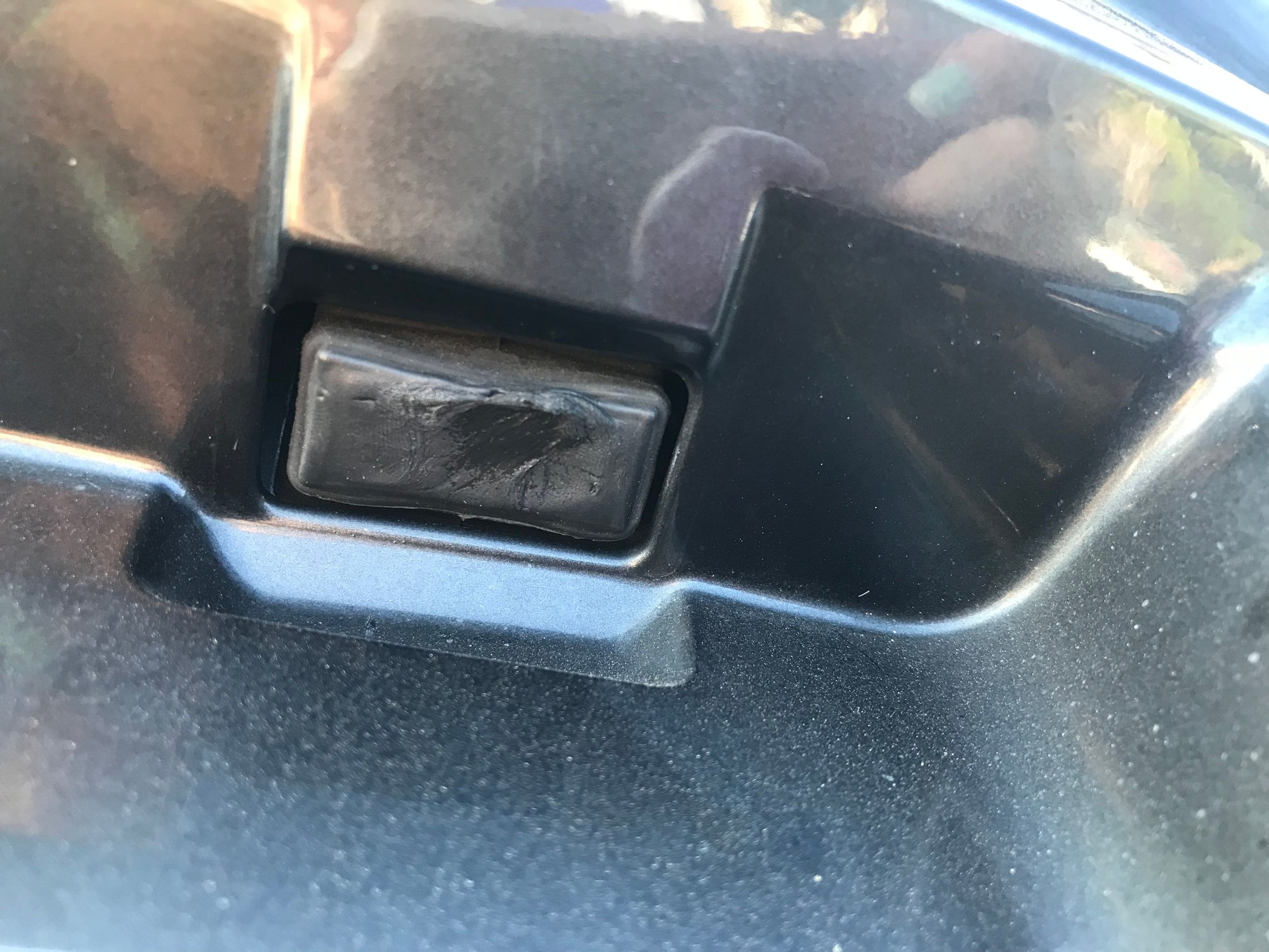

My 2011 Lexus IS 250 button is soft tacky and mushy
