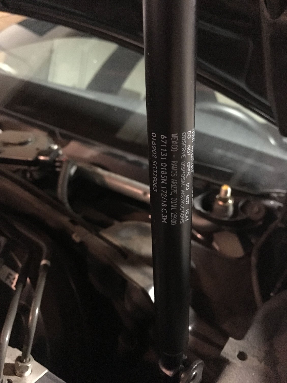

Sad to say, but Rock Auto has the same hood mounted Sachs unit for half the price. Might want to shop a bit.
+1 on this deal... Thanks for the recommend Lance
At RockAuto, I ordered 2 of these SACHS / SG329063 -> for the Font Hood.
$12.14 each plus Tax & Shipping came to $35 bucks for the pair.
The Lexus OEM ones also made by Stabilus, even with online discount they where still $65 each
Put these in about a couple weeks ago:
MANUFACTURER: SACHS
