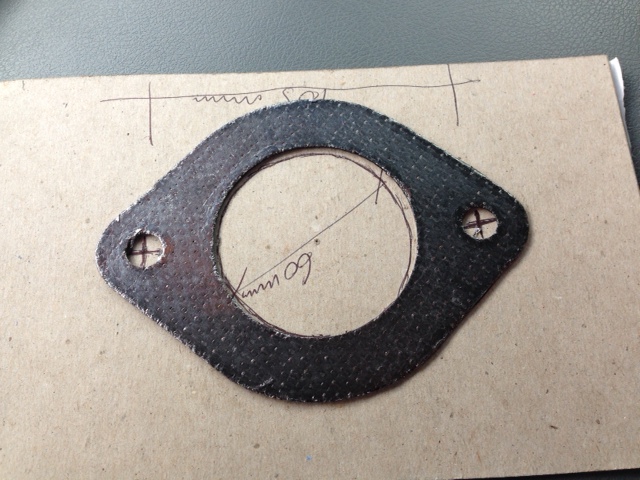

After we played with it more, we saw that the angle of the header on the passenger side wasn't perfectly lining up with the exhaust. Both were coming at each other from an angle, so when tightened up and under load or movement, I could see it pulling and creating unnecessary pressure. We took the car to the guy who does all our exhaust work for the shop and he changed the angle of one of the JoeZ pipes just slightly to make sure it came in straight at the header. He installed a regular flat gasket instead of the PPE or OEM donut type, similar to this
Result = still have a bad leak. Now, it could be due to the gasket and no longer because of misalignment. So I'm about to try...
Planned Attempt #4
Adjusted/corrected angle of header + exhaust on passenger side. Is the consensus to use the PPE gasket (below) on the header size doubled up with OEM gasket on the JoeZ side? Or just use the PPE gasket? Or double up on PPE gaskets? I've searched obviously and see all sorts of ideas.

I would not recommend using the factory gaskets at all. They are smaller than the ones we provide and can cause excessive heat due to friction through the smaller hole and shortened gasket life.
If you are going to double up on gaskets, use our larger 60mm gaskets and put a little copper colored silicone gasket sealer round them.
Another option would be to go to an exhaust shop and have them adjust the flange angle on the exhaust so it fits better, and then use just one gasket.

PPEHeaders - yeah, we noticed that the OEM one is smaller but I keep reading all the forum recommendations about doubling up with PPE + OEM gaskets. Didn't make sense to us but we tried anyway, resulting in Attempt #1 picture. We already got the flange angle adjusted on the JoeZ, so we will try a new PPE gasket and double up if needed. Will report on results.

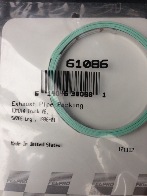

Honestly, I don't want to say too much...
But there should have been ZERO reason to change or modify how our flanges were designed.
They are angled perfectly to match the OEM specs / layout.
Somtimes you need to disconnect the X-pipe from the mid pipes to give you better mobility to line things up at the front..
Hoping you find a solution to the leak soon..!! :)
Joe Z
Also, here is the part number for the OEM crush gaskets if you need!!

don't mean to thread jack but Joe would you recommend installing the OEM crush gaskets between the exhaust flange and PPE Header flange?
