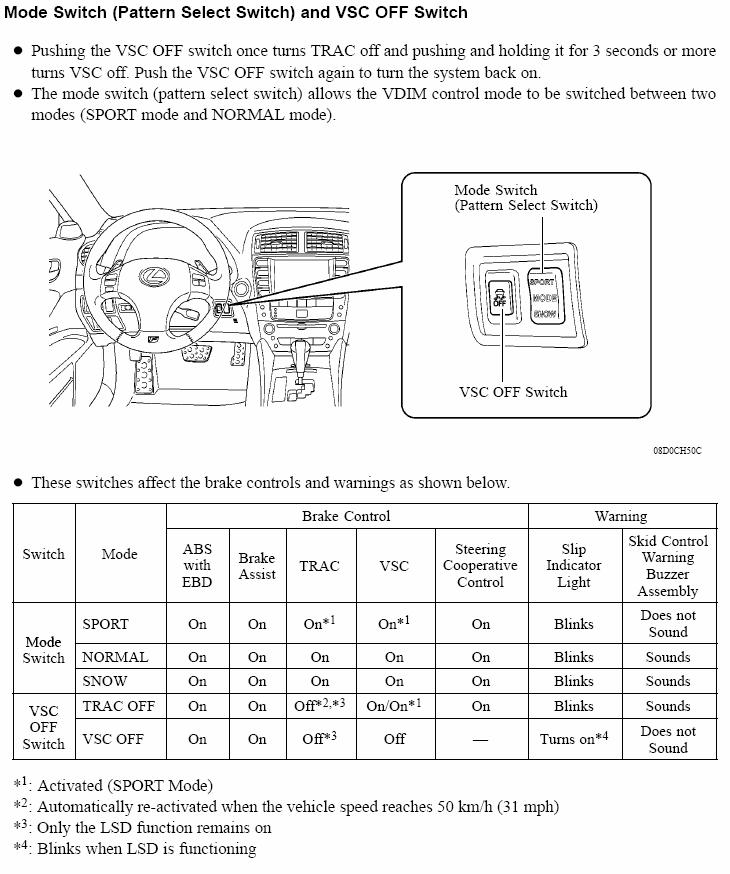

So with VSC off, does anyone know if the E-diff still functions or not? Only reason I ask is because even with VSC turned off, the light will still flash at me from time to time(while going in a straight line). It made me wonder if the E-diff was still functioning and the light flashing at me was the rear brakes doing their thing to distribute power.
And I am not talking about the pedal dance, just press and hold the VSC button for 5 seconds.

Stolen from another thread..short answer is yes, E diff is functioning.
Here's everything else that happens when you play with the mode switch:

Anybody have a clue what "Steering cooperative control" does?

Excellent post. Thank you for sharing.
