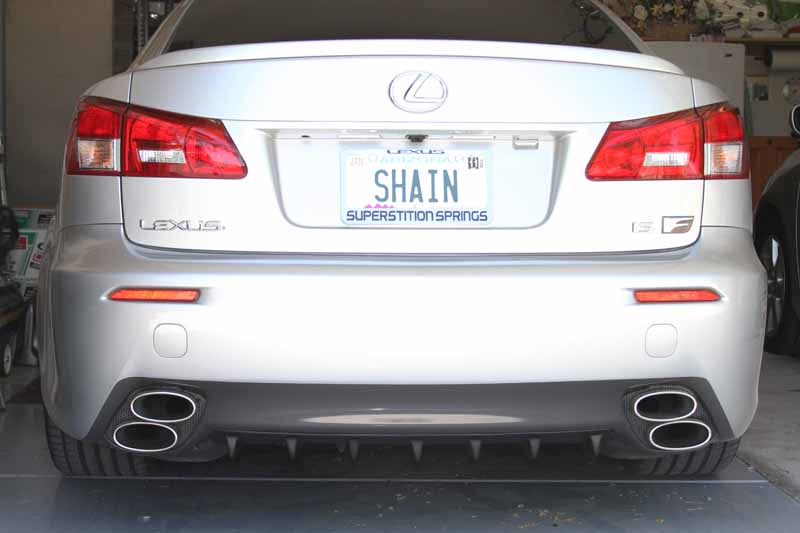

I taped mine in place first with masking tape. I then drilled small pilot holes thru the holes on the diffuser then used the self tapping screws and voila
Lou

The screws are self-tapping screws but for the IS-F you want to remove the plastic piece that is directly under the exhaust tips. There are two 10mm bolts, you will remove 2 bolts, slide off the plastic piece, then re-install the one 10mm bolt that holes the exhaust tips in place. This will give you the clearance to install the diffuser.
I really don't know what you are talking about My diffuser comes no where near the exhaust tips or the 10mm bolts Have you made a design change
Lou
