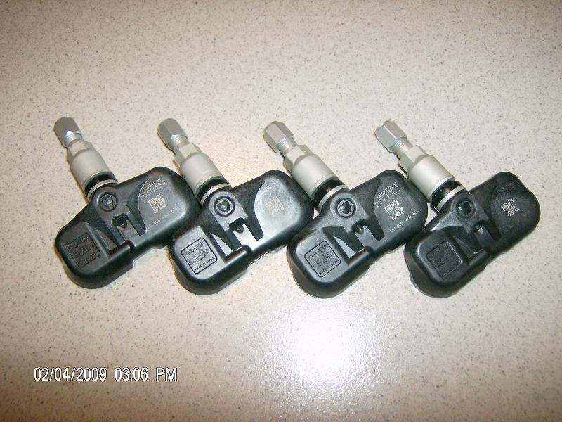

The OEM units will have a 7 digit transmitter id code imprinted on them above the bar code...
With out that 7 digit code the dealership will not be able to program them..
The OEM units look like the below. Each sensor will have a different 7 digit alpha-numeric sequence.
