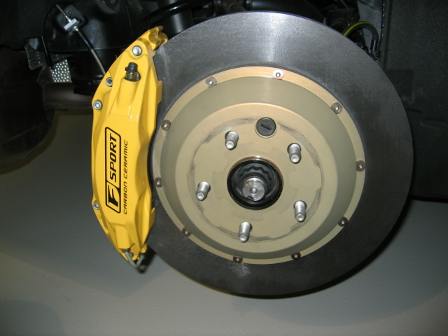

Originally Posted by Joe Z
Hopefully its TRUE this time around.........
Rumored to cost $10K (MSRP) initially.... Lets hope if they do offically release these, it will be much less..
The prototypes pictured below were built by StopTech for Lexus..
Here are some more detailed prior posts & pics found throughout Club Lexus..
Enjoy!!
Joe Z
Enjoy!!
SEMA 2007 .......
The other brake upgrade unveiled was the new Continuous Carbon Ceramic Brake Upgrade. A new generation of carbon fiber-reinforced ceramic material technology maximizes high-temperature durability and system cooling in this ultimate upgrade for the IS-F. Ceramic rotors measure 380mm diameter front and 355mm diameter rear on anodized aluminum hats. They incorporate the same internal cooling vane concepts as the F-Sport cast iron rotors, while significantly reducing unsprung and rotating mass compared to the IS-F stock brake system. Distinctively finished six-piston front and four-piston rear fixed calipers signify leading-edge technology and performance. Specially qualified performance brake pads and stainless steel brake lines are included. "Pricing & Release TBA"
Javier
Javier
