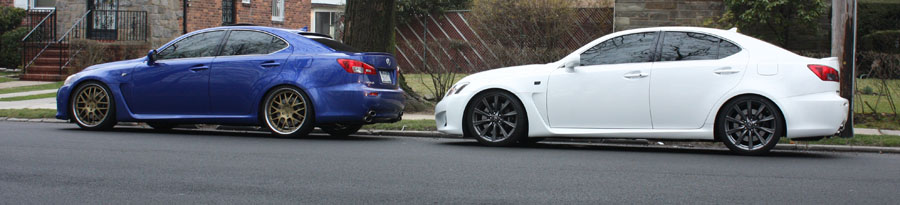

I know there are a few JIC owners besides myself. Curious to know exactly where you have your stiffness rating set on. Haven't played around with it too much but was recently driving them full stiff (15 clicks) on the front & rear. Was riding like that for a while, but it got to be unbearable after a while. Right now I have them set on 11 clicks on the rear and 14 clicks up front. I need to be that stiff up front I think because otherwise my wheel goes up into the fender lining on dips and stuff. Chime in. Another question, does the stiffness have to be the same front and rear? Or lets say is it okay to have it stiffer up front then the rear? What is typically the correct way of setting them up?
-P.S- My cars ride height currently:

I didn't lower the rears, they are how they sat out of the box. The fronts were lowered 1/2" lower than how they sat out of the box. With that said, I don't think I have any crazy camber issues, atleast at first glance. Your ride looks great!
