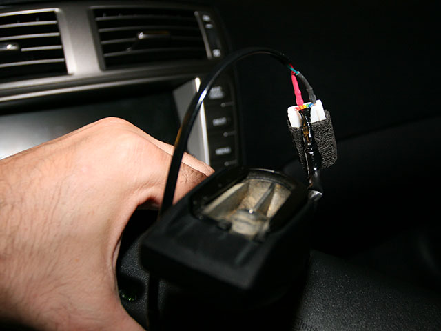

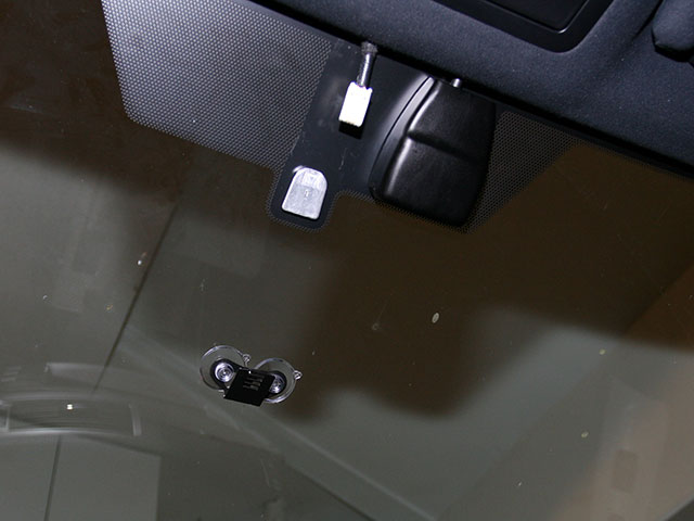

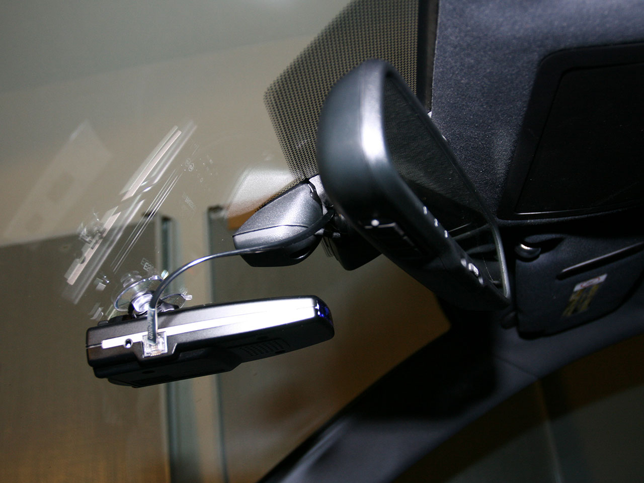

Hi,
I integrated my Passport 9500xi using a power cord from “Stealth Cords”, this is a very short cable with a RJ11 port at one end and loose wires at the other; granted for $15 it is outrageously expensive, as they must be for less than $1 in parts, but it does make integrating a radar detector a very simple job.
  • Remove the rear view mirror (there is one torx screw)
  • Unplug the connector
  • Plug in the Stealth Cord in the mirror’s connector (on the wire side) (Black/Ground to Light Blue on the edge and Red/Power to the Orange on the other side)
  • Tape it all together with a some black electric tape
  • Put the mirror back
  • Enjoy
This is a 10-20 min job depending how handy you are with electrical tape !

I don't know how it is in CA, but in FL it gets hot enough to sometimes make the suction cups fall off of my windshield.
If you have enough slack you might want to wrap the wire once around the mirror so that if the radar detector falls off it doesn't damage any of your wiring.

That's funny, I did the same on my previous car a GS450h:
But with the IS, there is no room up there, and also the Passport 9500xi has GPS capabilities so it need to "see" the sky.

I got the 8", it is just enough for my install where the Radar detector is just under the rear view mirror.
