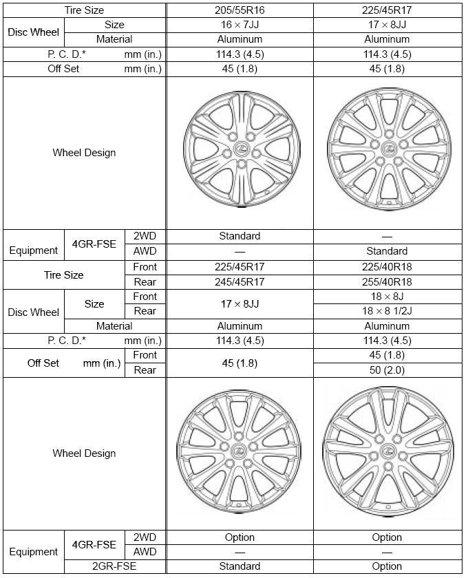

Originally Posted by marlu
Question! lobuxracer, you don't happen to have the same information sheet for the stock IS350 18" wheel?
Thanks in advance.
Like this? Here you go...

Lobuxracer, Thanks that was exactly what i wanted.
