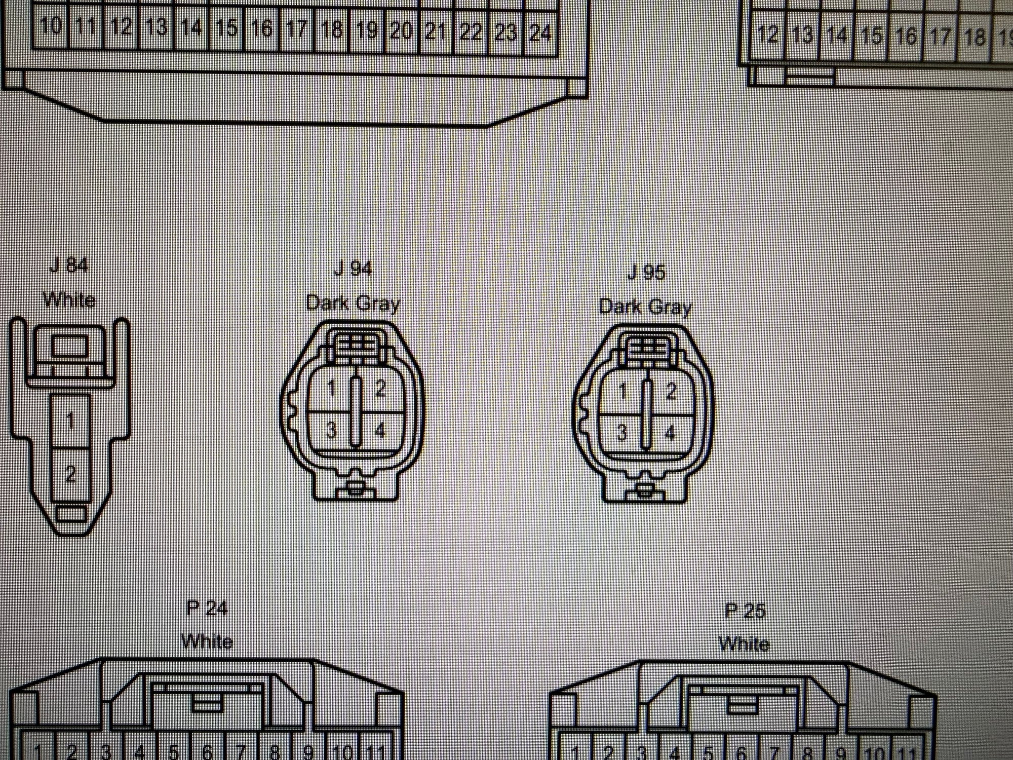

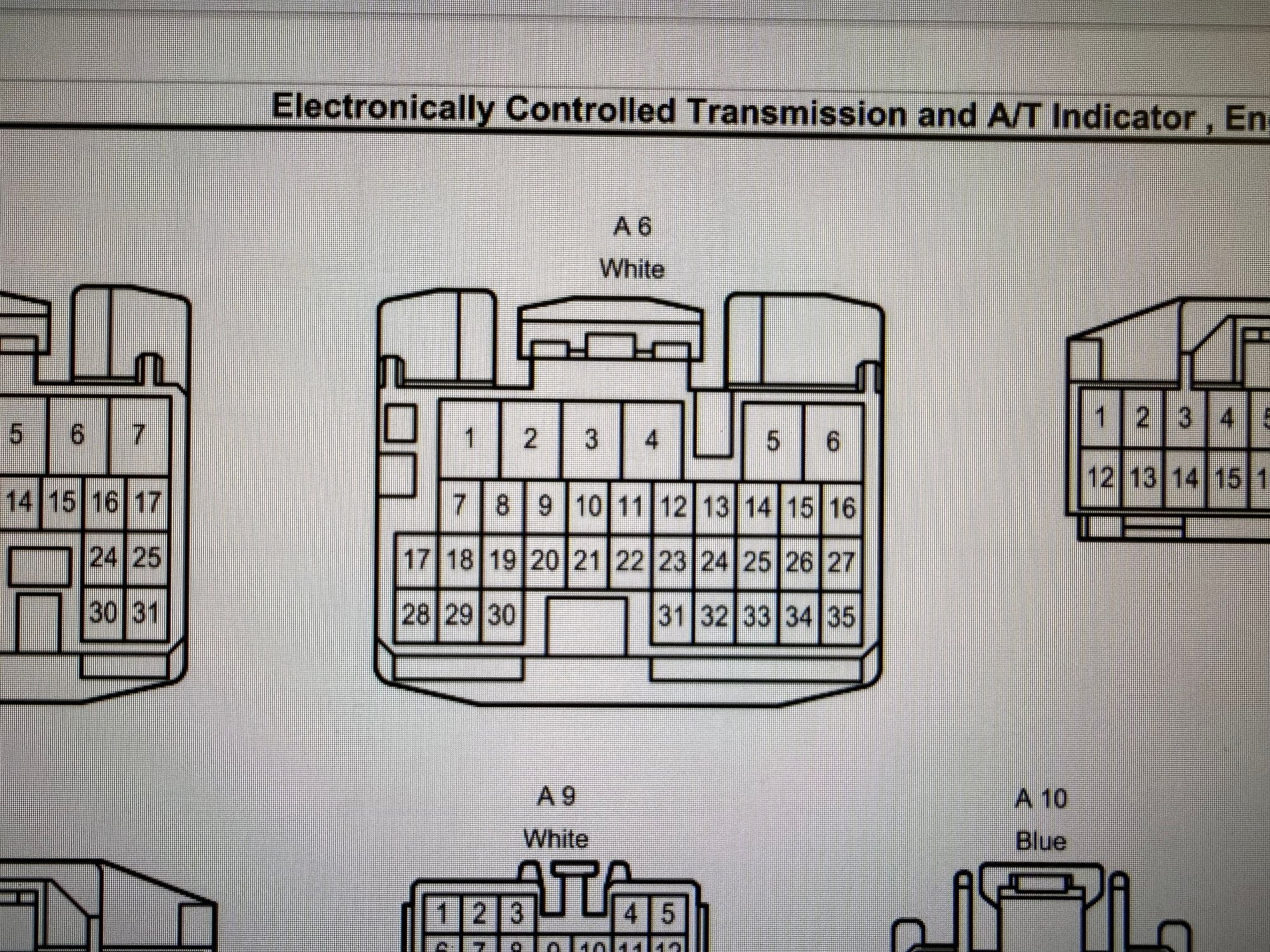

Yeah, you just tested the downstream sensors. Obviously they tested OK since they are new, sorry I didn't realize you already replaced them. Next step would be to test the harness. Unplug A6 connector from the ECU and check for short between terminals 1 and 3 of each of the O2 connectors (J94 and J95), and do a continuity test between each end of each wire (O2 connectors to the corresponding terminals on the A6 ECU connector)

I appreciate your patience in explaining this. I'm tracking that i need to test 1 and 3 of both bank 1 and bank 2 that are inside of the car, that makes sense. But, is the diagram saying that (for bank 1) that the wires that are attached to 1 and 3 at the O2 connection in the car end at terminals 4 and 26 of the ECU connector? and that 1 and 3 (on bank 2) end at terminals 3 and 27?
Correct, the reason you have to disconnect the A6 connector from the ECU is to isolate it and just check the harness or wires for short. Your meter should show OL or open when checking resistance between 1 and 3. Also test that neither wires are shorted to 4, Have you also looked into into your canister pump assembly? It looks like it's part of the system as well.
