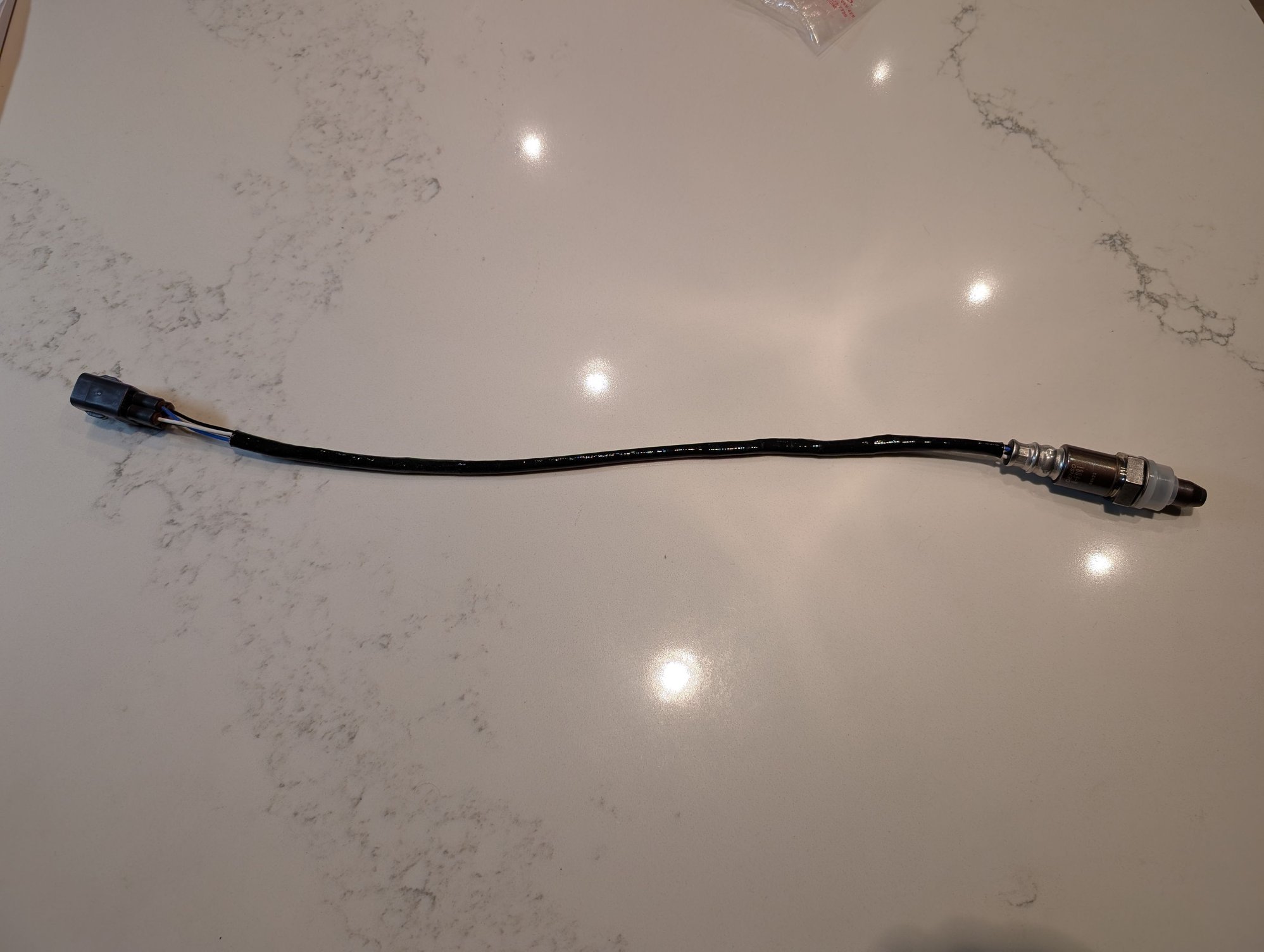

Happy to report no CEL and no smell of any kind whatsoever from the tail pipes after installing PPE headers with Gesi 400cpi cats. I have factory tune, no defoulers and factory exhaust after the headers.
Surprisingly the 400cpi cats still have no markings on them either. You can however see the tighter cell spacing compared to the 200cpi cats I was shipped originally:
200cpi
400cpi
I extended the O2 sensors using extra wire and fiberglass tubing scavenged from downstream O2 sensors spliced using brass open barrel crimps and double walled heat shrink. I know it's a very expensive piece of wire but I didn't want to use dissimilar wire since learning about how sensitive the signal is on these.
I've put on about 300km of mixed city and freeway driving over a few days since the installation and not having any issues with KCLV. I did a bunch of logging before and after installation too that I'm saving for possible future reference if anyone is interested in seeing.
