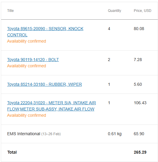

Are you guys buying the genuine ones through lexus for $140ish "cough"
or sourcing elsewhere for the new MAF sensors?
Amayama. The knock sensor price made everything worth it.
