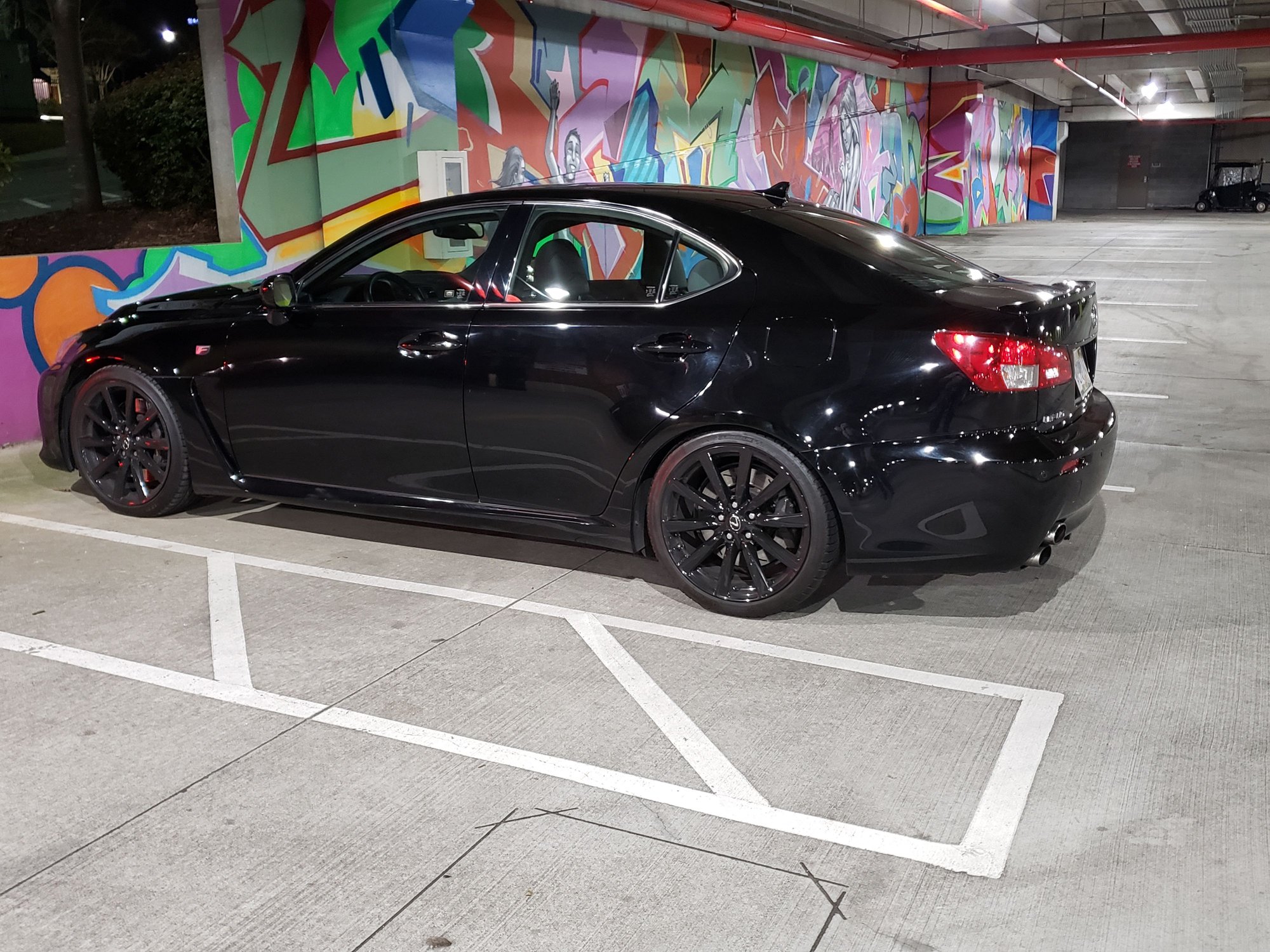

Old Apr 10, 2024 | 11:25 PM
lobuxracer's Avatar
lobuxracer
Tech Resource
Joined: Jul 2006
Posts: 23,081
Likes: 4,751
From: Georgia
These are from my initial installation. Pretty sure I had 245/35/19s on the front and 275/30/19s on the rear here.
This is a little more recent, but still not the latest. Definitely 255/35/19s and 275/35/19s in this shot.
I am now on Ohlins DFVs from Figs. The stance is the same but the ride height is slightly different so the fender gaps are not exactly as this picture shows.
