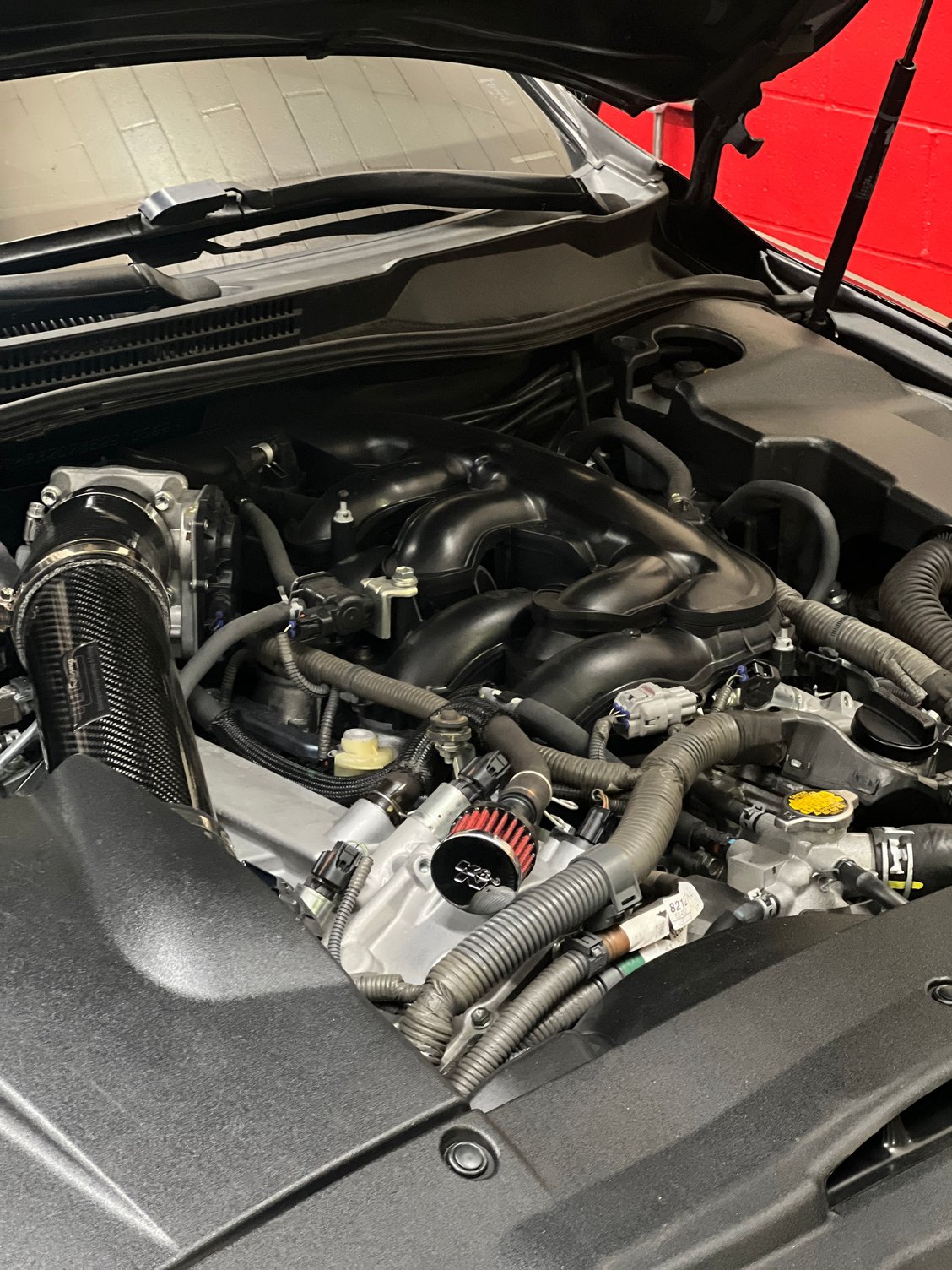

Default Starting the year off right
Engine bay looking clean

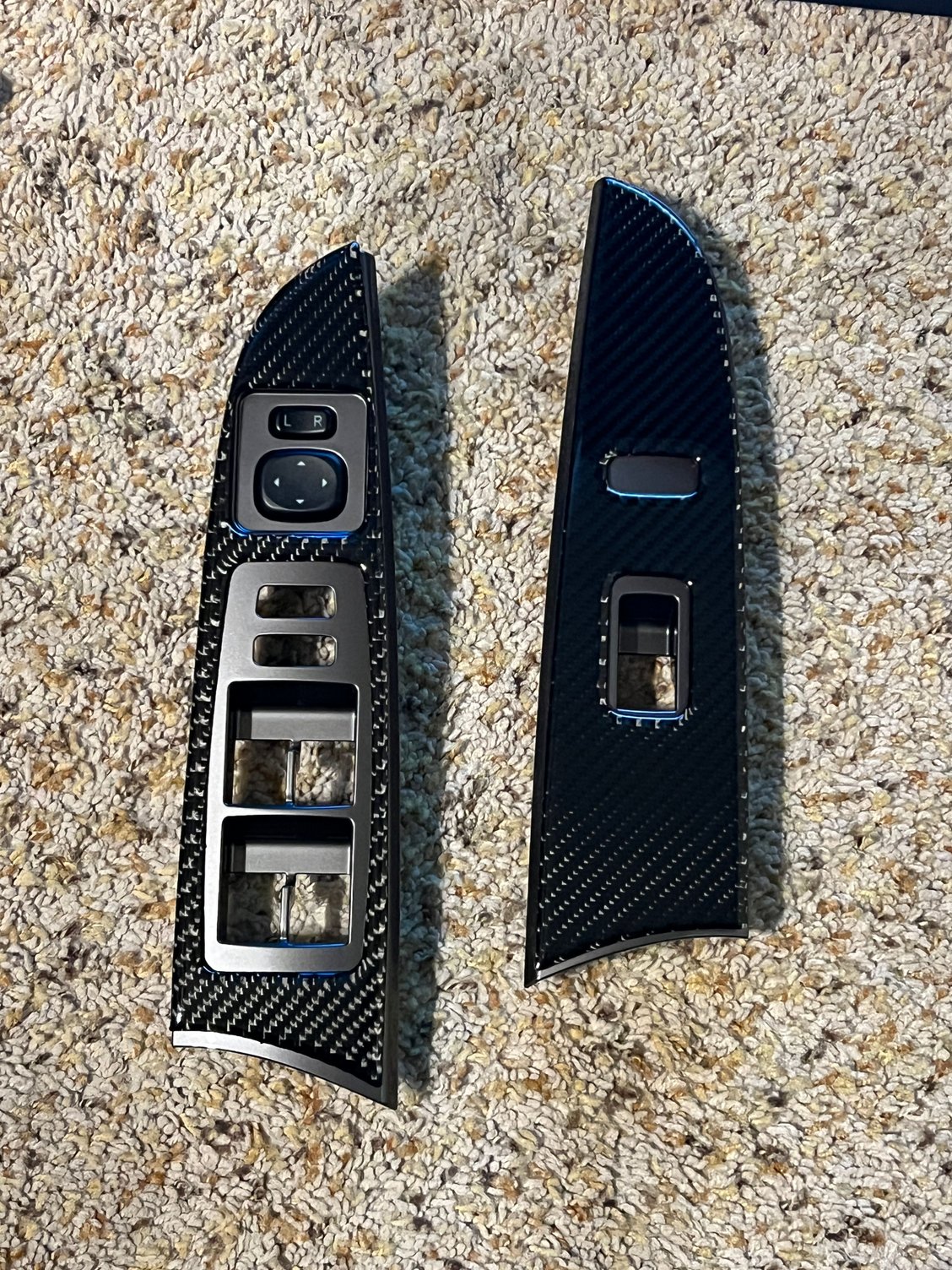

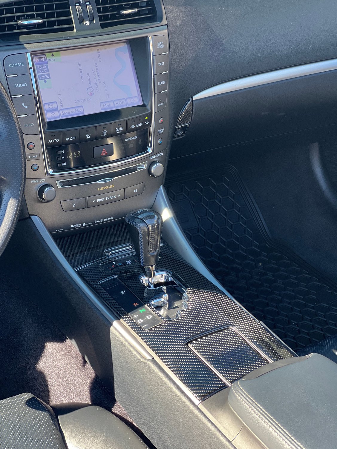

Default AliExpress Real Carbon Fiber Overlay
I seen a Facebook post in the IS250/350/F group of someone putting the Aliexpress overlays on their ISF and it looked really good. He did a lot more attention to detail than I did but for $50 plus shipping for a whole kit why not. Most things I needed up taking off because it was too tacky and did not stick well. Only one I kept was the center console. I will get real custom carbon fiber in the future but far now I just wanted to experiment the look.
Before
After
Unfortunately, sedan overlay trims do not fit the convertible trim.
Not too shabby
(02/2024)

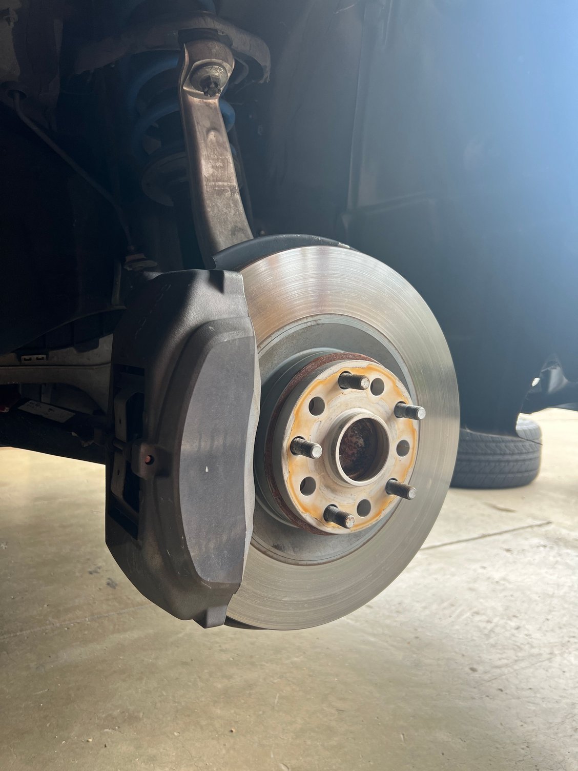

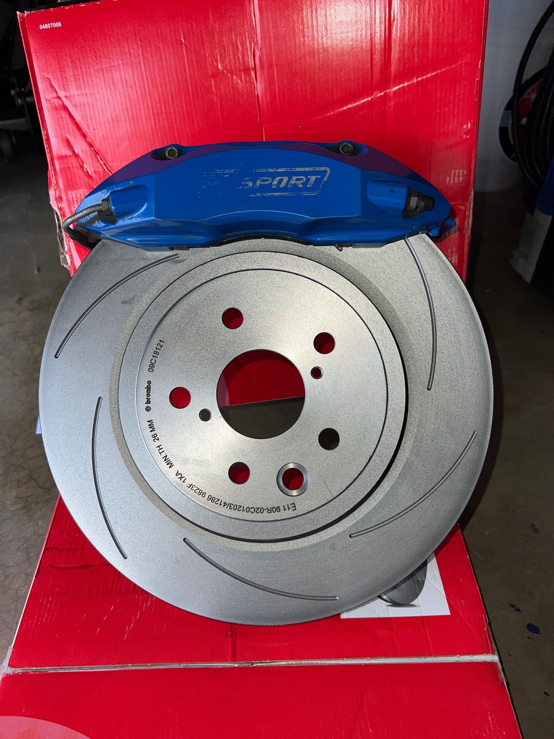

Default OEM RCF Brembo 6 POT Front Calipers & F Sport StopTech 4 POT Rear Calipers
Hmmm what do we have here???? I got a great deal on the RCF Front Calipers and Rotors from a friend. Only $600 for the whole set with brand new rotors and pads. I also happen to find another great deal on the RARE F Sport 4 Piston Rear BBK with pads. I believe I paid about $400 shipped off Marketplace. The biggest issue with the F Sport BBC is finding pads and rotors since most dealers don't have them and say they are discontinued. In order to even get replacement rotors and pads, you will have to contact StopTech directly and order from them. I did not want to do that so I decided to order OEM Brembo RCF Rear Rotors and too if they would fit. During my mock up, they seem to work well hand in hand. As of September 2024, I have yet to put any of them on my car due to not having wheels that can clear them. The OEM F Sport wheels CAN clear the F Sport BBK front and rear but not the RCF Calipers. Even with spacers they are a no go. The min spec of clearing them has to be a 19" wheel, for 18" wheel you will need at least a 9.5 wide. I will update you guys in the future whenever I do mount them. I will also post a photo of the F Sport BBK on OEM F Sport 18" Wheels.
RCF 6 POT Front Calipers and F Sport 4 POT Rear Calipers
Here we have a mock up of the F Sport 4 POT Calipers on OEM RCF Rear Rotors...so far so good.
RCF Front 6 POT Calipers with Rotors "test fit" on the front 18 x 8 wheels. No go
RCF Front 6 POT Calipers with Rotors "test fit" on the rear 18 x 8.5 wheels. 90% clearance but still gets stuck/grinds at one of the sports on the wheel
Mock up on how it will look like
(03/2024)

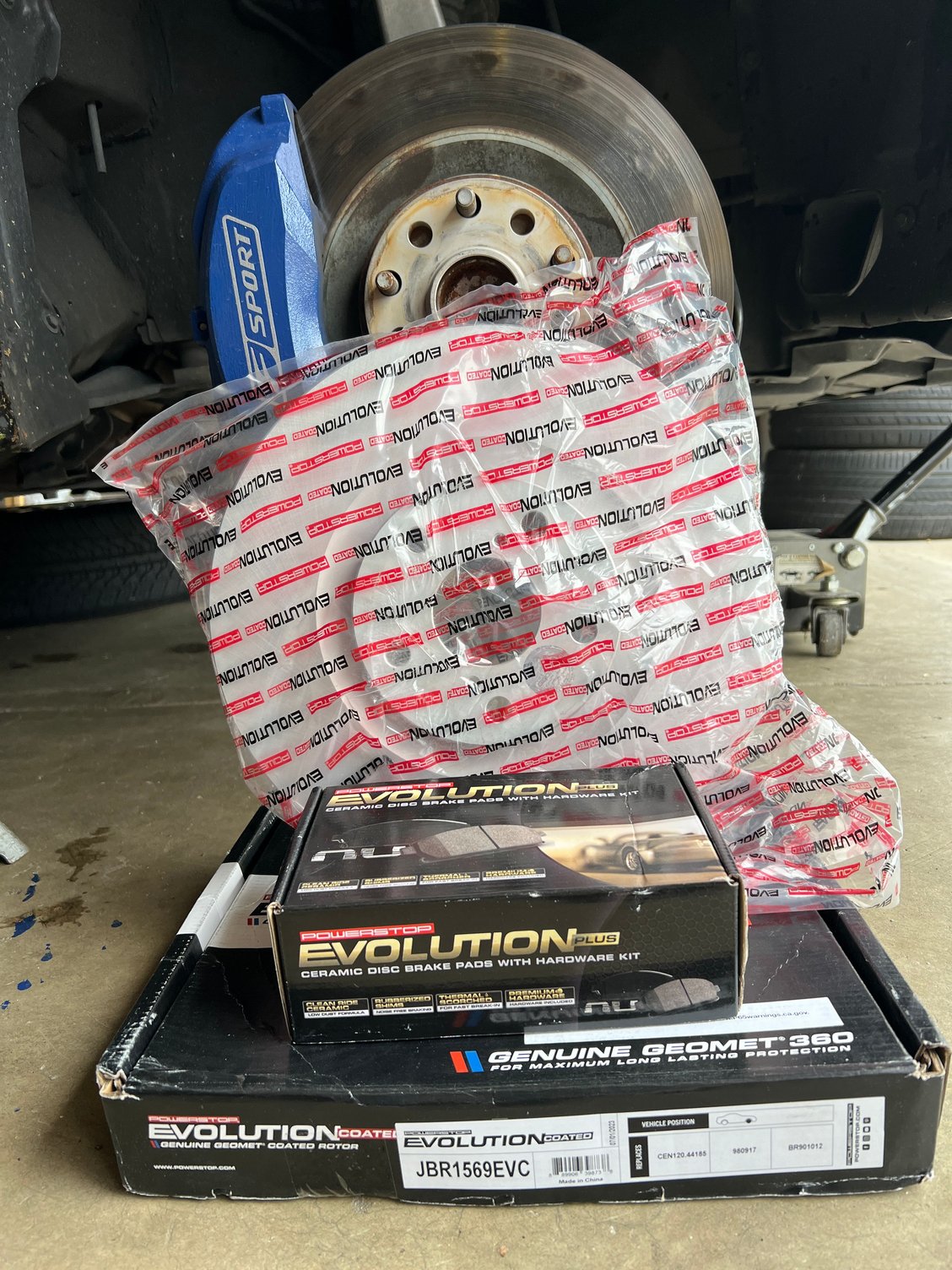

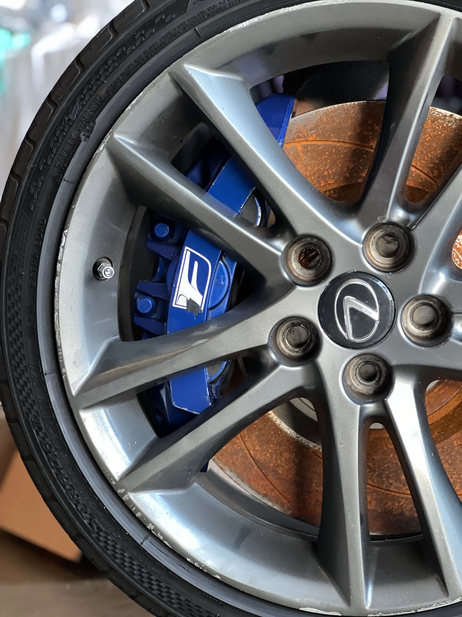

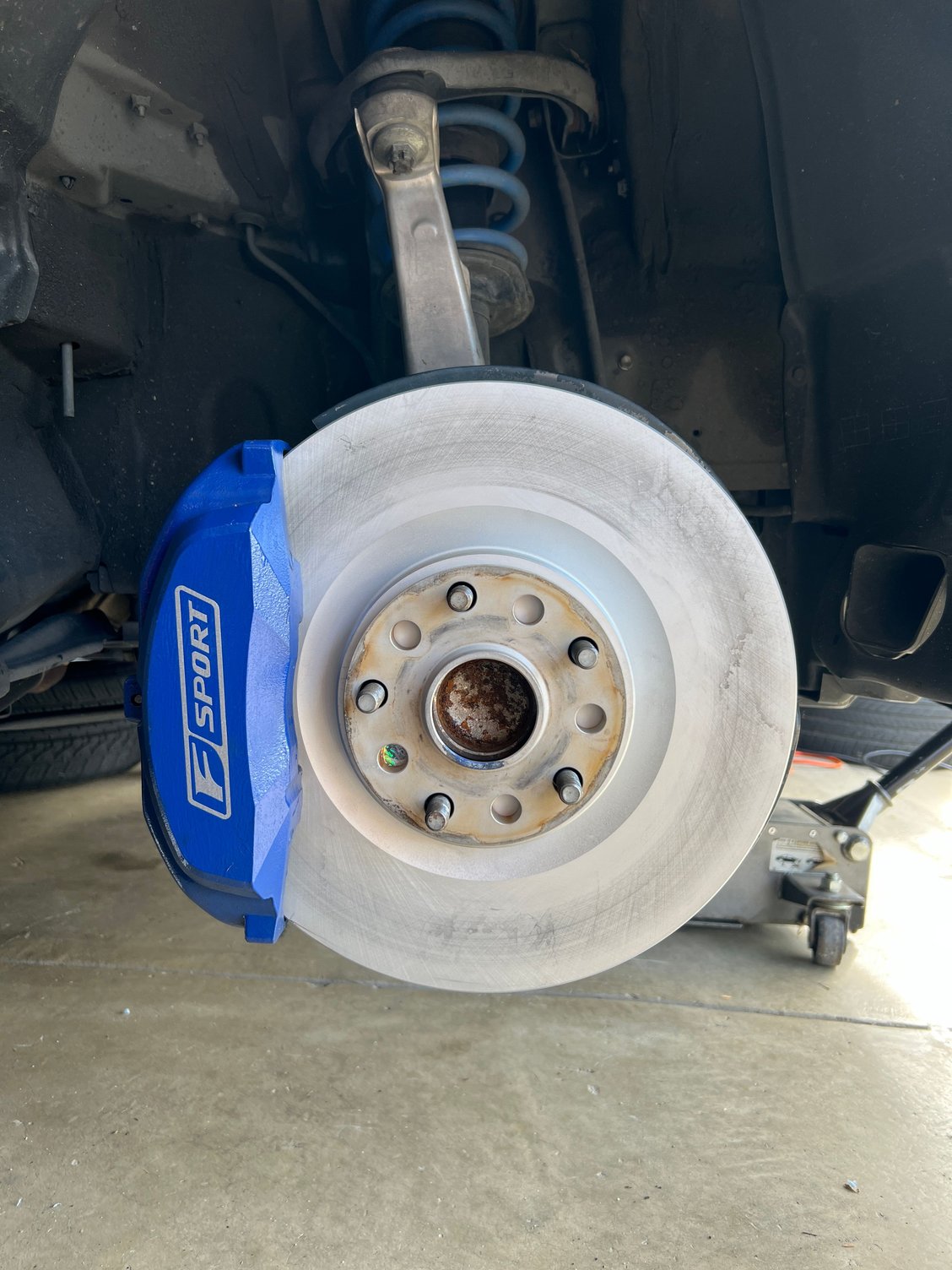

Default Powerstop EVOLUTION Plus Coated Rotors and Ceramic Pads - KOE6353
After that huge fail of trying to get the RCF Calipers mounted I still needed new brakes. My philosophy is always upgrade to the part you want when replacing parts. That is always a good excuse to buy new aftermarket parts. For now, I went with these Power Stop coated rotors and pads and I love them. Had them on for about 9,000 miles and still loving them. Best part is the coating so my rotors never rust unlike some brands that rust instantly or just the rotor hats coated.
Powerstop Rotors and Pads
Seeeshhhh, been doing a lot of hard braking.
All good now
(03/2024)
