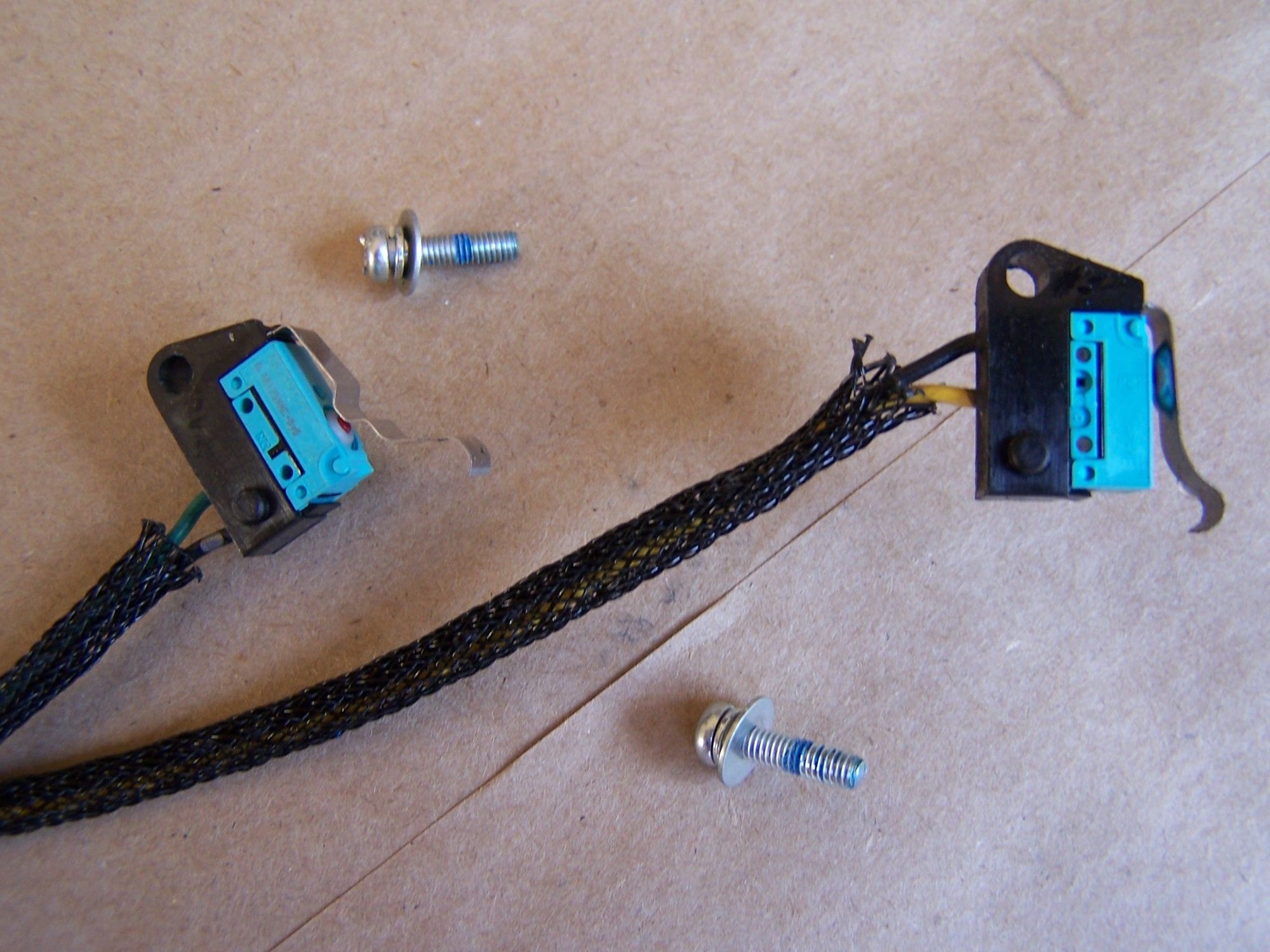

hello kkel, my lexus is250c was just hit in the front driver wheel/fender/bumper, the day after i put the top down and it would not come back up. first time i have ever had the top fail on me after thousands of cycles and 193k miles there is very little support to the roof on our cars, the door jam does not go up to the roof for extra support. each roof panel has multiple sensors and motors inside of them, the roof flexing even a small amount a qtr of a inch or less will cause one or more of the 37 sensors or 15motors to easily break. i would show them how the smallest movement of the roof can pinch and crush the metal tab into the sensors, in the picture below is just one of many sensors that can be pinched from flex in the body. hope this helps. if you end up getting your issue fixed please post in the thread i created on all known issues/fixes for problems with is250c/350c convertible hardtop only. good luck

if you could send a picture of the gap caused by the accident, i could maybe find the diagram of sensors in that exact location for you
