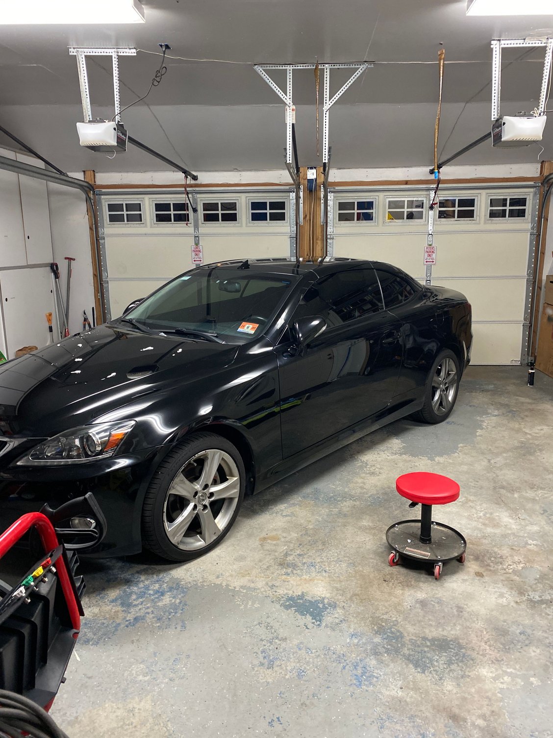

Just picked up this 2012 is250C from a local seller. Has 106k on it- loads of service records from the same local dealer I service my other Lexus Sedans at. I have a few questions/concerns that maybe y’all can help with.
navigation does not have a GPS signal. Couldn’t get the center console out today (where shift **** is) so I figured I would try again tomorrow. I would like to check to see if the Antenna is plugged into the back of the unit. I read that some airbag recall requires the head unit to be removed and most times techs forget to plug the antenna back in. If the antenna is plugged in.. then what? Any good threads on removing the unit.. i have been watching a dated YouTube video on how to for the sedan models.
car was missing the wind deflector- is this worth buying?
100k service was completed at dealer back in November of 2019- what’s next after this? Should I jump on this?
center consoled area on passenger side where the silver trim meats plastic area has some horrible gauges in it. Can this panel be replaced or does it require a whole new center console?
are the the headlights adaptive on this model? I had a is350 sedan back in the day and the headlights were adaptive and miss that feature lol
gauge cluster area shows outside temperature but is way off. Why? could this be?
car has been sitting for 3 months only started every few days. Anything I should be worried about?
Other then that I’m very pleased. I got a great deal IMO. Wheels are in bad shape not sure what I’ll do with them. Any suggestions?
I included a picture. Please ignore the polish I left on the hood before taking the picture lol.
