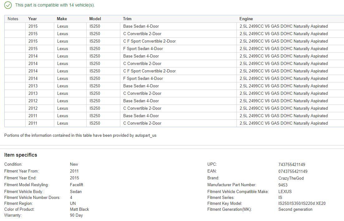

Thanks for the information regarding the 2010 to 2012 ISC having a unique grill... Is the difference in the width? There are a couple ebay listings that show an aftermarket mesh grill (one gray, one black) that say fit a 2011 to 2015 IS250C but not an IS350C. I bought a fiberglass one from Bonanza that I think I will return because it does not appear to be very strong and also has no mounting holes...

Based on what I've seen and how eBay's listing process works, I suspect there is simply an error in the listing.
That grill would fit a 2011-2013 IS Sedan (F-Sport or non) or a 2013-2015 IS C F-Sport. I recently posted about this in another thread:
Originally Posted by Jeff Lange
For the IS C there are two bumpers that were used.
Type A: 2010-2012 and 2013-2015 without F-Sport used an IS C unique bumper and grille.
Type B: 2013-2015 IS C F-Sport models used the same bumper and grille as the 2011-2013 IS F-Sport sedan.
For type A bumpers, there are two grille options, the original and the Lexus USA port/dealer "F-Sport" non-factory accessory grille shown here. The part number for the accessory grille is PTR54-53100, and will only fit vehicle without pre-collision. Note that this grille is a series of "F" logos and not the typical zig-zag pattern seen on factory F-Sport grilles.
For type B bumpers, they already came with the F-Sport grille, but if you wanted to change the grille for some reason, the only option I've seen available would be to go to the non F-Sport sedan grille. The part number is 53112-53180 for models without PCS and 53112-53210 for models with PCS.
