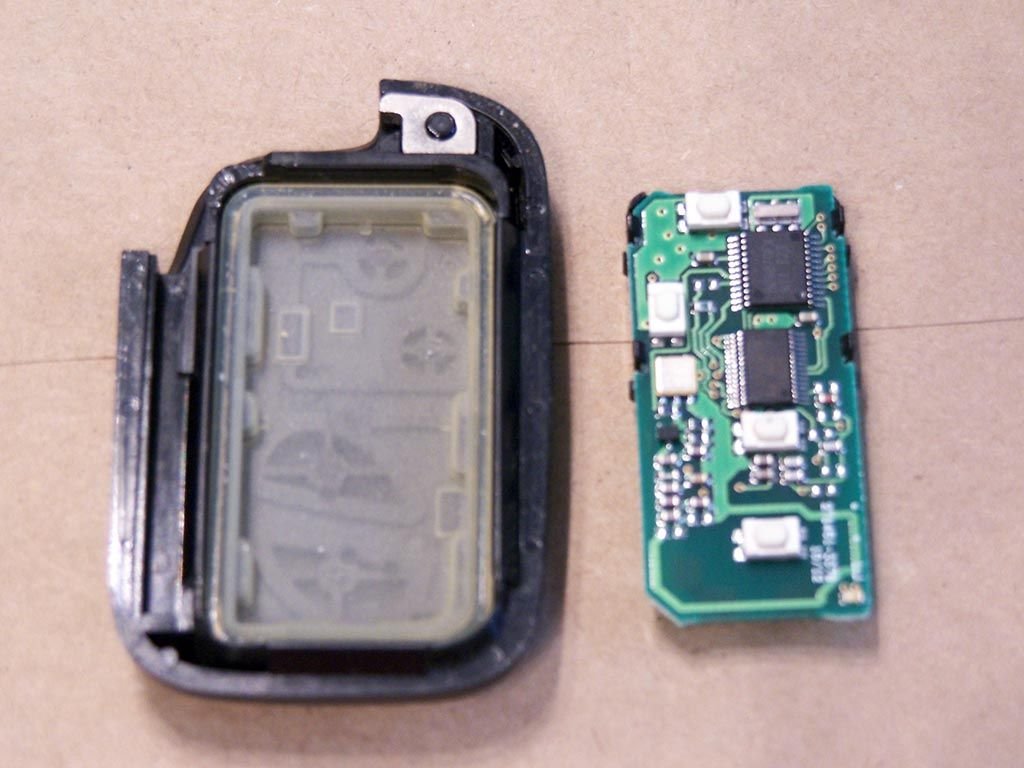

1) Start by opening the keyfob up like you did when you changed the battery, but leave the battery alone. See photo 1.

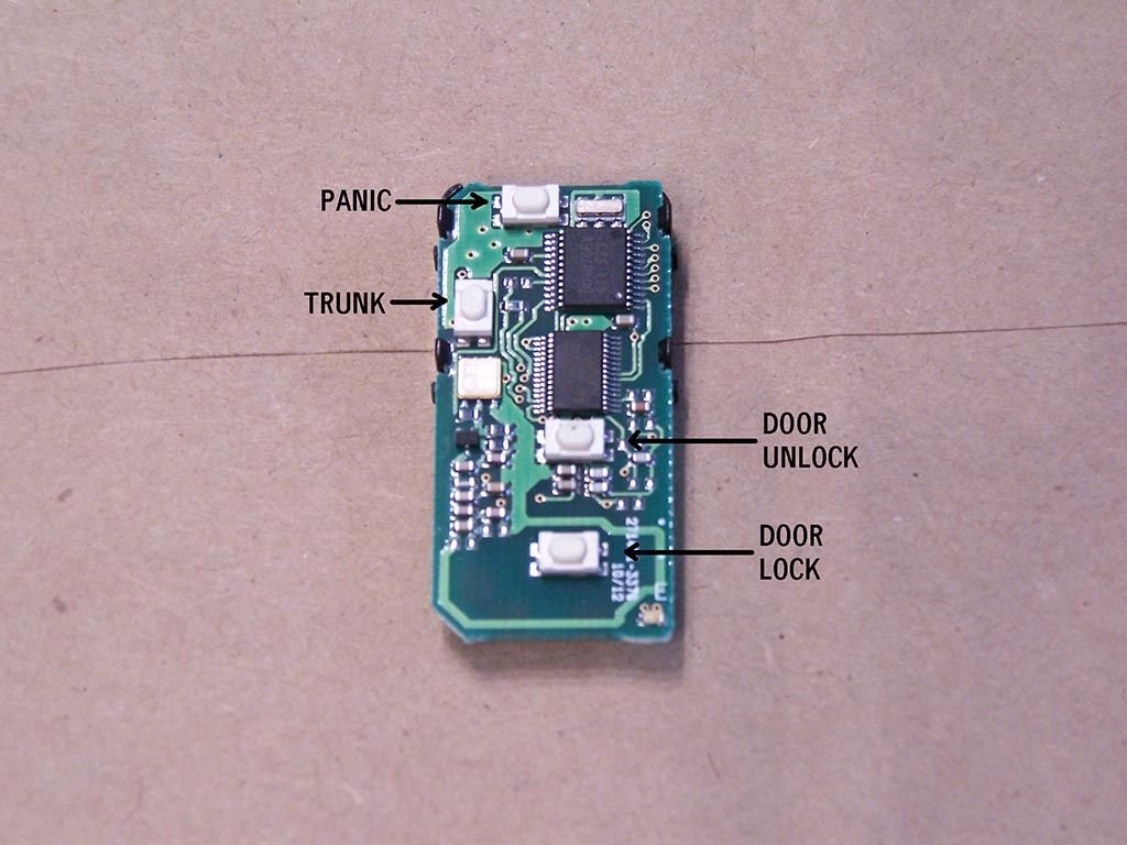

2) Pick out the small printed circuit board. Also remove the latex cup the printed circuit board mounts in. See photo 2. If there is dirt/stuff/crud in there, clean it out.

PHOTO 1
PHOTO 2
