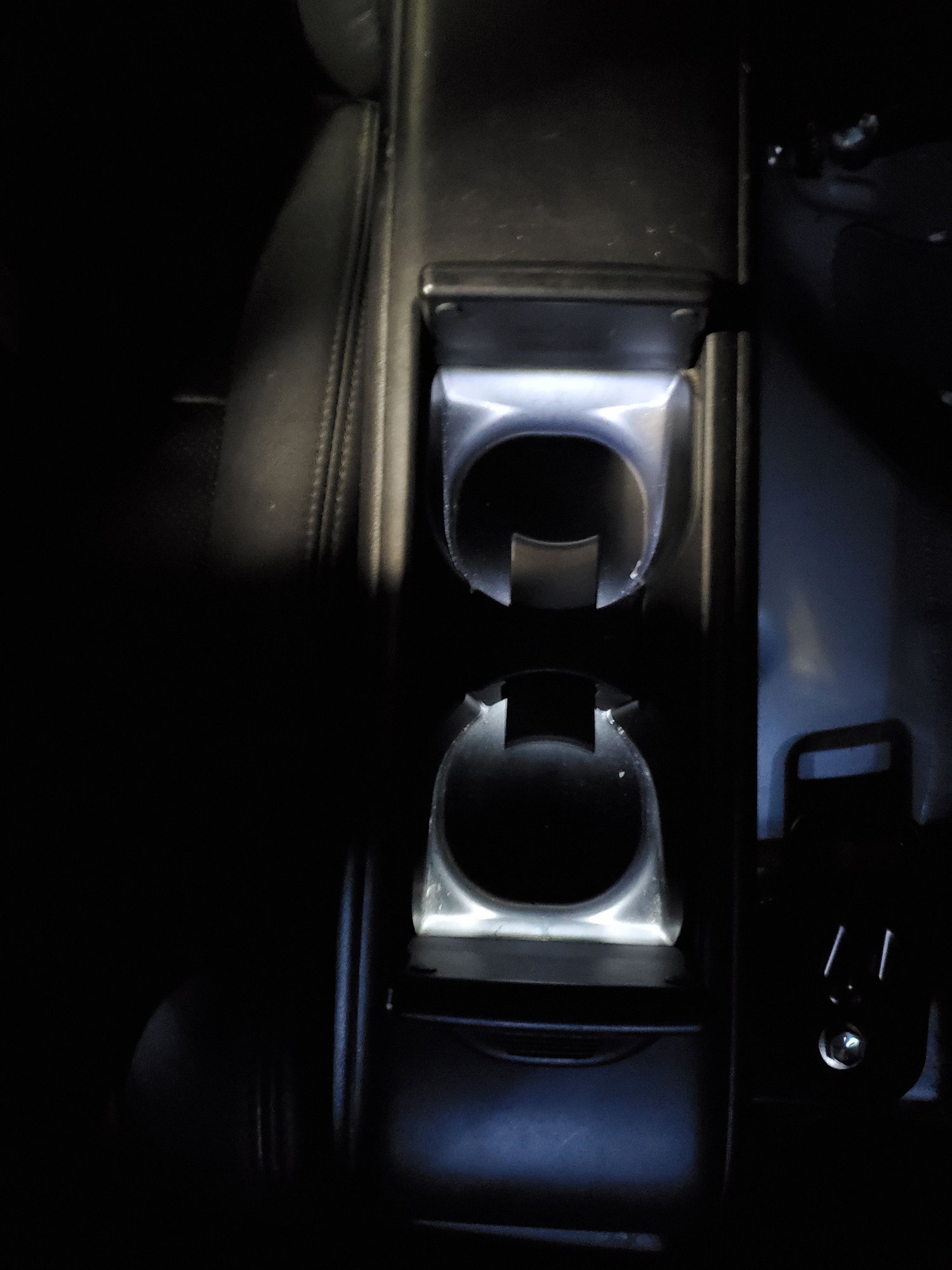

I didnt want to create a new thread, but this is what the cupholder on the rear center console looks like when you insert an LED into the middle under the plastic divider.
