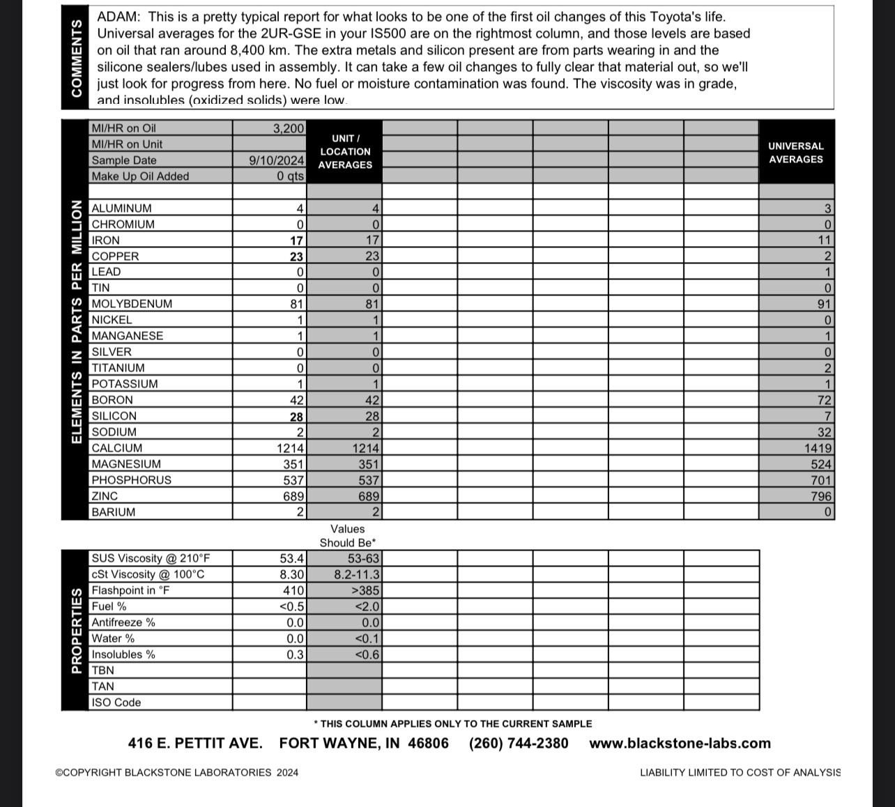

First oil change was at about 2000 miles. This analysis is after my second oil change, there's lots of silicon but everything else seems reasonable.

Food for thought, All new engines contain assembly lube along with oil. The first 1000 to 5000 mile are break in period ring to cylinder seating, bearing seating, etc... This is why the assembly lube. Also why you should change oil in first 1000 mile and then again at 5000 or 6 months. Most cars require no special break in instructions. Boat motor however are a pain in the ***. This is example for Yamaha outboard First hour: Run the engine at varying speeds, but keep it below 2,000 RPMs Second hour: Increase the speed to under 3,000 RPMs, but avoid full throttle Hours 2–10: Run the boat at three-quarters throttle or less, but occasionally increase to full throttle for brief periods. After 10 hours: Run the boat at normal operational speed After 20 hours: Bring the boat in for a service.
After the 3rd oil change you should end up with normal numbers till something goes wrong. Seeing as it is Lexus/Toyota motor that could be 300k plus miles if you treat it right.

Here is my 2nd oil change done @ 3200km. I don't have the first one as the dealer service was incompetent and did not take sample. Even though the request was made and the container left on the seat...sigh.
Also in Ontario.

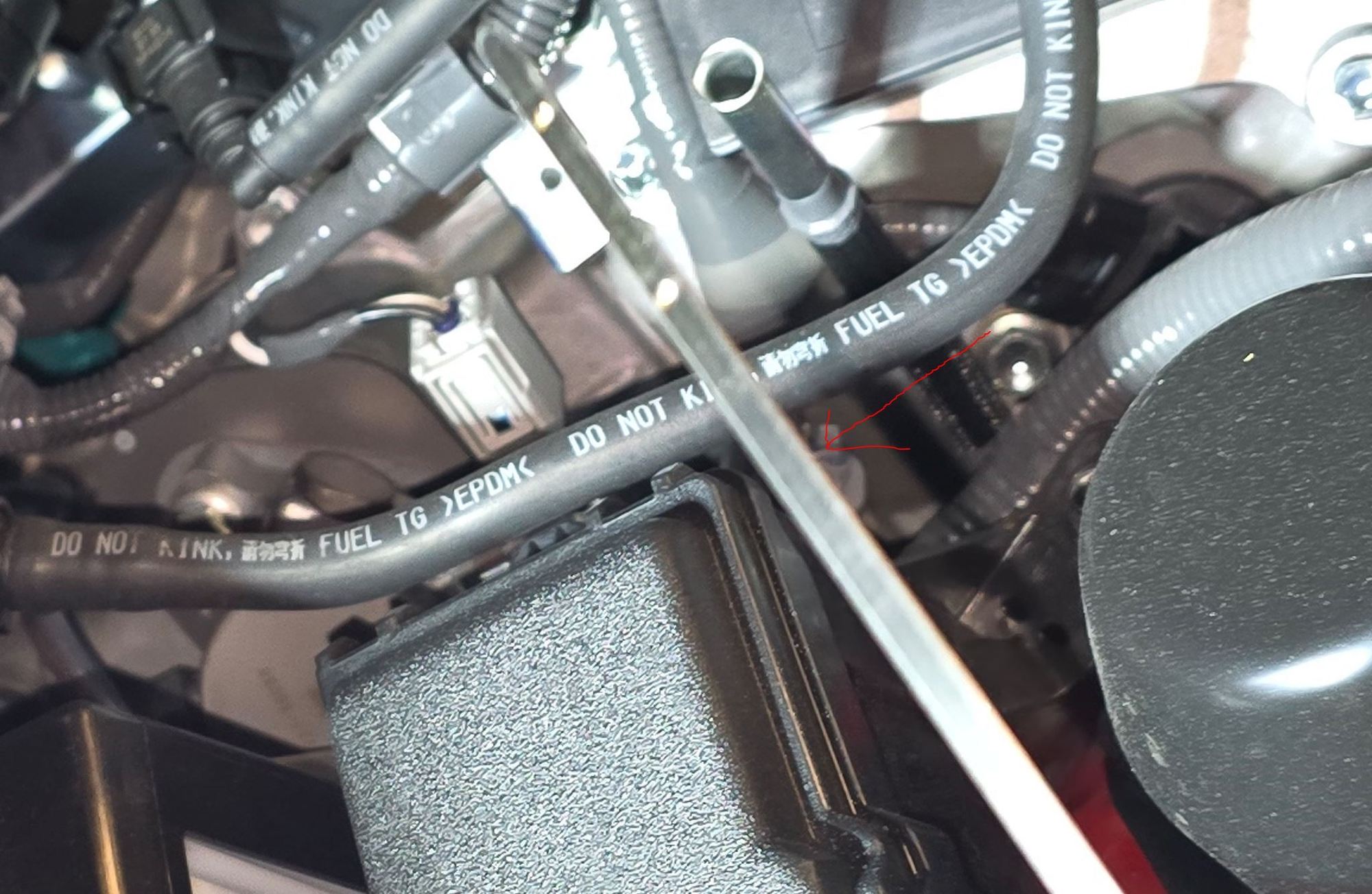

I had an oil change done at 1300 miles and have done another 1K since then. Visually, the oil on the dipstick has been clear like water every time that I checked it at 32, 1300 and 2300 miles. Was this common for you all as well? I never checked the oil in my previous cars when they were new so I'm hoping that is normal?
Also, it seems to be a bit overfilled. The picture below was taken at 2060 miles but the oil level was the same at new,1300 and 2300.
