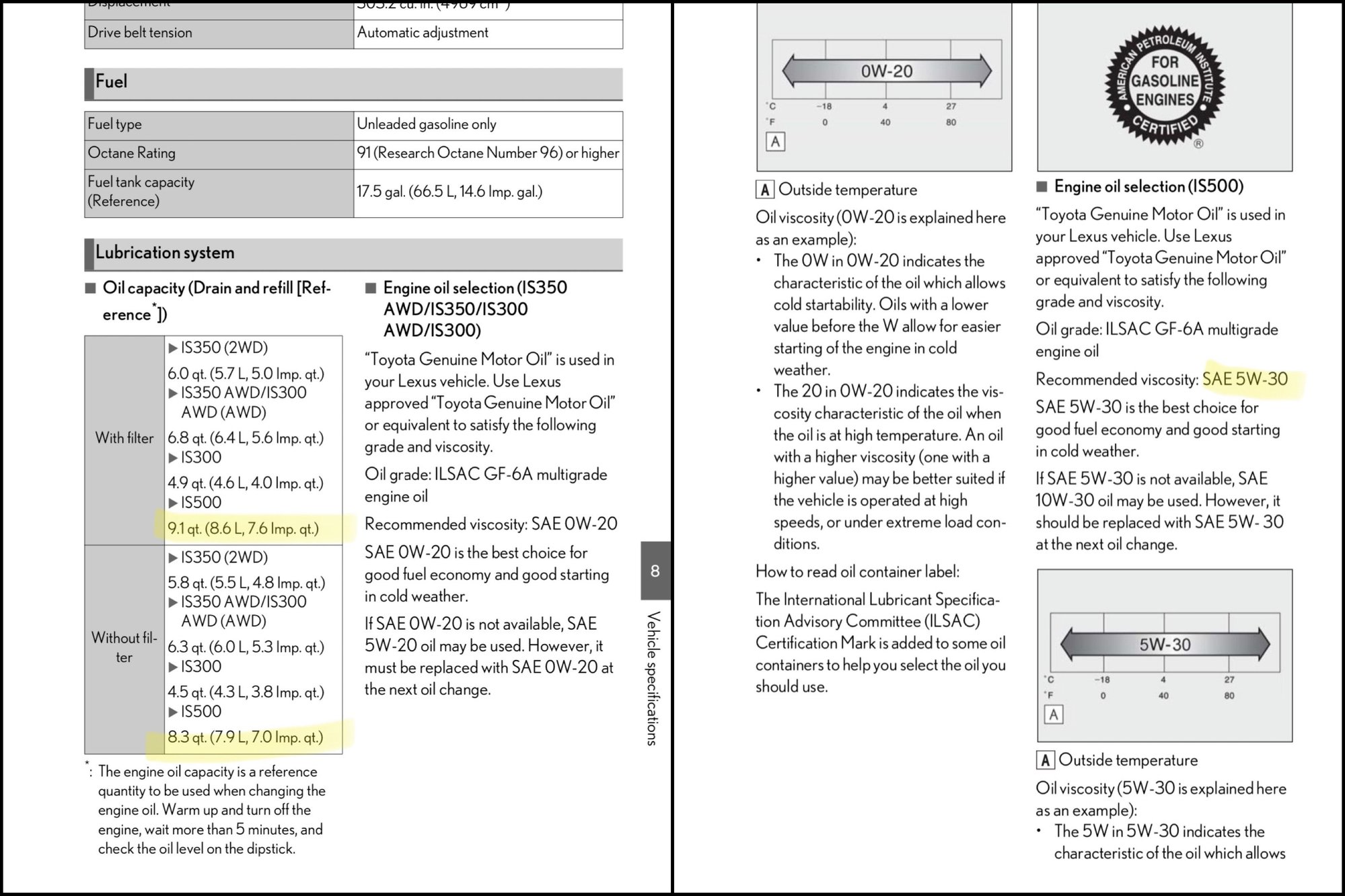

Not gonna lie, somewhat surprised our engines take 9.1L of oil

9.1 quarts, not liters!

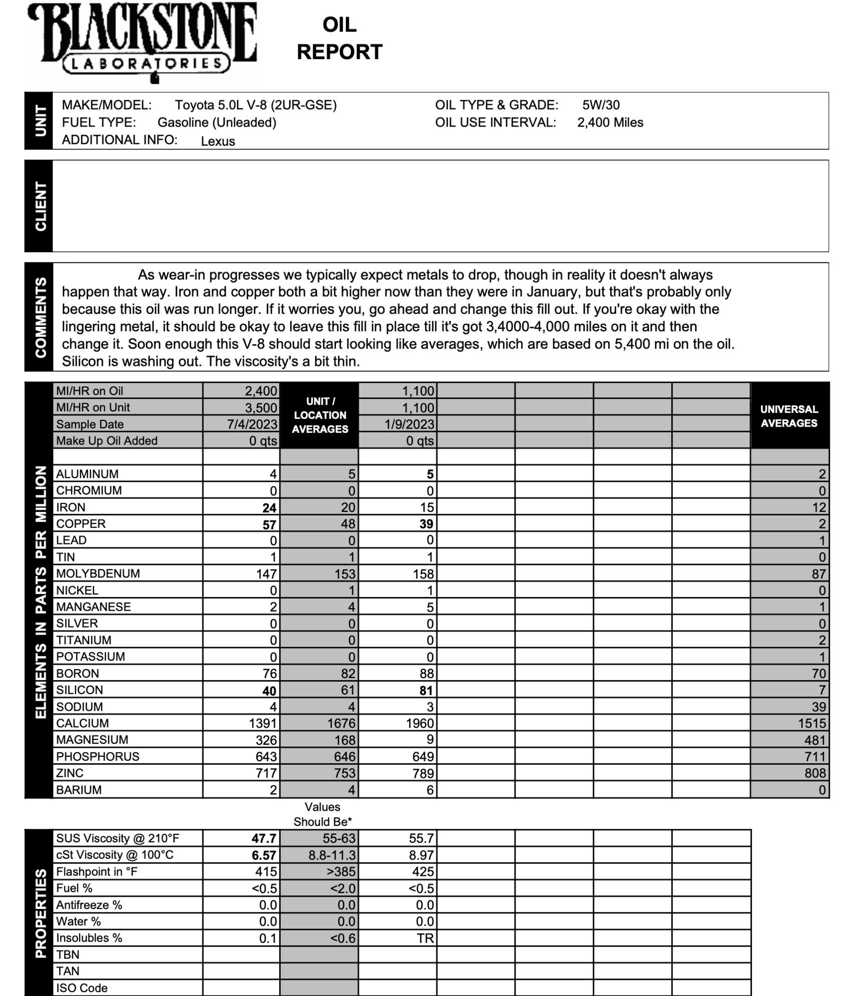

Here's the second analysis!

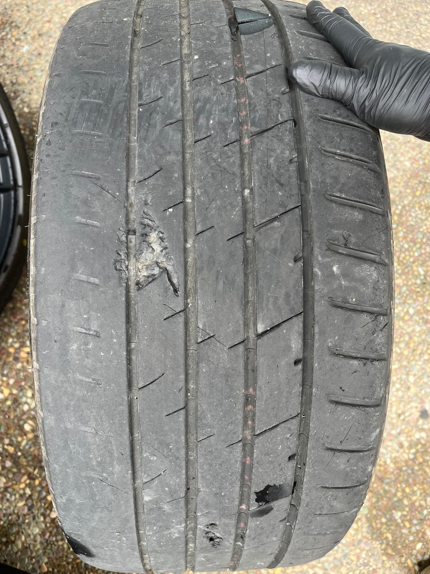

You'll notice there's not many miles but on a fairly warm 80-90F day, I spent a day with friends at an autocross/drifting event and wasted my rear set of OEM tires in a day. It's probably that level of use, where I'm pushing the car at high rpms, that appears to have taken the oil beyond it's limits. With this data I can at least do a similar test in the future with synthetic oil to see if the results differ...although I will need some funding assistance on rear tires to do that...lol!

Welp. If I wasn't already convinced to provide my own oil, you've convinced me now.
In all seriousness, I was going to do so anyway, but thanks for the helpful information as usual.

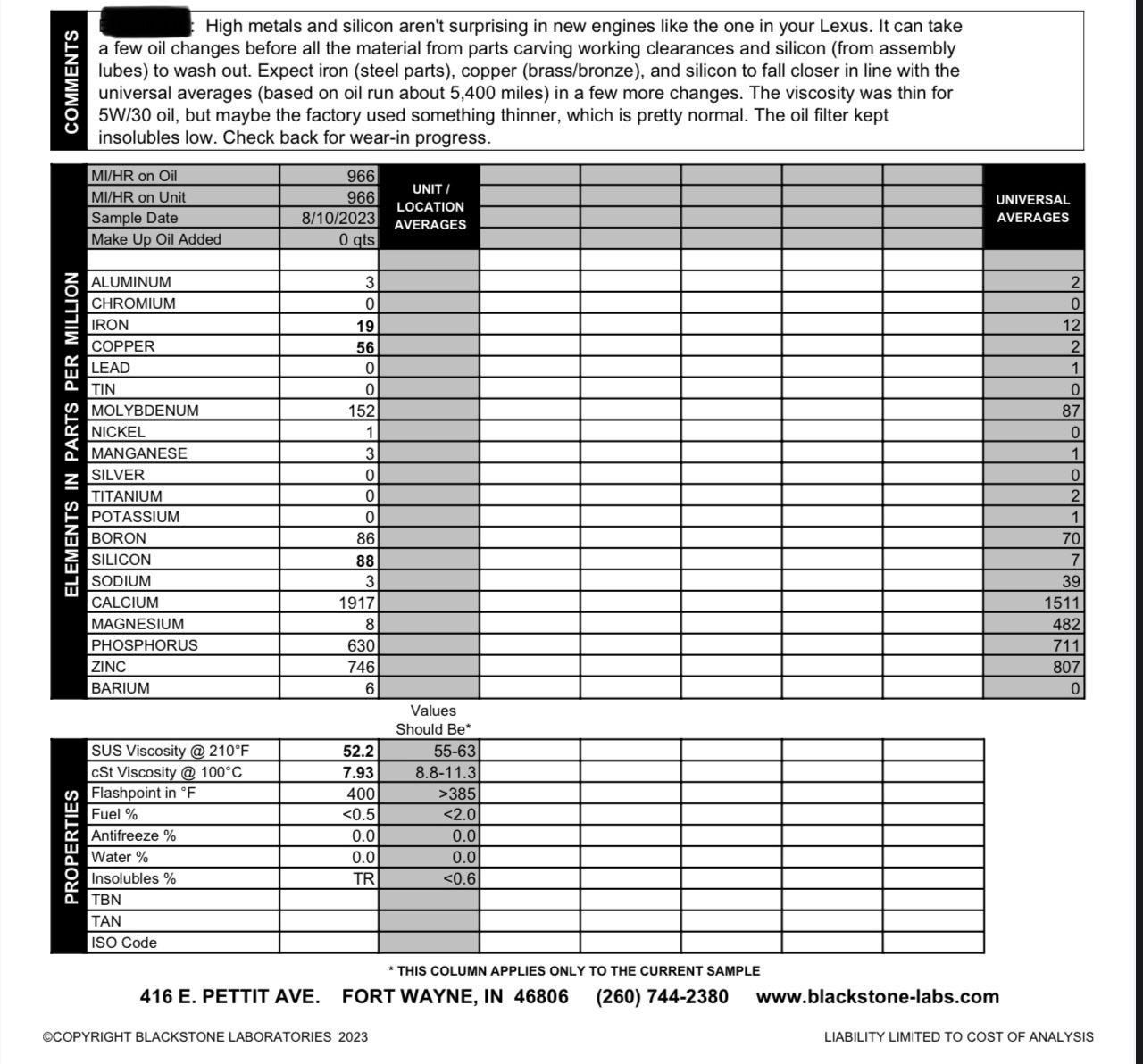

Got my results back. Changed early at 960 miles. Surprised to see the viscosity thinner considering how gentle the break in miles were.

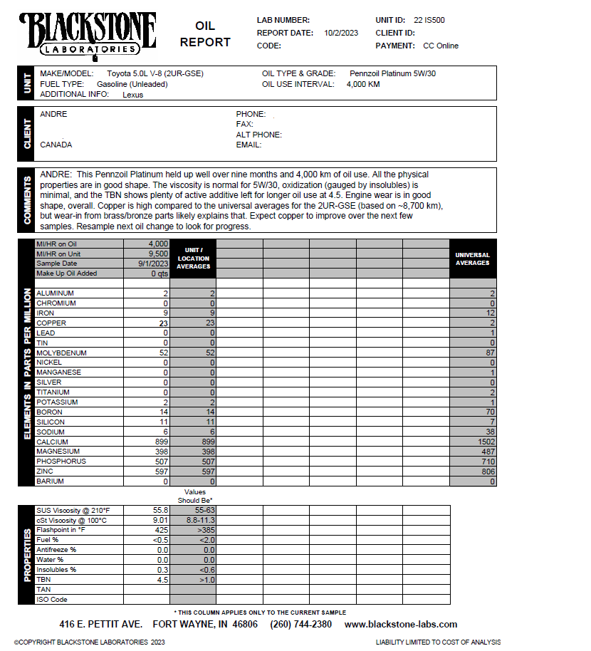

Finally got my report, looks like our engine do have high copper content
